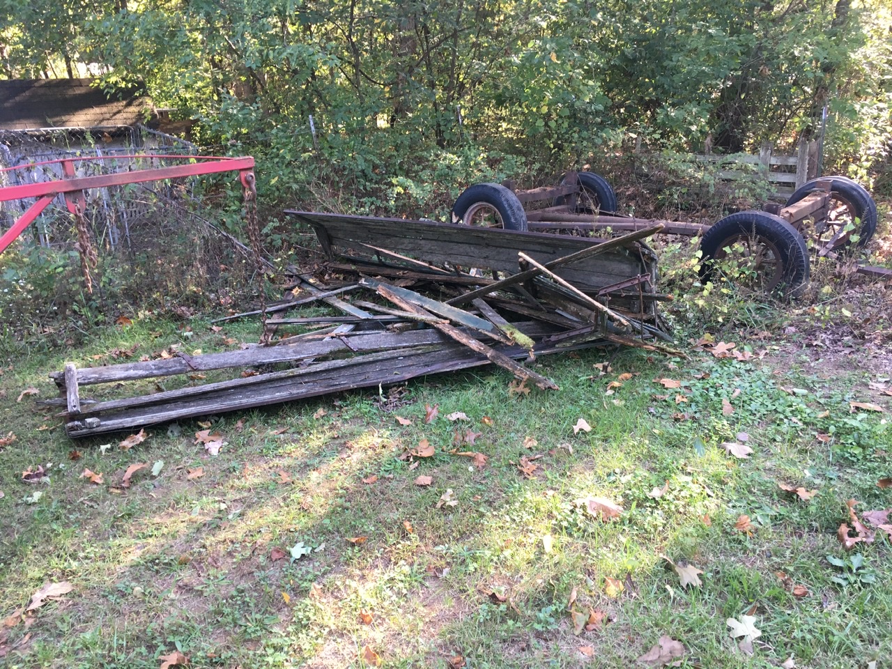

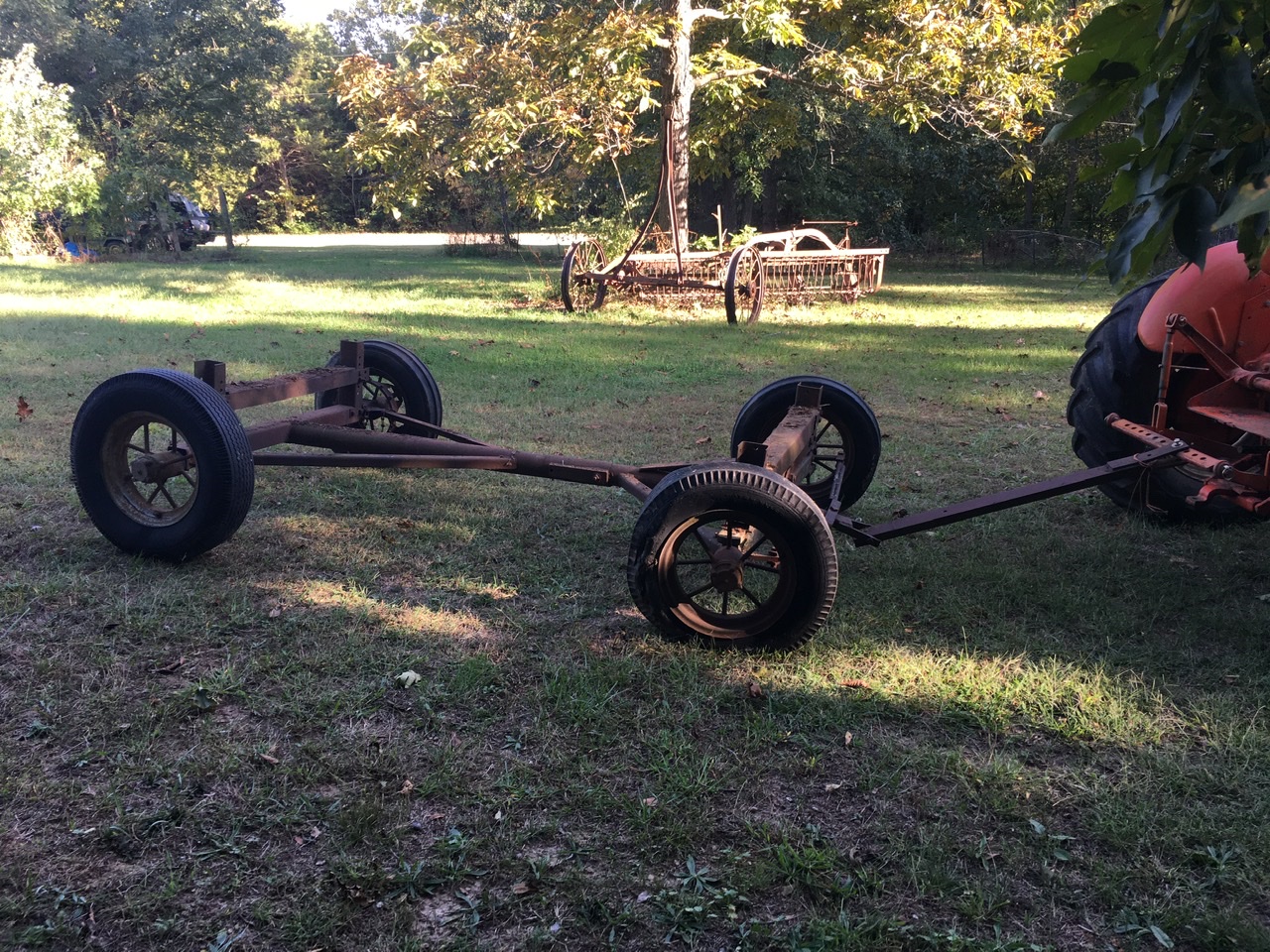

The other day I decided to tear down this old Flare Wagon I had for over 20 years that was rotting away and I’m planning on re-storing it to a Allis Chalmers Wagon to match my Tractor. This is what I’ve done this week.

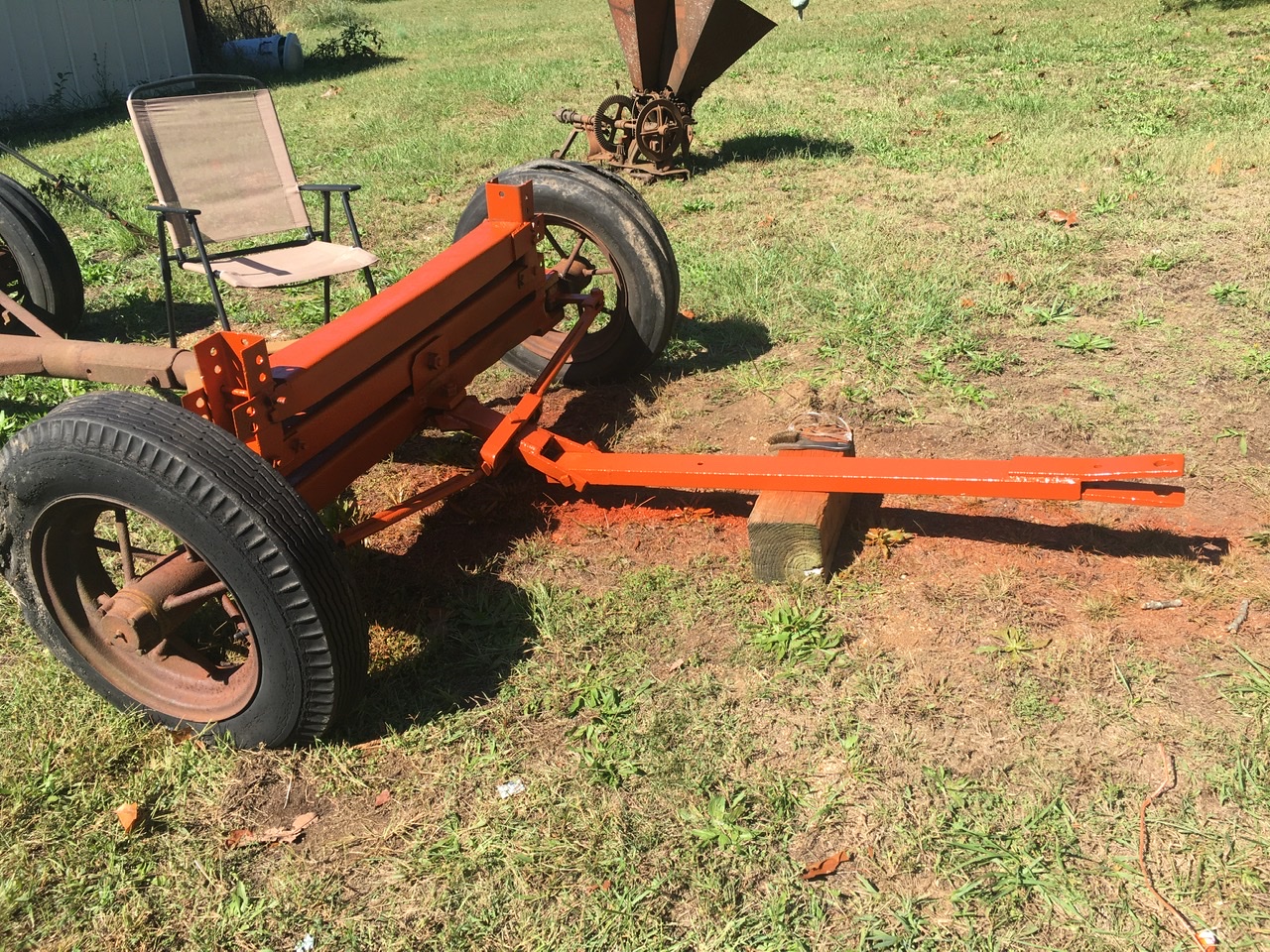

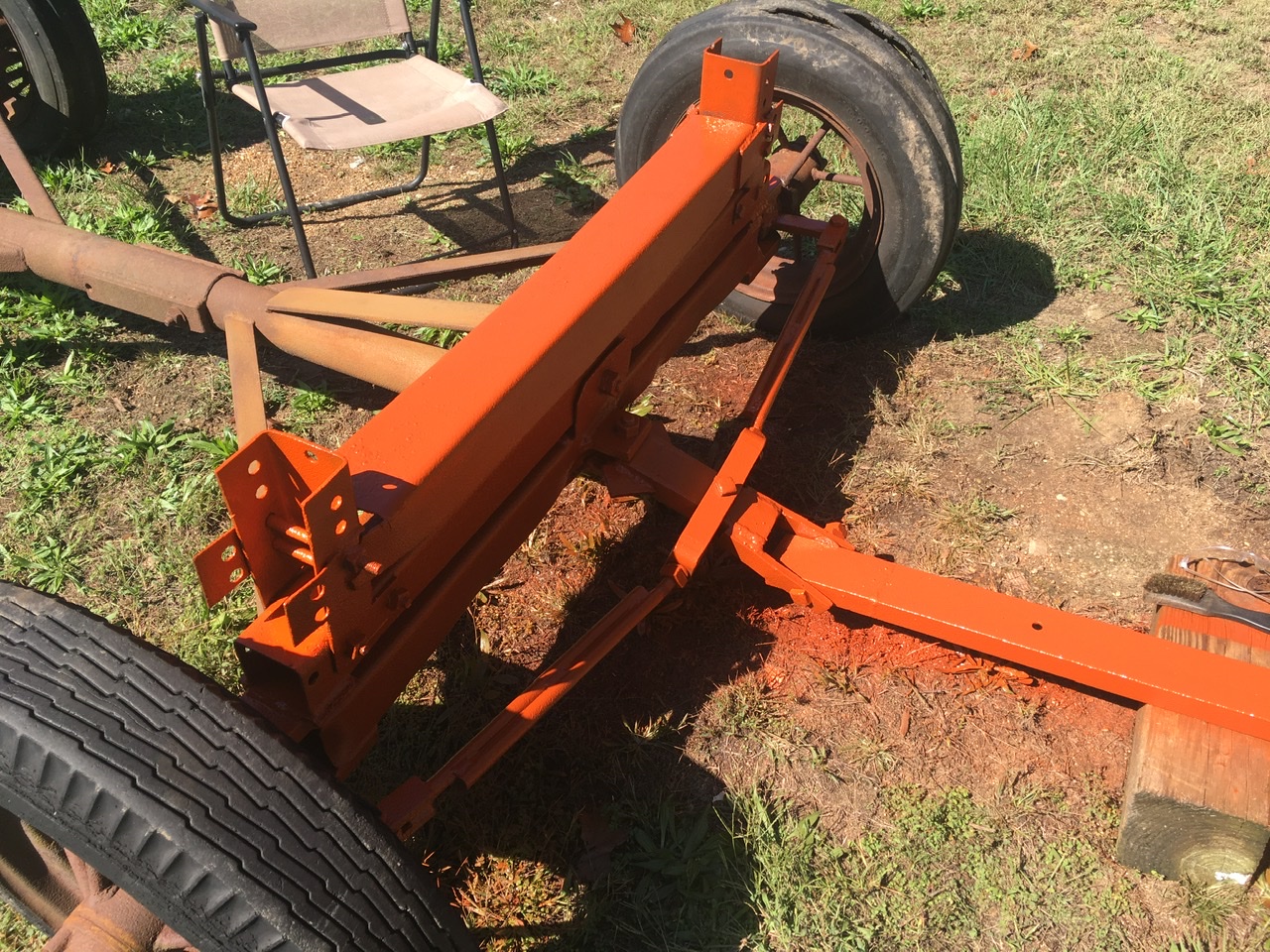

     looks like you're off to a good start. Are you using the "irons" from the old wood part of the wagon? Good idea to have that chair close by so you can inspect your work from time to time. Keep us informed of your progress.

Thanks for the complement. I plan on keeping the Hardware from the old Wagon I might build another Flare Wagon. Yes I keep that chair close I have severe Arthritis in my Knees and a Spondylosis thoracic spine. I try to stay active on the weekends after working all week driving so I won’t hurt as bad. I hope to get some of these Implements done by Spring. TSC was out of Paint yesterday said they should have some by Thursday. I’ll keep you Guys posted on updates.

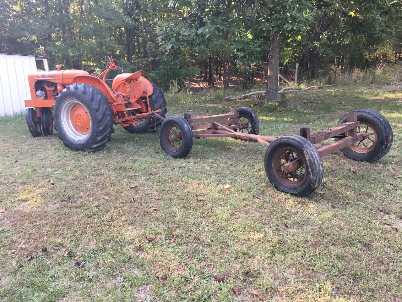

Now with the old wooden box removed that running gear looks kinda like the old New Idea running gears I have, but not exactly like them. Have you look around the bearing housings on the wheels to see any casting numbers?

I’ve look everywhere but I will double check that. I don’t think it’s a David Bradley unless some changed the wheels out one time. I’m wondering if it was home made?
Post Options Post Options   Thanks (0) Thanks(0)   Quote shameless dude Quote  Post ReplyReply Direct Link To This Post Posted: 22 Oct 2021 at 9:19pm
looks like parts from several older wagon gears. and check it as some just had bushings instead of bearings in the wheels

Purple Allis, congratulations on your later 1930s? / early 1940s? running gear. Thanks for sharing.
I’m guess it may still contain the older flat wheel bearings instead of later tapered wheel bearings? It’s wheel hub’s outer bearing caps, contain a later 4 bolt attachment design which was an improvement over earlier threaded bearing caps which could unscrew during use. 849v
