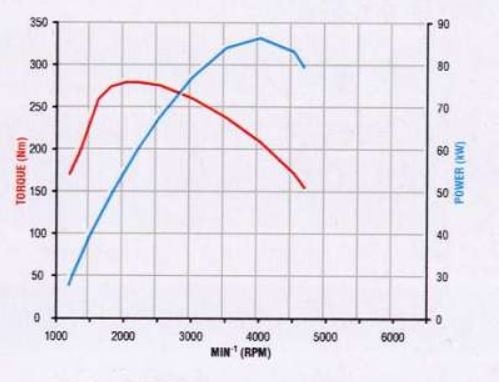

     Posted: 03 Jun 2021 at 9:08pm |
   this is a curve for some smaller car motor so the  RPM and TORQUE numbers are not correct, but it does show what you will end up with on MOST motors... AS you LUG DOWN, you will get MAX TORQUE on the CE motor RED , somewhere around 900 - 1000 RPM i would guess... while the MAX HP-  BLUE will not come in until about 1650 -  1750 RPM  range.
