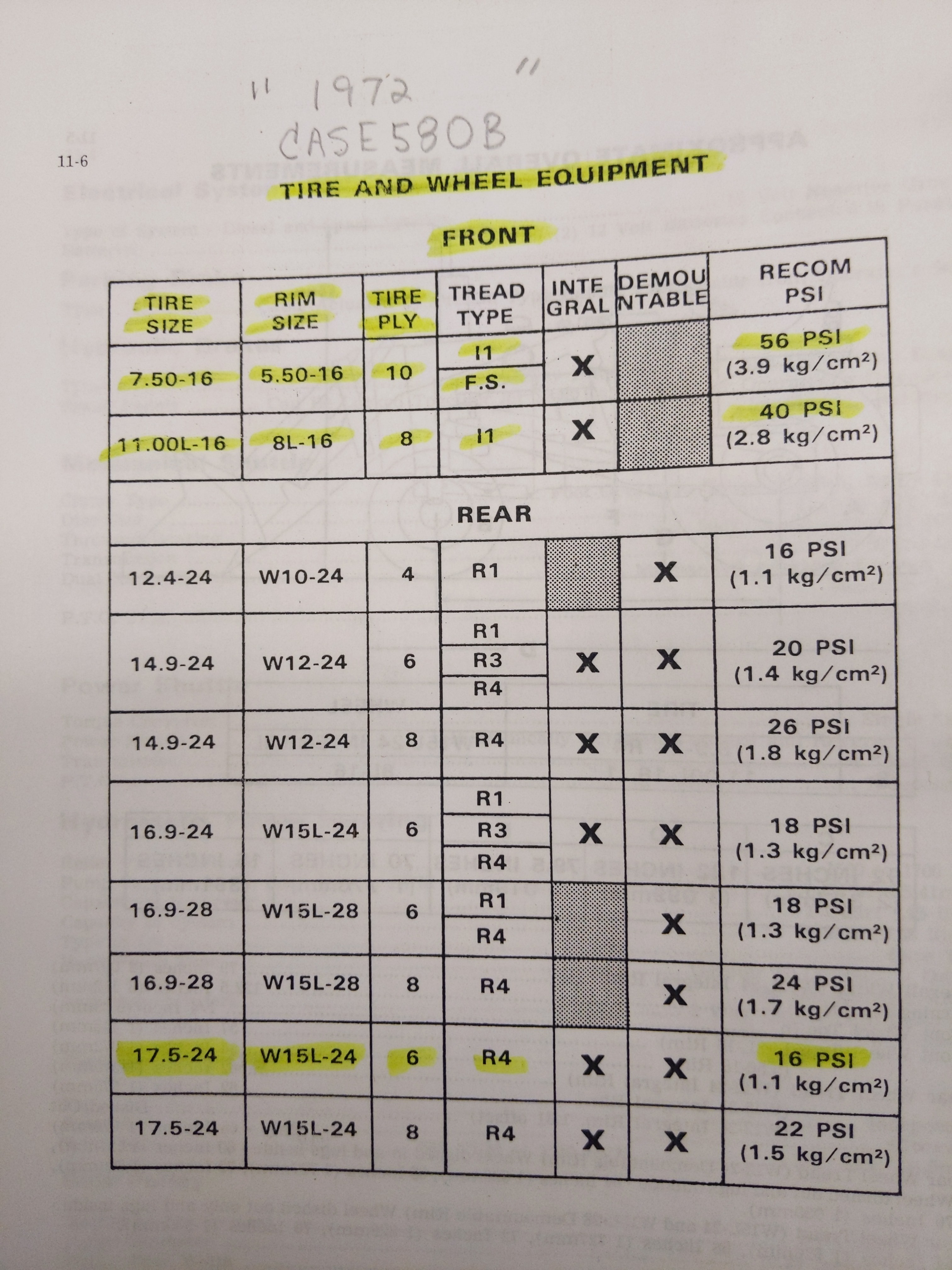

Post Options Post Options   Thanks (0) Thanks(0)   Quote Hunt4Allis Quote  Post ReplyReply Direct Link To This Post Posted: 22 Feb 2022 at 9:11pm
Ok, in manual for this case 580 b it specs either a 7.5-16 or 11-16 and what's on it rim measure 5.5" wide( what's more confusing is what's on it is 9-16 but rub the steering knuckles even when driving straight and there cracking so I'm guessing they used a tube to get them to seat bead) so I could put 11-16 on it since sellers claim width on them is 9 and flip rims around to get more clearance or just use a narrow er tire if I can find 2 that will work...

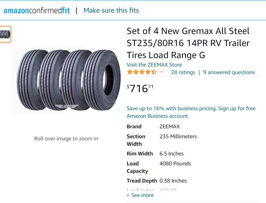

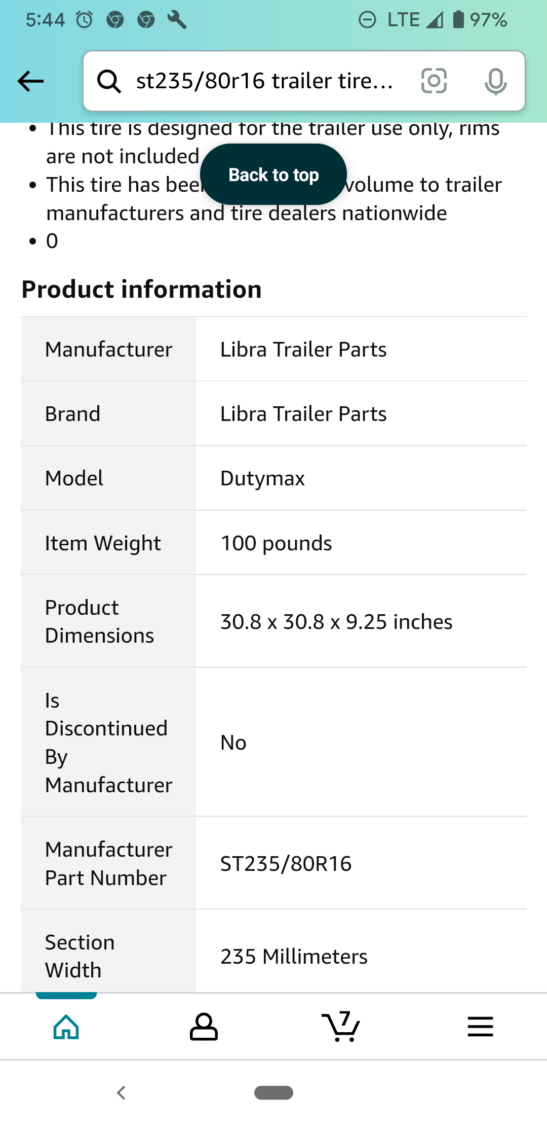

Post Options Post Options   Thanks (0) Thanks(0)   Quote Hunt4Allis Quote  Post ReplyReply Direct Link To This Post Posted: 23 Feb 2022 at 4:46am
Those would be great except they are 9 and 1/2 in wide and the current tires that are on it are 9 in wide when I measure them inflated and they are right up against the steering knuckle which I don't like. I believe mine are 5 and 1/2 in wide rims not 6 and 1/2? Thanks Matt

Post Options Post Options   Thanks (0) Thanks(0)   Quote Codger Quote  Post ReplyReply Direct Link To This Post Posted: 23 Feb 2022 at 6:38am
You will want something with a stiff sidewall for loader work. I had trailer rated tires on a 580C upon purchase and rolled them off the rims twice when turning with a heavy loader bucket. I went with 11L-16 F3 tires and new rims as the old ones were not original type for the tractor and never had another problem.

Post Options Post Options   Thanks (0) Thanks(0)   Quote Hunt4Allis Quote  Post ReplyReply Direct Link To This Post Posted: 23 Feb 2022 at 7:55am
What's odd is there's 2 different tire/ rim sizes in the manual ( they are 5.5 or 6" wide rims as close as I can measure with it mounted)with a 9-16 tire on it. I would do that but I worry about a 11-16 rubbing my steering knuckle since the 9-16 are already too close/ rubbing in certain turns...

Post Options Post Options   Thanks (0) Thanks(0)   Quote steve(ill) Quote  Post ReplyReply Direct Link To This Post Posted: 23 Feb 2022 at 12:32pm
well the factory made two rims and two tire sizes.. those should fit... If you want to keep your 5.5 inch rims, that pretty well determines what tires you can use. take one off and flip it over and see what the "extra" clearance is that you gain.
