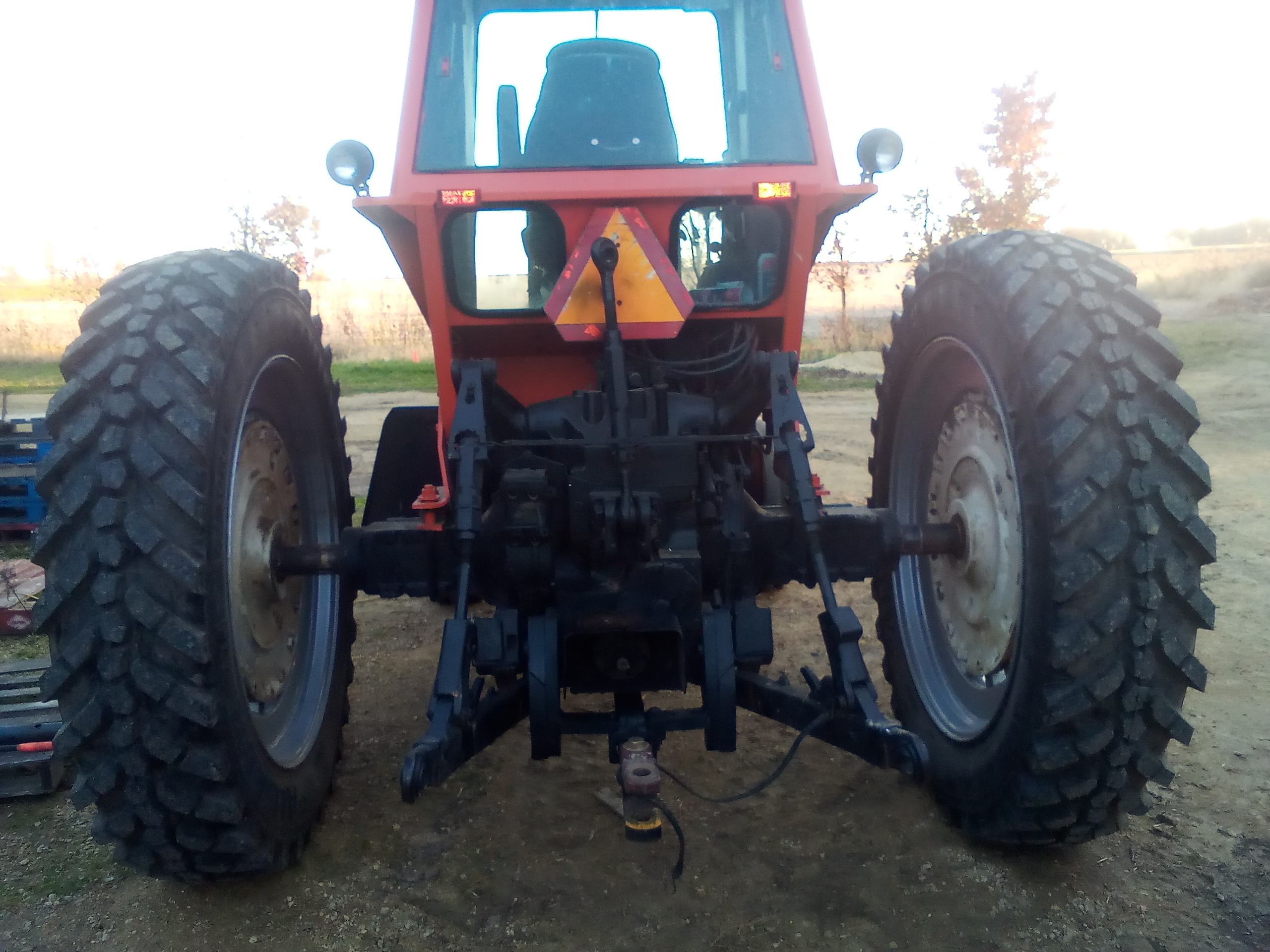

I made a post last year concerning rear tires for 30 inch rows on 7000 series tractor. I ended up putting 15.5 tires on and spacing them to 90 inches for stability and since I plan on running my sprayer at 90 inches.  Posted below is a picture of them. uploads/21175/AC7045a.jpg.

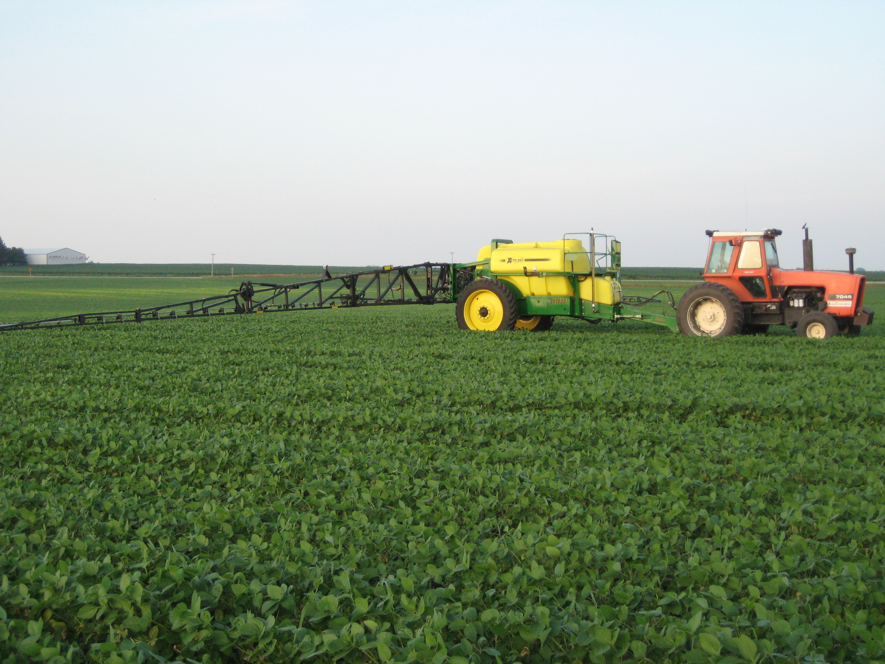

You can slide them out to 90". You will have 7 axle holes showing outside of the center tube. I had holes cut through the flat iron in front of the axle so I could get a 3/4 drive extension and 1-5/8 socket to the inside nut. When these were taken, we were on 18" rows. I will always miss them, but like a sheep I went with the flock to 30". I slid the rows out 2" where to wheels would run leaving a 22" space. You can see it in the picture. We loved to combine them. It was also taken back when dad was still able to run the Gleaner. Fading memories for him now.
