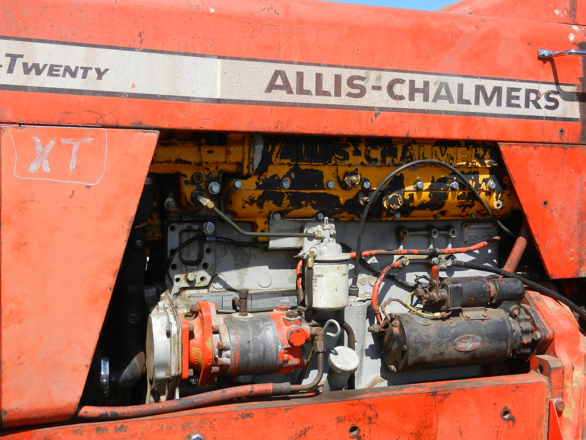

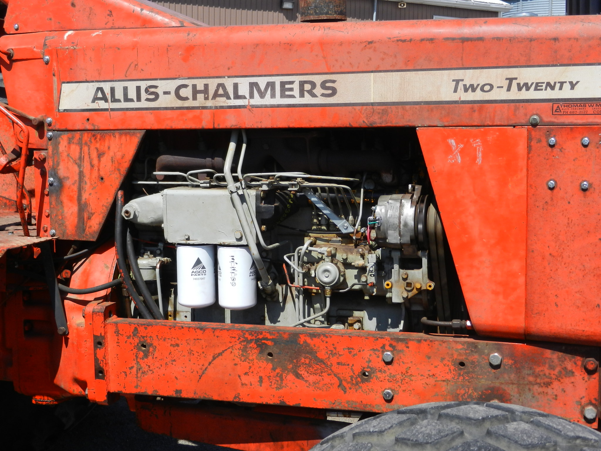

Been there done that. Have a 3500 MK II engine in my 220 that I added an intercooler. To get proper flow, you will require the big waterpump that only discharges to the left side. Now you will need to move the lower rad inlet from the right side to the left side. While I was at it, I recored the rad with 7 rows. to finish it off the alternator is now on the right hand side.

Calvin, your 220XT evidently uses a cam driven oil pump. Was the original engine like that too?

Post Options Post Options   Thanks (0) Thanks(0)   Quote Calvin Schmidt Quote  Post ReplyReply Direct Link To This Post Posted: 27 Oct 2025 at 8:26am
My original 220 cam driven oil pump engine is now in my 210. The engine shown is "On Highway Spec" with the crank driven oil pump and the inline injection pump. It had 82 original hours when installed

Post Options Post Options   Thanks (0) Thanks(0)   Quote SteveM C/IL Quote  Post ReplyReply Direct Link To This Post Posted: 27 Oct 2025 at 8:37am
Im confused. That last pic shows a camshaft driven tach cable and that can't happen unless it's a cam driven oil pump?
Points: 22845
Post Options Post Options   Thanks (0) Thanks(0)   Quote DrAllis Quote  Post ReplyReply Direct Link To This Post Posted: 27 Oct 2025 at 8:41am
I suppose the Harvey engineers could have offered a dummy tach drive option driven by the camshaft ??

Points: 22845
Post Options Post Options   Thanks (0) Thanks(0)   Quote DrAllis Quote  Post ReplyReply Direct Link To This Post Posted: 27 Oct 2025 at 11:14am
For those who haven't been into one of those engines, there is a hollow spot in the block where a cam bearing could have been, but instead the camshaft driven oil pump gears  were instead.  The story goes that any of the tractor pulling blocks (with 4 turbos/200+ psi boost) that failed, usually failed in that area of the block from lack of cast iron.
