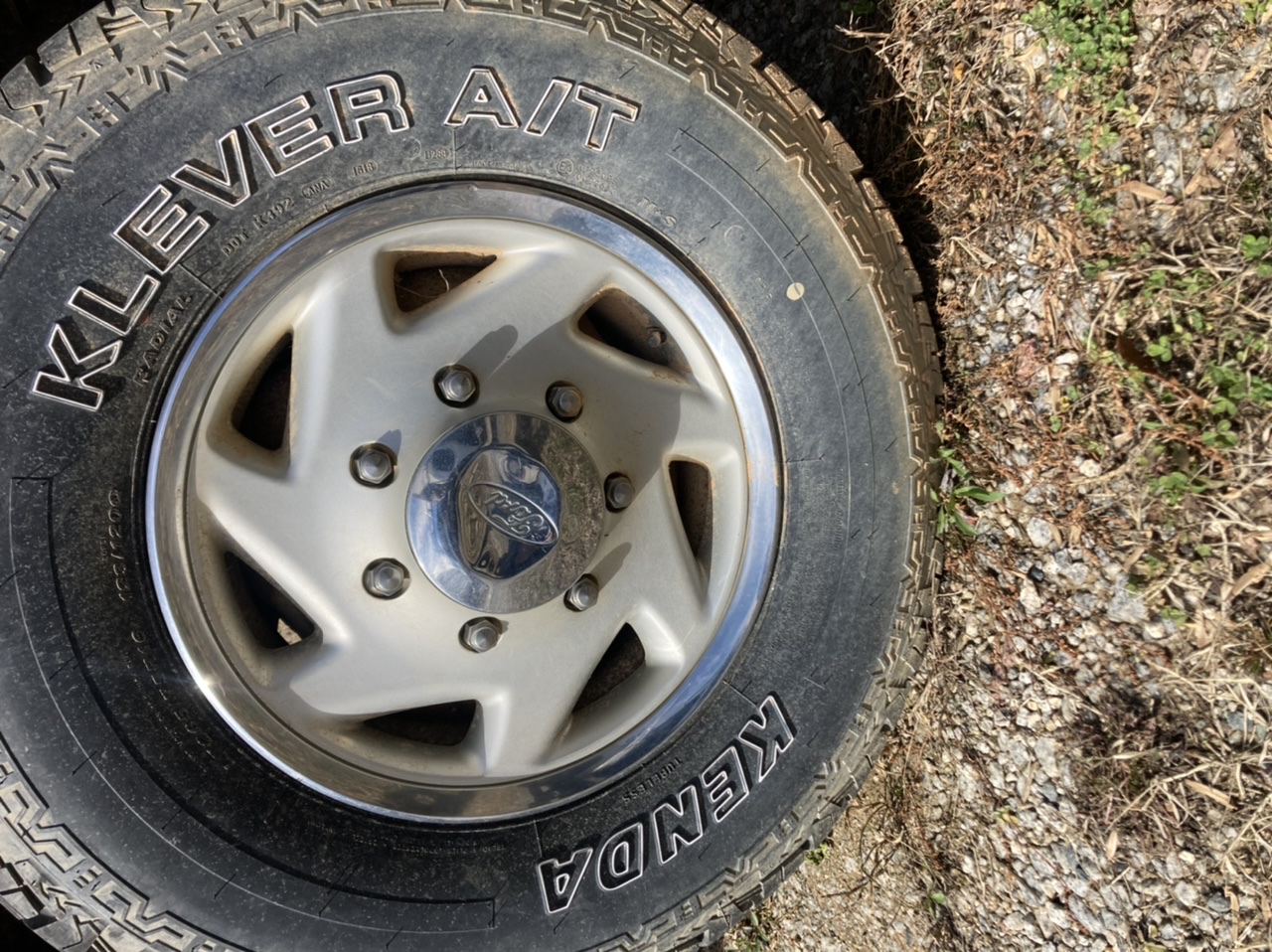

I run an '05 3/4 ton, my dad runs an '11 3/4 ton pick up. Today, a co-worker was showing off his new tires on his '11 Ford 3/4 ton van. His van only has 7 lug bolts ConfusedOuch ??  my 05 has 8 and my dads '11 has 8 ShockedShocked ?? What's the deal ??  Are vans on a different load rating or is Ford making big $$$ on saving a lug bolt/nut per vehicle ??

Probably both. I now vans are available in 1/2, and 3/4 ton versions.

Ford came out with that abortion long ago
Knew several guys bought light 3/4t trucks had seven lug wheels and nothing back then years ago as to aftermarket for them

YEP... a LIGHT DUTY 3/4 ton... Combination of a 1/2 ton with 3/4 ton axle parts with special hubs/ wheels. .......... only a few years.
My co-workers van is a 2011 model year Ouch. What's the "few" years break down ??

1998 - 1999 they were called "F250 LIGHT DUTY"
2000 - 2008 they were called "F150 - 7700#"
2009-2014 they were called F150 Heavy Duty.

The "7700" refers to 7700 lbs GVWRating versus 6250 lbs load rating on a std F-150. Heavier axles and brakes on the 7700 lb package.
Question: were you looking at the hub cap or the actual wheels? Because Ford has a hub cap that has seven dummy lug nuts on it that they used on 3/4 trucks and vans?
