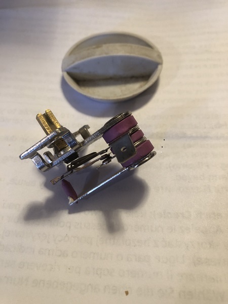

 Need a little info from the Gurus on a part for the electric heater in the bathroom. I was lowering the "Low-High" setting on the heater when the dang knob came off in my hand,,,,I heard a "ping" somewhere on the tile floor and the heater stayed on but knob was just laying on top of the heater.
 The heater is a Two heat setting 750W and 1500watt that is only bout 6 months old but surely a china product.  Took the top cover off and the knob had screwed itself off the rheostat/Potentiometer housing and after screwing it back on (Left hand threads) there is a small piece that is pushed by the adjusting knob that closes the contacts to raise temp on heater. THAT piece is what I heard fly off in the distance,,,,,,somewhere,,,,!!!
I checked out Surplus Center and ebay and amazon but cannot find one similar.
 Wondering why a 3 position toggle switch "OFF-LOW-HI" wouldn't work instead of the rheostat type control,,,,?

Joe, i dont really understand the "SWITCH"... Not sure if all it does is switch from 750w to 1500w ( two positions) or is it a rehostat / thermostat that sets the temp ?
You could install a double pole switch that was 750w on one side and 1500w on the other ( and maybe OFF in the center.... Or you could install a THERMOSTAT to vary the temp ?

post the name/make/model /number ? info of the heater
google might find xxx parts for it
if it only says 'off-low-high' then it's just switching 1 or 2 , 750w heaters on . It'll be preset for a max temp.
if it said '0.....10' and the knob smoothly rotates, it's an 'adjustable'  thermostat
