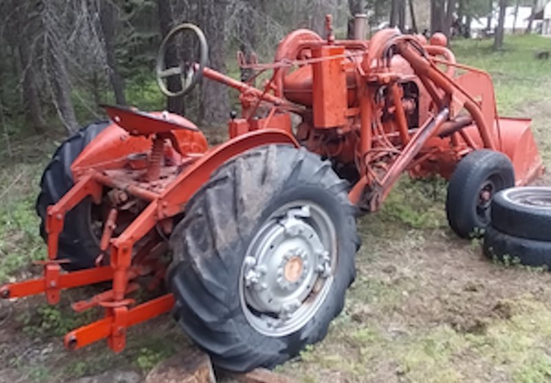

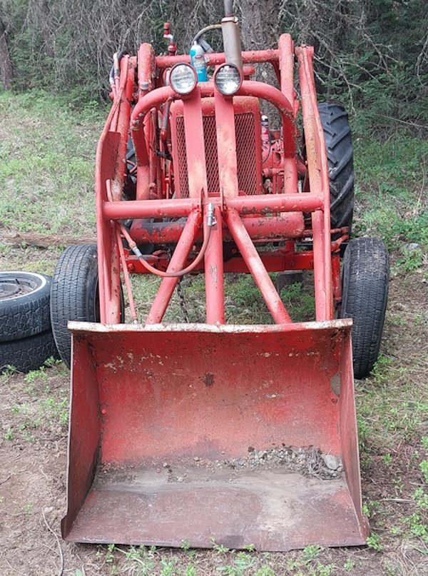

I have long coveted an Allis Model CA, this one sorta fell into my lap for cheap. Loader, aftermarket 3-Point.
The engine was lightly stuck but my 14 year old Grandson had it freed up the next day. The carburetor needs cleaned, etc. before trying to start.

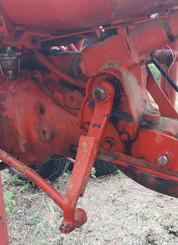

It has some issues with the steering box.

CA steering box arm normally points UP... Yours points DOWN like a model B.... maybe to get it away from the loader frame ?
Points: 5134
Post Options Post Options   Thanks (0) Thanks(0)   Quote AC720Man Quote  Post ReplyReply Direct Link To This Post Posted: 9 hours 35 minutes ago at 9:43pm
Never seen a loader on a CA, neat find. Good luck with it and hope you get it going. The extra length arm is for extra leverage steering I’m assuming due to the extra weight of the loader?

Not sure on that, extra length on the drop arm would surely = less leverage?
What's the score with the negative camber on the front end too, is that normally how the adjustable WFE would sit & the one on my B is just wore slap out? Looks like you've got wider automotive tires like I do but mine just rub at the top of the knee, basically straight up/down with no camber at all.

A loader on a CA: That's surely asking for steering gear issues. Whoever added that extra length has thing basswckwards. That lever needs to be shorter for extra leverage. If you plan on keeping the loaded on it, it looks to be a good place for a FarmerFix of a replacement power steering box from a car or light pickup.
 I suppose that the original front axle gave up from the abuse the loader added, since it was replace with a D12 axle, needing the arm to point down.
