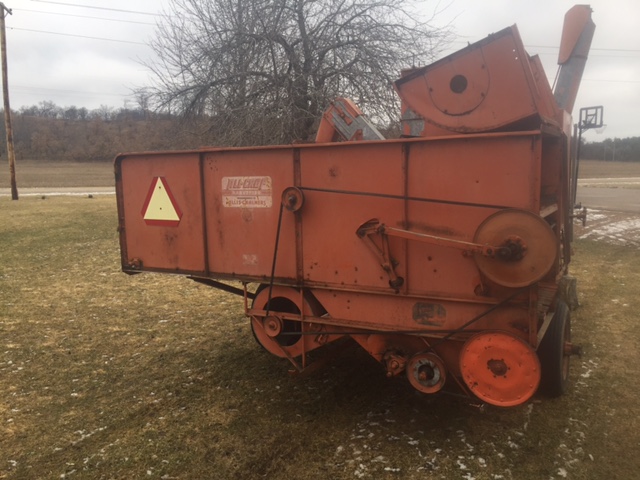

The wife said it's alright to keep it!
All crop 66, I'm sure I'll have lots of questions.

Very nice, one more save from the scrap yard. Even has a Scour-Klleen.

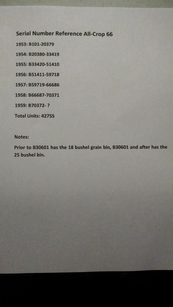

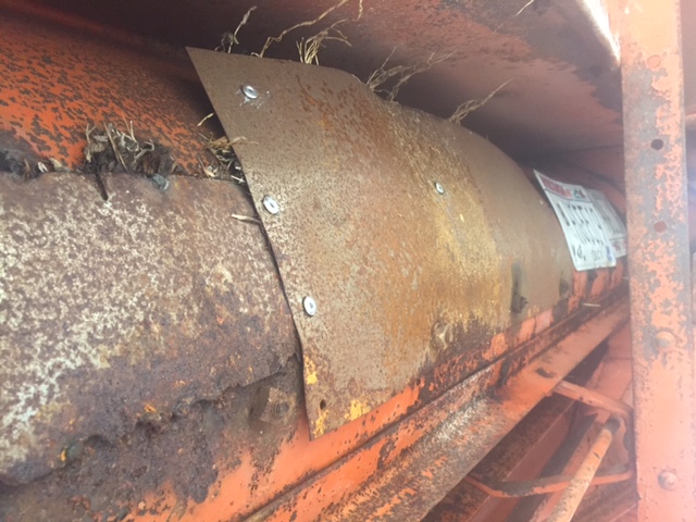

Serial number B6583, anyone help me out with the year? Definitely needs new sheet metal on the concave (last picture)

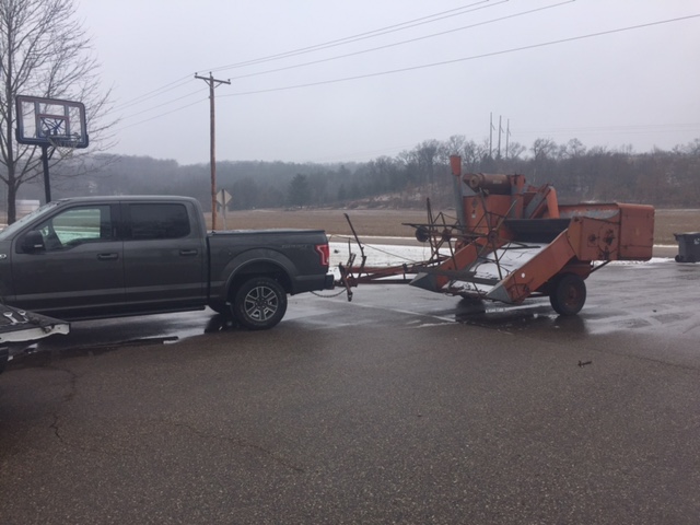

Is there a lot of tongue weight on a 66? I guess I thought they looked pretty balanced, header in front of the axle, all the walkers and shoe and everything else behind the axle, grain bin and cylinder above the axle, seems like a good setup.

No, It seems to be pretty well balanced so it did bounce up and down a lot.

I have to pull one about 20 miles. I have been building an offset hitch for it. Just seeing your first picture helps me out, I was worried about the PTO shaft hitting the bumper or tailgate but it looks like it will hang straight down at the u-joint, so that should be alright.

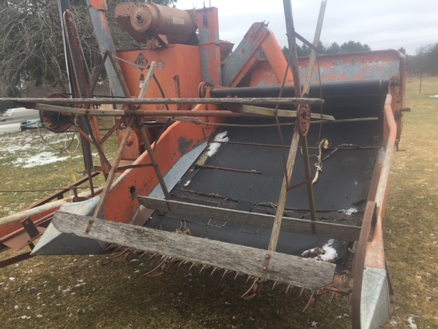

I tied the pto shaft back to the support for the shaft and it stayed just fine, at first I thought it was a 60 also but the pickup is 66 inches wide, that and the 6 batt reel that was an option on the 60 but standard on the 66 are the only noticeable differences (if I've done my homework properly), unless it's a "big bin" 66 then their are some other differences.

Looks nice! Pull those patches off the concave, and take another pic. That would be interesting to see.
What I find to be the most amusing is the way the bats are on the wrong sides of the reel arms. Lol
I have a combine similar to that- small bin, but 6 bat reel and header with flares. Mine is a 60A with a 66 header because the serial number starts with a "A". ALL 66 serial numbers start with a "B". (B does not indicate Big Bin like some think)\
I'm glad you're saving it from the scrapper! I'm a sucker for these All-Crops, and I've already got 6 (three 60A's, 1 Camel Back, 1 BB 66, and a Super 100). Two of them are in my possession, and 4 I still need to get around to hauling to the ranch from various places. One of them is residing in MN for the time being.

The 1953 models or the first year of production of the 66 has the 60 bin. 1954 and up they are the 25 bu. Big Bin. If you have questions or looking for parts Travis2766 just pm me.
