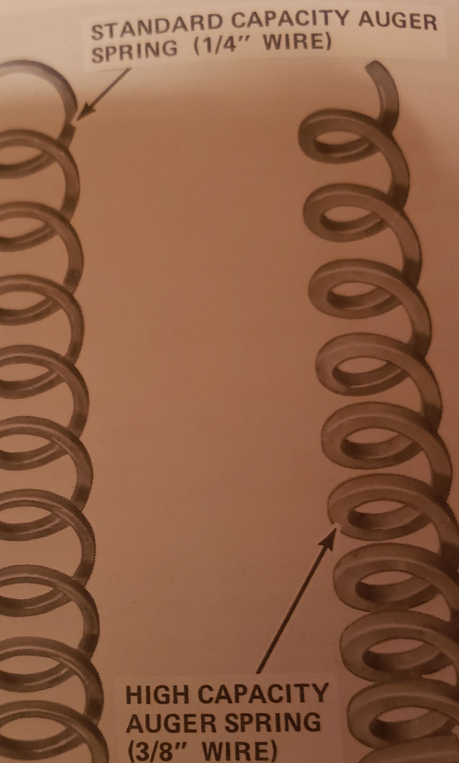

I did the math on my planter and I believe I put down 171 .lbs more than what I set planter for.
Drive tire,chains ,sprockets are all good.
Not sure what I'm missing.
I have the 1/4" springs, and they are like new.

Tire size sprockets all that jazz is good. Have books.    Fertilizer hoppers are 550 .lbs each. This is a 6 row.
Target was 298 .lbs per acre, obviously went over that amount.
Could it just be the size of the fertilizer granules?

Yes, it could be. I asked you if you knew the density of your fertilizer. I don't run an Allis planter, though we did many years ago, but my planter book states more/less the following under the fertilizer rate chart: "Commercial fertilizer varies widely in density. This chart is based on XX.X lbs per cubit ft. Verify the density of your product and. . . blah blah blah".
You should be able to contact your supplier and ask them, and see if there is any such information in your book. There should also be a way to calibrate, by jacking up a drive tire, spinning a given number of revolutions, and catching and weighing the discharge.
