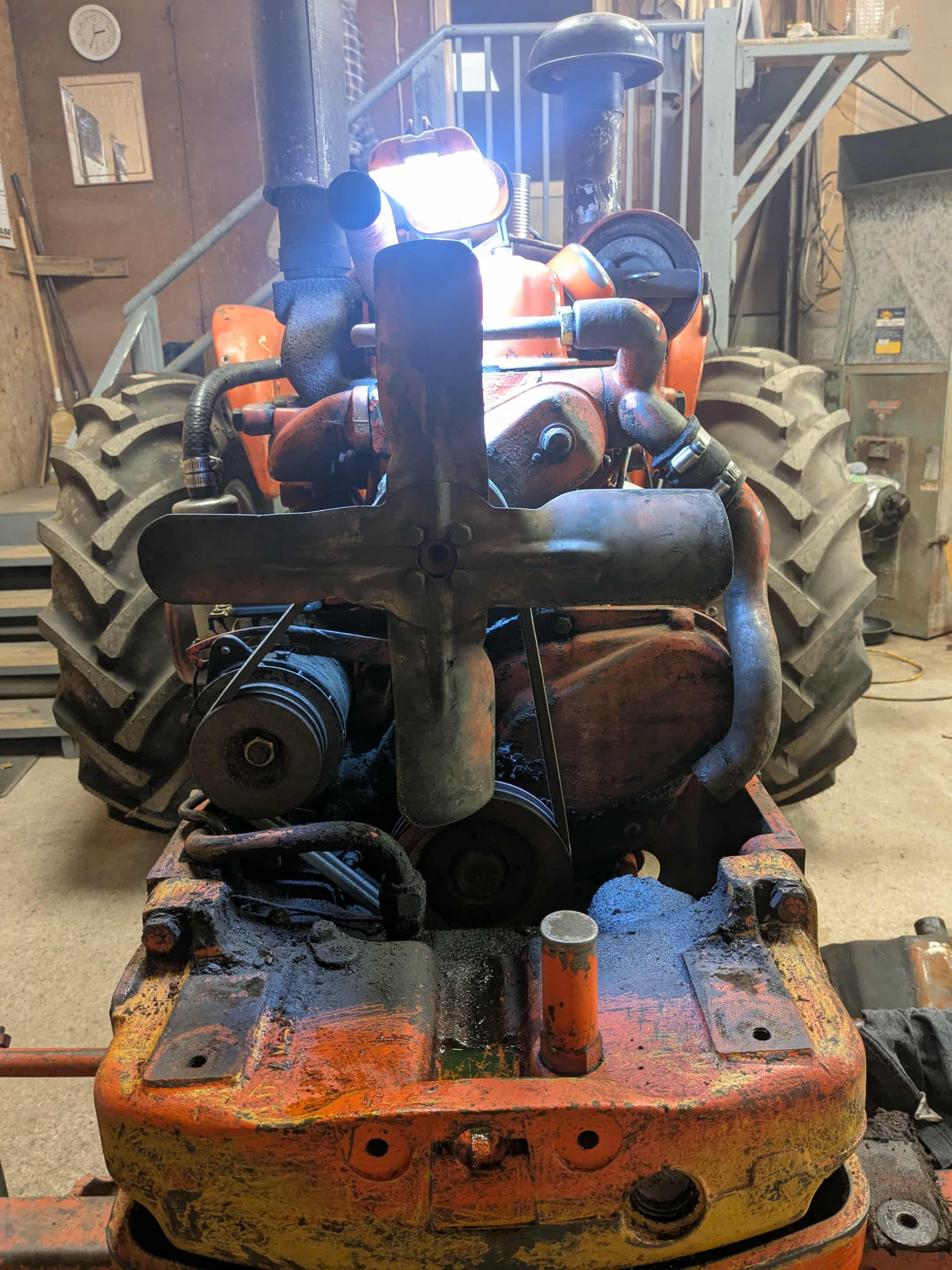

Got the new D15 diesel in the shop to make some repairs over the winter and came across something I have not seen before.  The fan is much closer to the radiator shroud on the right side compared to the left.  I can easily fit my index finger between the fan blade and shroud on the left side, but can barely fit a pen on the right side.  Same goes for the height of the rad - the previous owner put spacers under the mounts to raise it.  If they were not there, I suspect the fan would not be able to spin without causing damage.
Everything looks original:  Perfex brand radiator, 4 blade fan and appears to have the original water pump (brazed on one spot).
Would anyone have any insight on this problem?

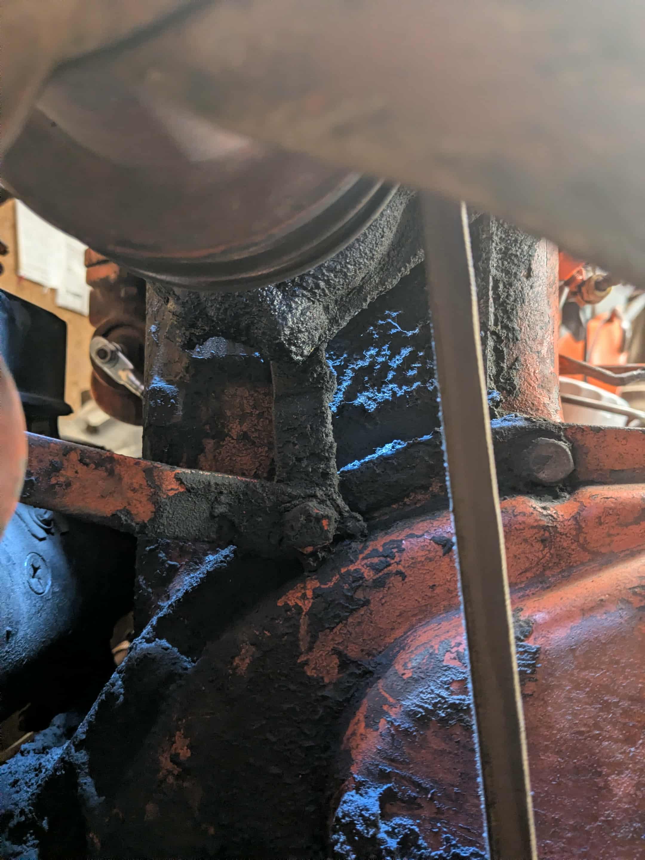

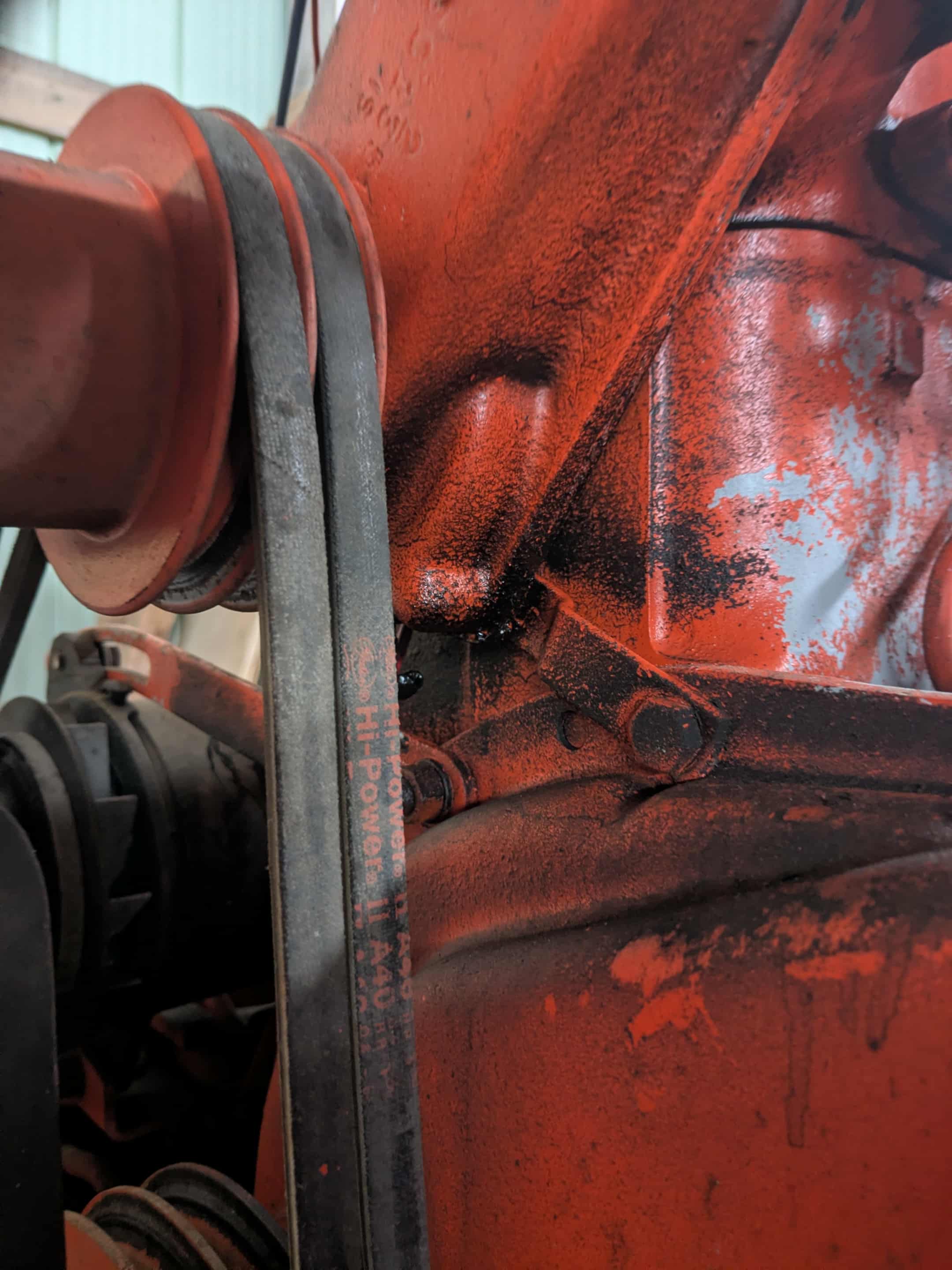

Problem solved!  Nothing wrong with the radiator.  It's the water pump!  The last person who put it on installed it incorrectly.  The bottom brace was secured to the wrong timing cover bolt, throwing off its location which caused the fan shaft to move up and to the right.  Who would have guessed?
I had to tear apart the front end of my other 15 diesel to figure it out, but it was worth it!  No major effort required to solve the problem!
