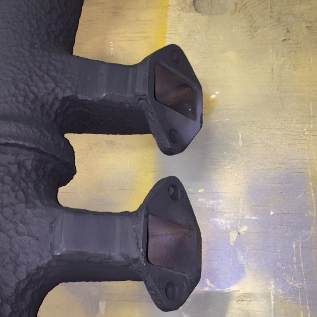

Post Options Post Options   Thanks (0) Thanks(0)   Quote jerbob Quote  Post ReplyReply Direct Link To This Post Posted: 07 May 2018 at 10:58am
Got my exhaust manifold and stock muffler done and ready to mount.
Before pic of manifold
After
I repaired the muffler but have a fabricator/welder company I work with and they did the repair on the manifold. They said likely would not take a weld as the carbon was likely gone from the metal. They were shocked it not took a weld but allowed them to cut back material to beef it up. The rest is a ceramic paint made to hold up to 2400 degrees.
Cost me $140 repair for the manifold. Sure beats spending 650.00 plus shipping from the West costs for another one I found.
