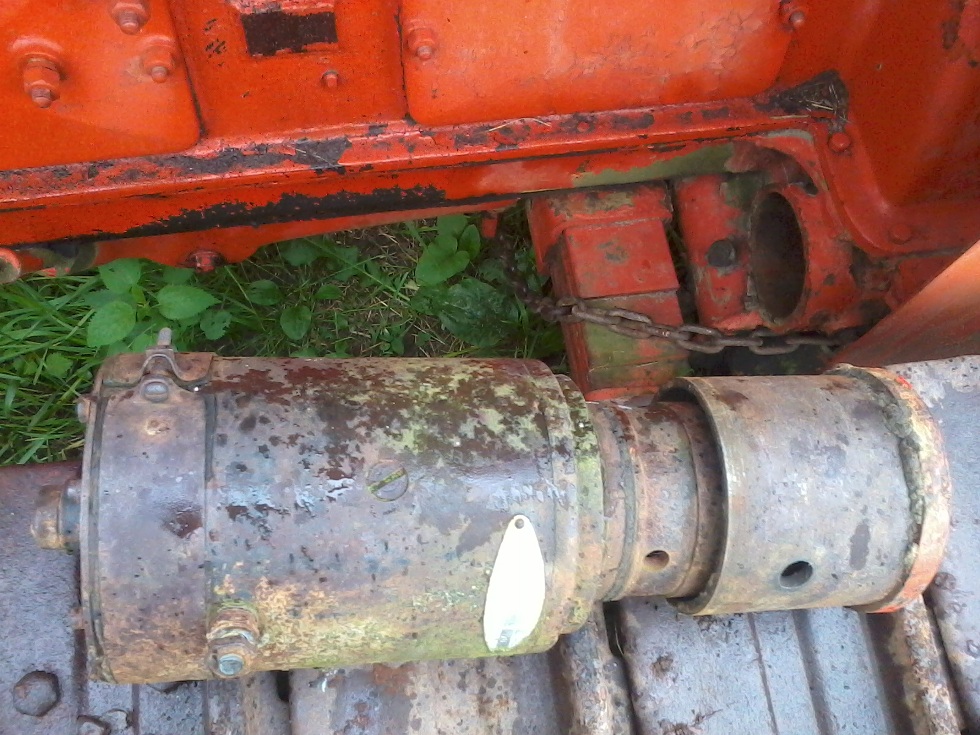

Ran across an old LA Case starter with smaller bore than the A-C K has. Looks like K has 4 1/4th inch hole, And the case has 3 5/8ths hole?
 Got me to thinking, wonder if I can spin out an adapter to take up the space...
 This starter has a 10 tooth bendix gear and near 1/2" point to point on the teeth..
and the starter is an Auto-lite,  ML 4929 7D Chuck some heavy wall tube in the lathe and ... think it will work?  The sleeve was what somebody put in the starter hole and now sitting over the Case's starter nose cone, you can see how much difference there is between the starte nose cone and the dust cover somebody had made and put in the hole...
