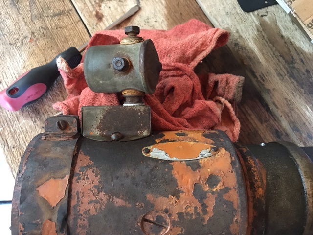

Post Options Post Options   Thanks (0) Thanks(0)   Quote Btracy62 Quote  Post ReplyReply Direct Link To This Post Posted: 29 Oct 2021 at 5:14am
I just acquired a WC.   It has no push rod for starter.   There is no starter switch on the starter either. There is a solenoid on the starter where the push button should be mounted.   Did all WC’s have the pushrod start? Or did some have an electric button?
I am guessing this was some cobbled up add on but was curious about what is correct

Post Options Post Options   Thanks (0) Thanks(0)   Quote AaronSEIA Quote  Post ReplyReply Direct Link To This Post Posted: 29 Oct 2021 at 6:03am
All would have been rod starting.  Someone converted to a switch.

Post Options Post Options   Thanks (0) Thanks(0)   Quote CTuckerNWIL Quote  Post ReplyReply Direct Link To This Post Posted: 29 Oct 2021 at 9:18pm
Not all had a rod. Bill Long mentioned once, when the first electric stat tractors came to be unloaded, you had to stand in front of the left rear wheel and push the starter button on the starter.
  I think he said that was the early 39 models??? A local old timer Allis mechanic told me 39 was the first year for electric start. I don't know if that is fact.
 None ever had a solenoid for the starter.

Post Options Post Options   Thanks (0) Thanks(0)   Quote Btracy62 Quote  Post ReplyReply Direct Link To This Post Posted: 31 Oct 2021 at 6:49pm
After reading Bill longs post and looking at the S/N this must of came without the rod.    That explains where there wasn’t even any mounts for a rod

Post Options Post Options   Thanks (0) Thanks(0)   Quote CTuckerNWIL Quote  Post ReplyReply Direct Link To This Post Posted: 31 Oct 2021 at 8:35pm
 What year WC do you have? None of the unstyled WC's had any provision for a starter, so no need to have a push rod for the switch.
