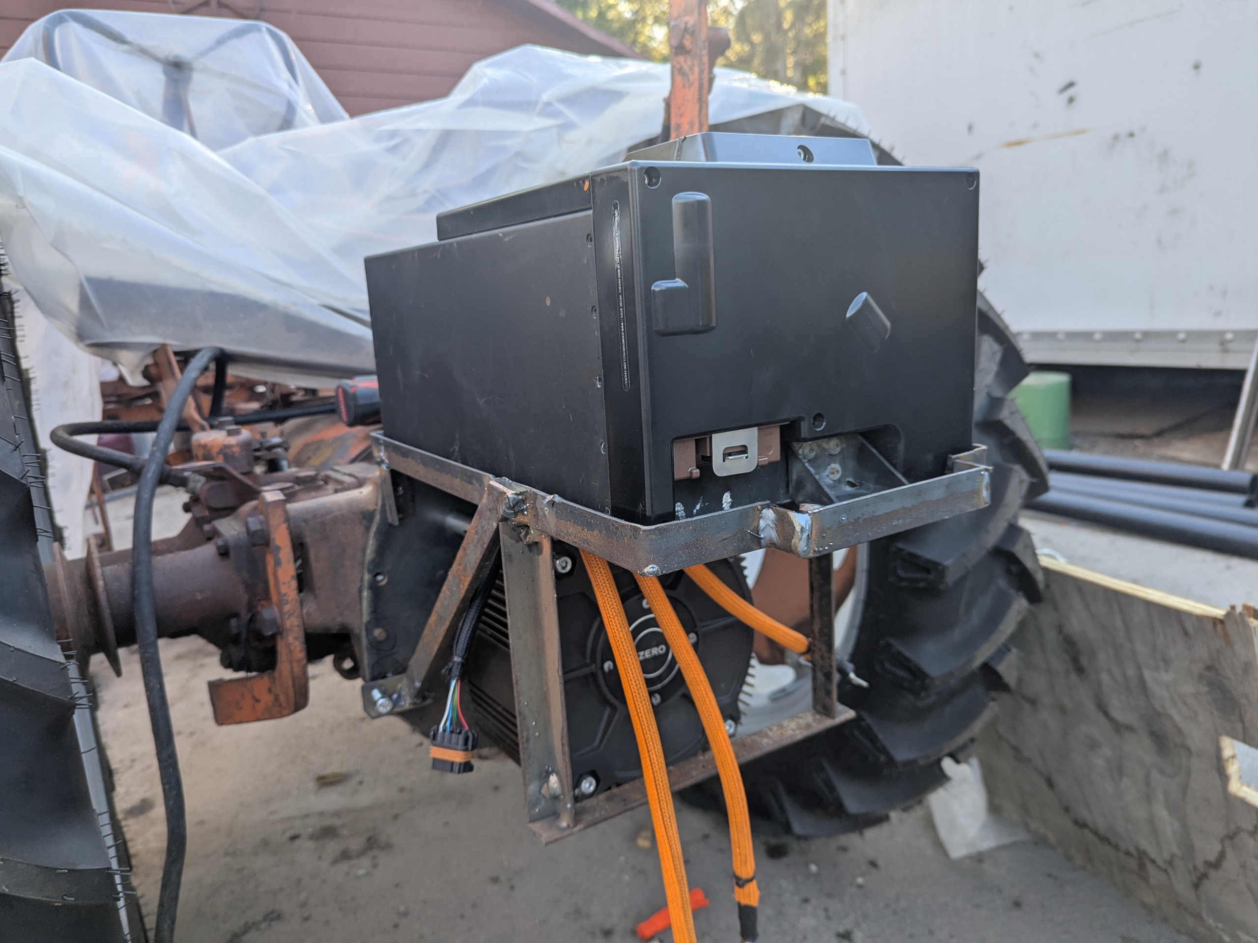

This shows the motor and battery tray.  The motor controller will bolt to the vertical bracket under the battery.  The charger on one side and the vehicle control board on the other.

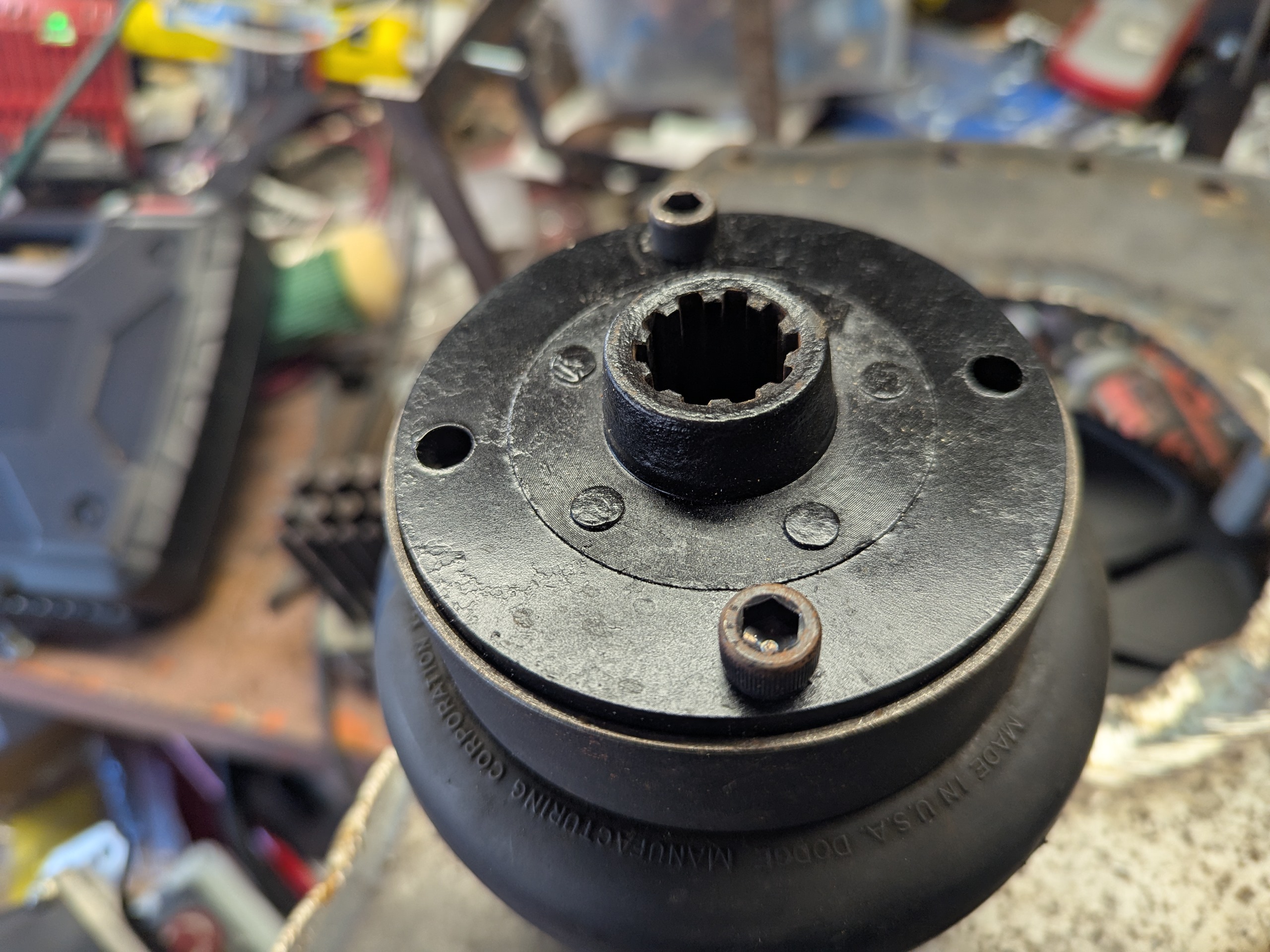

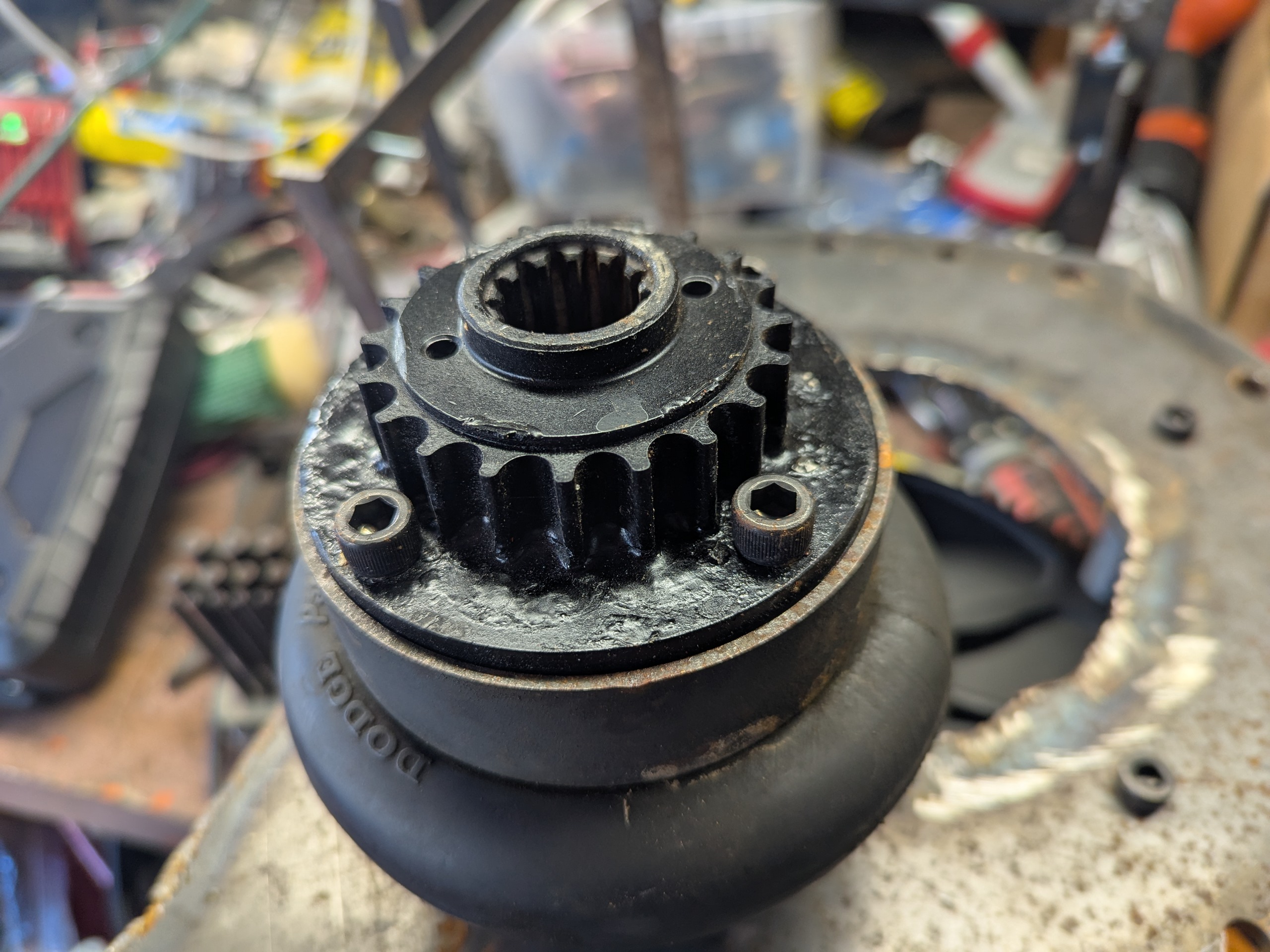

These are the two spline adapters I made for the Paraflex coupling in the middle.  For the motor spline, I took a motor pulley that drives the cogged belt the bike uses and turned it down for a snug fit into the 1/4" plate.  Both the clutch and pulley are brazed to the plates.  I wasn't sure how the pulley would react to TIG welding so I played it safe and brazed.  There is a lot of surface so I think it's still lightly loaded.
