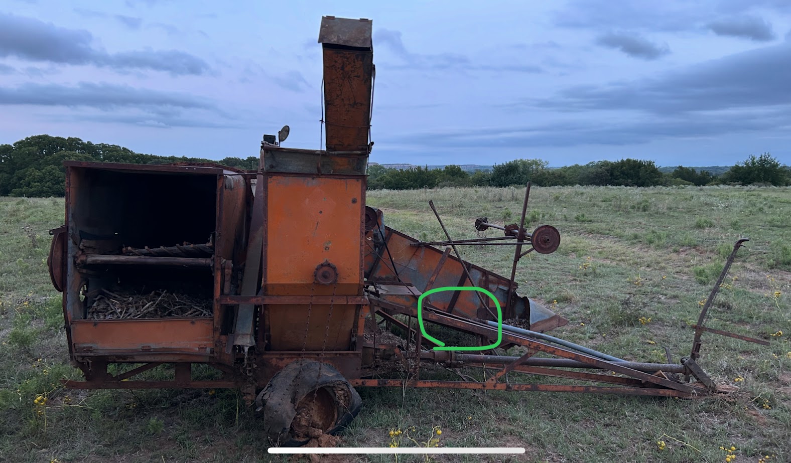

Joined: 08 Sep 2014
Points: 8456
Post Options Post Options   Thanks (0) Thanks(0)   Quote CrestonM Quote  Post ReplyReply Direct Link To This Post Posted: Yesterday at 10:29am
Unfortunately, it looks like your serial number is gone. It would be stamped on this angle iron piece in front of the bin. Looking at your machine, however, it's a 1937 model since it doesn't have the patched hole behind the cylinder where the original tailings recleaner  grain return would've been on the 1935-1936 machines.
The number you found by the cylinder, if that were a serial number, would place it as a mid-1936, which doesn't seem right, and the 7 in front throws me off as well. I'll check my machine again and see if it's got a number stamped in that location, but I don't recall seeing one there on the machines I've looked at.
Edited by CrestonM - Yesterday at 10:34am
