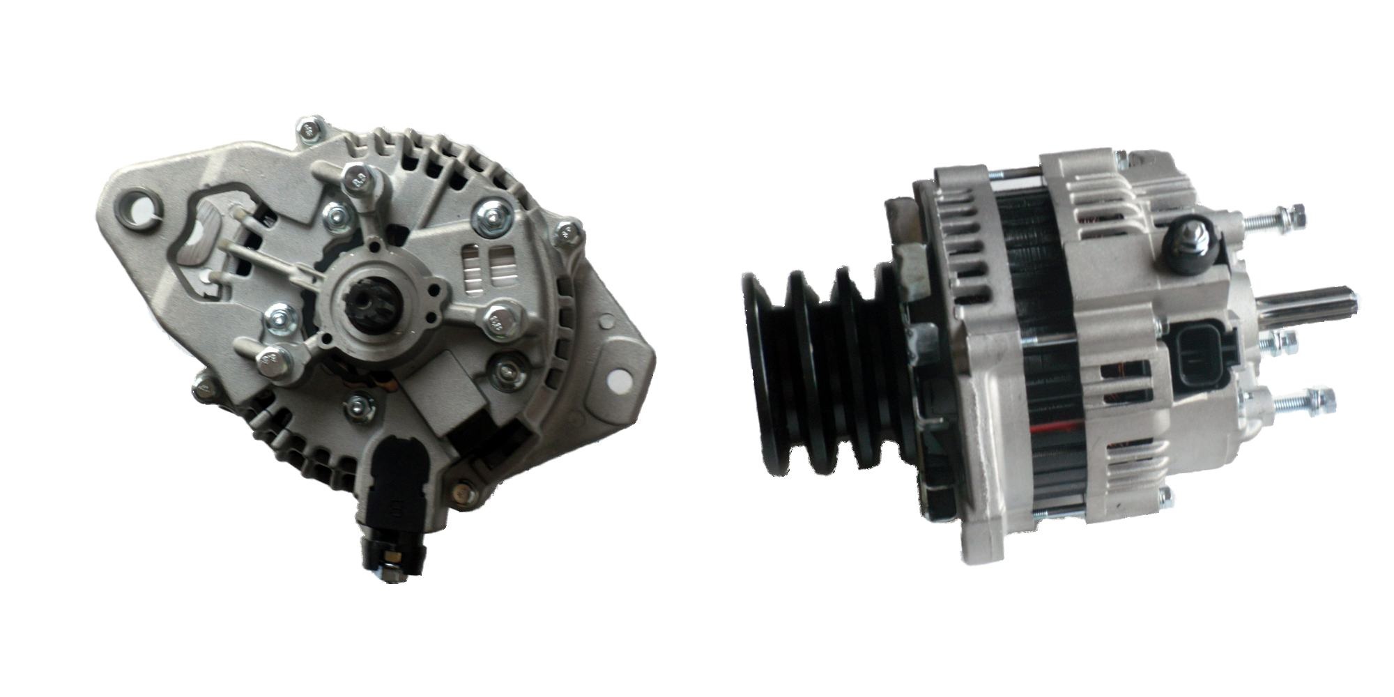

Apparently Isuzu uses something similar in their modern trucks. An alternator with an external shaft.
It's on the rebadged GM stuff, so you may be able to get it from your local Chevy dealer.
