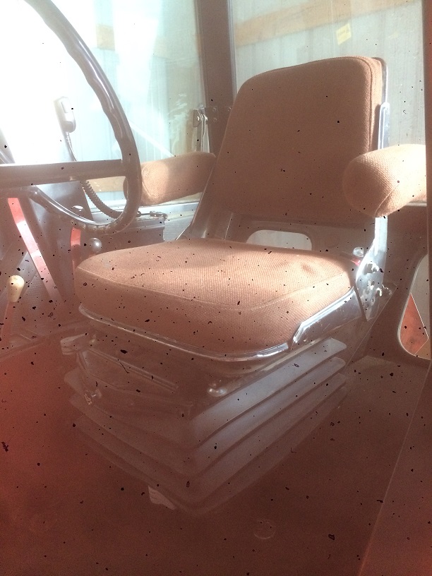

Bought a aftermarket suspension for my 7060 and it's the smoothest riding air ride seat I've ever been in. I think it was $600 at the time. They still sold just the suspension on eBay a while back because dad bought the same one to go in his 6420 Deere, which had to have had the worst air ride seat ever built. You were coming down as it was coming up. They are the same as a km 1003 from tractorseats.com

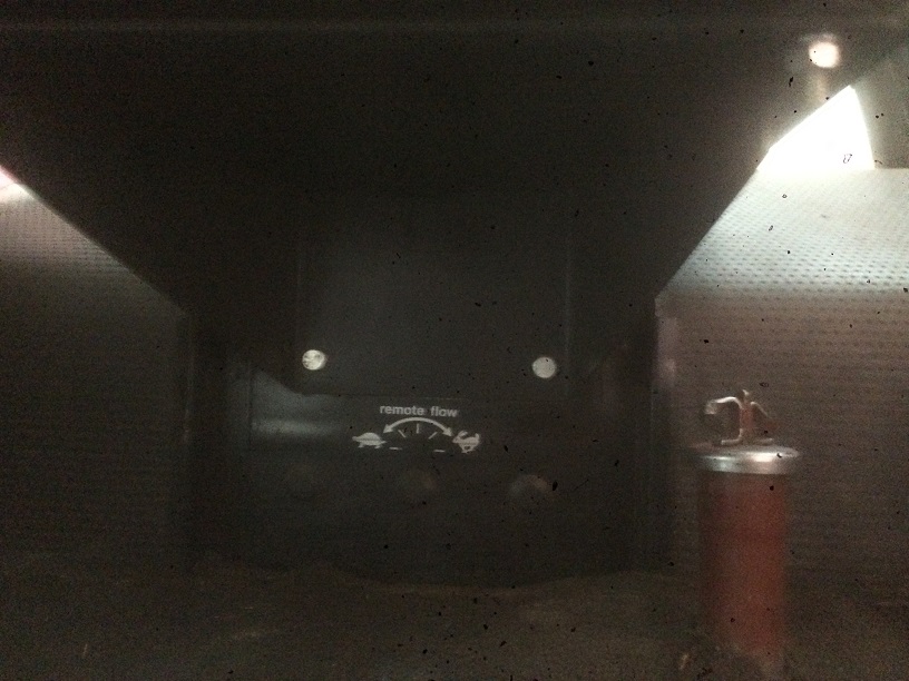

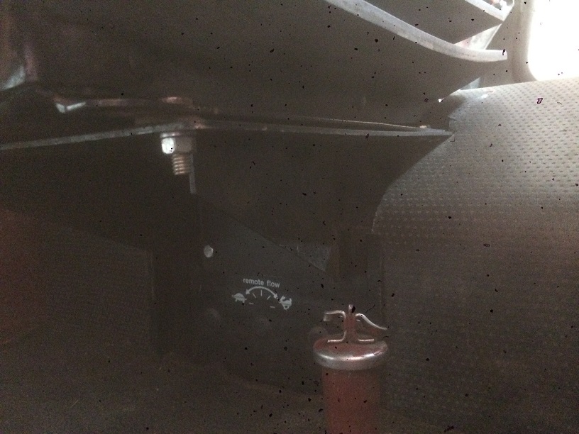

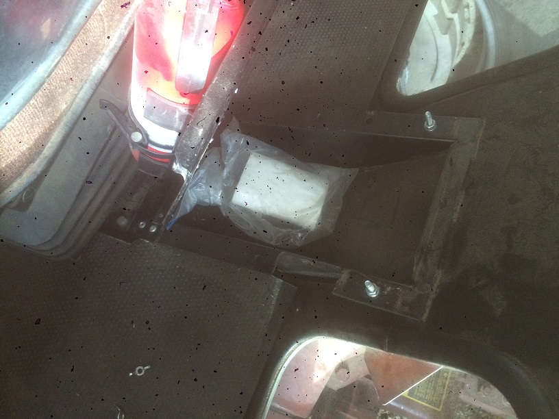

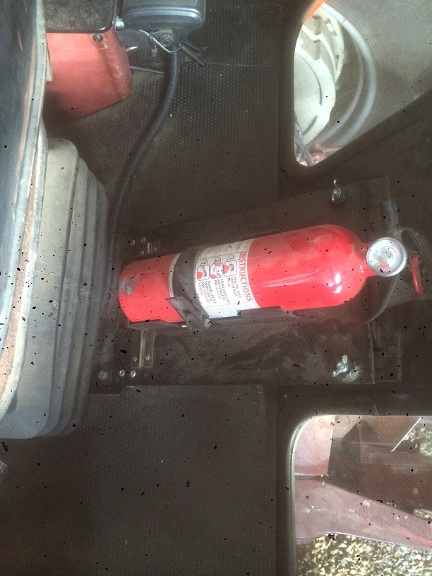

Mine has a wedge built that bolts to the bottom half of the incline that gives the air seat a flat base. If I get a chance I will take some pictures of it. The rails on mine are on top of the suspension between it and the seat.

Sorry my phone camera has dirt behind the lense so it doesn't take real good pictures anymore. I kind of forgot what that bracket looked like I guess. it doesn't set on the slope near as much as I thought. Just a few inches. If you need any measurements to make your own let me know. I made a compartment door behind and put my fire extinguisher on it too.
