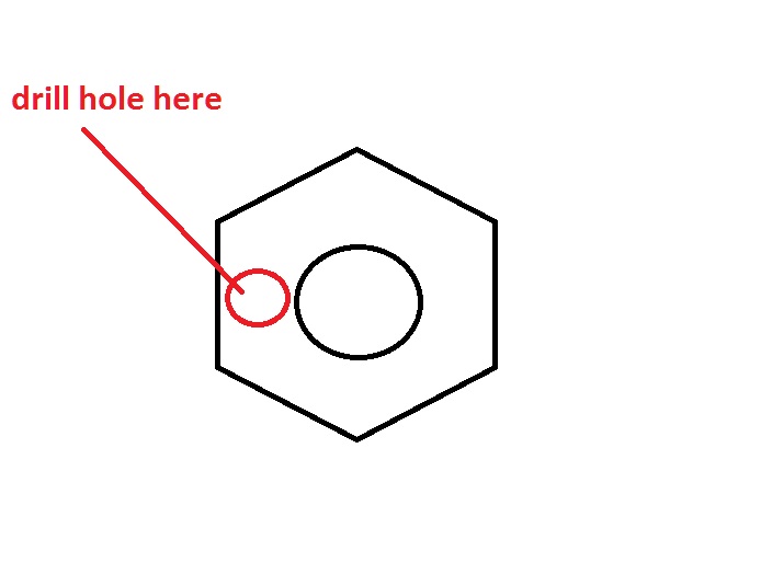

I guess you are saying there is a SPACER block bolted to the ORIGINAL STUDS and then the duals bolt to the spacer block... The NUTS on the SPACER block are counter sunk and one is rounded off ??
I think i would center punch the nut between the stud and the outer flat.. then drill a 1/4 inch hole into the nut to make it thin on the threads and flat... then drive a punch into the hole and split the nut..

Dave, could you drill a hole in the nut between the stud and the flat .. and make it big enough to almost touch the thread and flat... then drive a punch or chisel in to spread it out ?

Jay your going the wrong
way as I understand it. But I have been wrong before. It is the nut they need off . You weld on the nut it expands like you want, but will cool quick, and be even tighter. So if the first try doesn't get it your now worse off.Now broke off cap screws I will weld flat washers and nuts on all day before drilling them anymore. Because each time you weld and heat the broken part it expands and then cooling contracts it breaking the rust bond. Thing like cast iron radiator tanks I have had to weld 6 or 8 nuts on the worst. BUT THEY ALL CAME OUT and the threads were still good.And Steve were have you been my whole life. That sound good to drill and expand the hole. I have been involved with using a chisel to cut a nut. But why has no one I work with know of drilling to weaken the nut. Again never to old to learn. |
