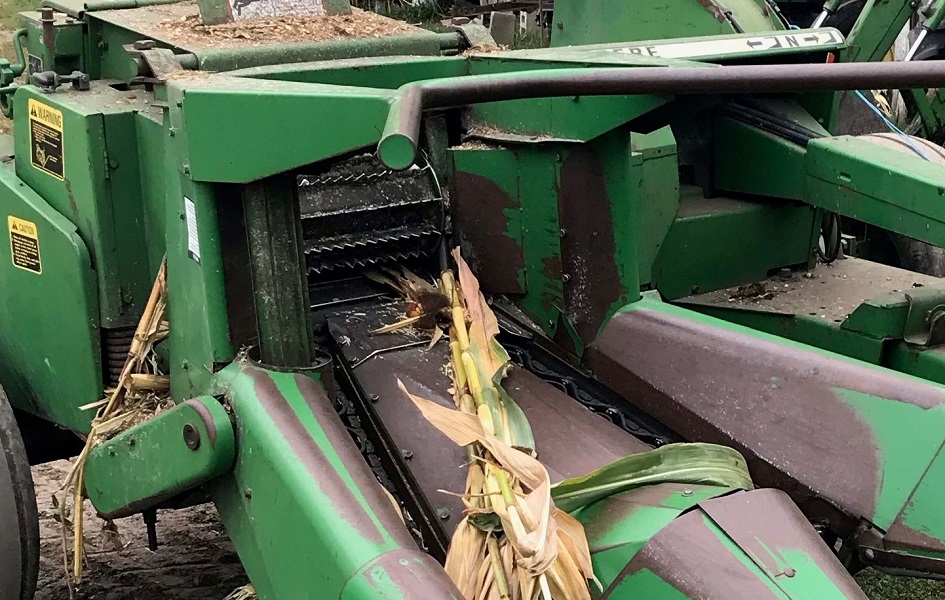

Sorry to mix Green and Orange here, but I know somebody on here has or had a Deere chopper, and don't remember who it was.....
I have a JD 3950 chopper.  I "almost" love it.  After having a Ford, Hesston, numerous New Hollands, this is my first Deere.  It is great in so many ways.  We had sorghum sudangrass 14 feet tall and thick this year, and the Allis 7045 was humming a beautiful song in harmony with that chopper just spewing it out.
The romance ends at the corn head.  That SOB just does not feed worth a crap.  It cuts it fine, and brings it up toward the feed rolls, but it stops just short of getting pulled in.  It seems from the best I can see, that it's the outside row that falls over, catches a crack or something, then just piles up.  Never shears pins or slips a clutch or anything, just sits there not going anywhere and you have to get off and help it in and then it'll go.  Fortunately it will take a helluva slug with no issue, but it sure gets old having to get off all the time.  Especially for poor 84 year old dad, who would love to help and was nice to park him in the tractor and let him drive, but instead he's off and on all the time, and that ain't exactly safe let alone desirable.
Sorry for the rant. . . .just a bit ticked....So to anyone who's ever ran one of these, did you have similar trouble and were you ever able to find anything that helped?
There was an optional "Row Trak" attachment that kept the head centered on the rows.  I think that would help, since when you're driving absolutely perfect it seems it does better.  I'm trying to track down the parts for that as a retrofit.
Any thoughts or help appreciated.  Thanks.

Does it matter what height you set the head at? Was running a Hesston one year with the head almost all the way up. At that angle the stalks wouldn't hit the rolls right and feed in. Lowered a couple inches and it did fine.
Anything rusted or have a small hole that the stalks are catching on?
Tbone95 View Drop Down
Joined: 31 Aug 2012
Points: 12208
Post Options Post Options   Thanks (0) Thanks(0)   Quote Tbone95 Quote  Post ReplyReply Direct Link To This Post Posted: 07 Oct 2021 at 7:33am
Funny you mention that, I was running it, and put the head up some, and I thought it helped so I reasoned to myself that there was less of a hill to climb so it worked better.  Yesterday, dad was running it, he said he lowered it and it helped some!  So, IDK, just random  I think?
There is a space between the header and rolls, it's how it's made.  We were talking about screwing a hunk of sheet metal or belting or something there to block it off.  We also talked about coating the area with that spray on graphite to make it slick.  It's crazy, it really is in nice condition.  I think something stupid is going on.....I was watching Youtube videos yesterday of people just hauling the mail with those choppers, they really do seam to get high regard.  Talked to the guy I bought it from yesterday, he said check the "smooth roll".  Which , I will, but I don't see how that's the problem because it seems like the corn doesn't make it that far.

did you buy the base machine and the head together? I have always ran green choppers and have never had the issue you are refering to. On a head that is used on a 3940-3950 there is a triangle filler plate on each side of the corn head chaneling corn to the feed rolls. 3960-3970 and older machines do not have or need this. You could have an older head or head off a wider chopper. This would let stalks catch on the sides. Are your belts in time and in good condition? How good and how close are the cut off knives on the head? I would set mine up so they would cut paper. All of the above make a difference when feeding. You can add homemade filler plates to the wider head or buy them from Deere. Is the up and down roll on the head turning? The Deere head does take a fair amount of upkeep to work great. I have a friend that put a New Holland 824 on his 3950 and if I still milked cows and chopped lots of acres I would consider that as well. Also a Deere wide row head does not like 36 inch rows real well.
Joined: 31 Aug 2012
Points: 12208
Post Options Post Options   Thanks (0) Thanks(0)   Quote Tbone95 Quote  Post ReplyReply Direct Link To This Post Posted: 07 Oct 2021 at 11:35am
Tom, thank you.  By your description, I would say the triangular filler plates are there.  I bought the chopper and head from the same guy/ same time.  My understanding of these, the older units were yellow spout and yellow head?  I have a green head and was told that means it's newer.  And it is definitely a 30 inch head and 30 inch planted.  The spinner on the head is spinning.  Dad and I commented about why they only put a spinner on the outboard side, maybe one inboard would be helping as it's always the place where the corn piles up.
The belts aren't perfect, but I thought were serviceable.  In time, one's rise should be in the other's valley, correct?
I believe the cut off knives are good.  I don't have a book for the head.....is there a clearance spec I can check?  Cutting paper must only be a couple thousandths, or even "0".  No issues cutting, it seems it "falls over" before it gets to the rolls, then it doesn't go on in.

You have the right head for your chopper. I just went out to the shed and looked at mine. 3940 with a green 2 row wide head. There is a flat piece of metal that extends behind the back of the belts that is to chanel the stalk to the rolls. Is this there? Is is bent or twisted? I just saw that mine is bent up and that could be a place for stalks to hang up. My belts are bad so my head needs to spend some time in the shop this winter. Tom

Thank you again Tom.  This flat metal.....would I see that best from underneath or on top?  I just got this chopper last year, nearly done with corn when I did because my NH finally died it's last death.  So not super familiar yet.

You will see it from the top. I think it is part of the wear strip that bolts in behind the belts. It almost touches the lower feed roll. If this would be bent or missing stalks might jam up. Hope this helps as I am going to be away for awhile. Tom

  Shouldnt that flat piece of steel in the middle of the rows be on top of the shorter one right in front of the top roller, ya know so the corn slides in and doesnt catch??????
  Your belts look in excellent shape to me.
Ya, I thought the belts looked good.
As for that piece, I see what you're saying, it should be more sort of a shingle effect.  I can confirm this is the way it was when I got it.  I'd have to go look, but seems to me the similar piece on my NH with 824 head is the same as this.  I think it helps hold that big piece in place better, since there's 4 bolts in close proximity.

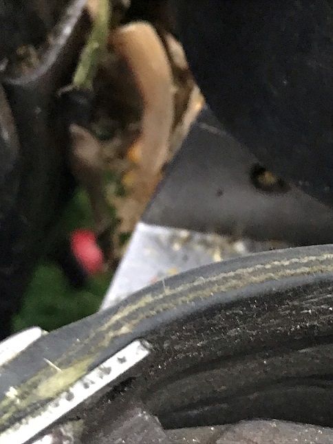

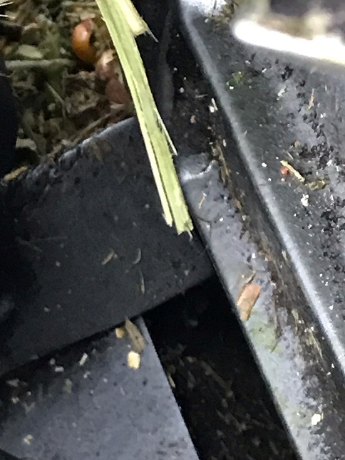

Post Options Post Options   Thanks (0) Thanks(0)   Quote Tbone95 Quote  Post ReplyReply Direct Link To This Post Posted: 08 Oct 2021 at 9:22am
Tom, I think you called it!
I think you are talking about this piece, outboard photo:
And wouldn't you know it, inboard photo:
There's a piece missing and an open bolt hole!
Makes sense to me.  The guy I bought it from insisted it's the smooth roll, but in my mind the issue occurred before it got there, and after the cutting knives, and this would explain it.  Also, chopper worked amazing in the sorghum with pickup head, no feeding issues at all, so a corn head issue makes sense.  We'll be fixing this and see what happens.
Tom, steaks and pops of your choice on my deck if you ever swing through Michigan. (especially if this works!WinkLOL)

Post Options Post Options   Thanks (0) Thanks(0)   Quote tomstractorsandtoys Quote  Post ReplyReply Direct Link To This Post Posted: 08 Oct 2021 at 4:26pm
Glad I could help otherwise you might get rid of a good chopper and assume Deere choppers are no good. You made mention of having a NH 824 head. I would check into getting the bracket to put that on your Deere chopper. The Deere chopper is very good but with the Deere corn you need to really stay on the row good. Friend did it to his 3950 and says he would never go back to a Deere head. He did say in extreme down corn the Deere head might get under it a little better. I only chop a few acres now for the beef steers but if I ever find a steal of a deal on an 824 I plan to do it as well. Tom
