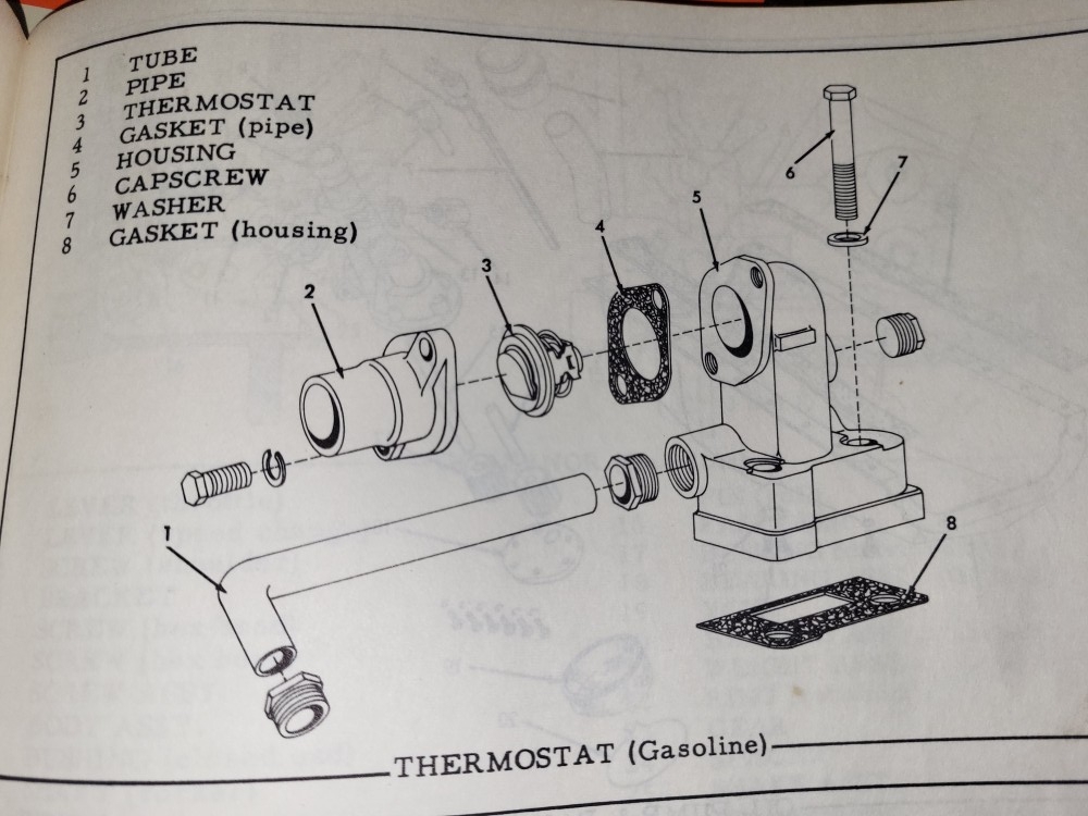

UPDATE: Need to source a Water Tube, bypass for thermostat.
Doe's anyone have a source for this part?  1963 D-19 Gasoline Engine.
This tube is hard metal, with compression fittings on both ends.
Is it shown on page 67, of the D-19 Operators Manual, as Item #1 (shown in photo below).
Have a new Radiator, and rebuilt Water Pump ready to install.

Post Options Post Options   Thanks (0) Thanks(0)   Quote WeisAC2 Quote  Post ReplyReply Direct Link To This Post Posted: 04 Feb 2026 at 3:35pm
Alex at A&W tractor was able to make one recently for my D15 diesel.  It fit perfectly.
