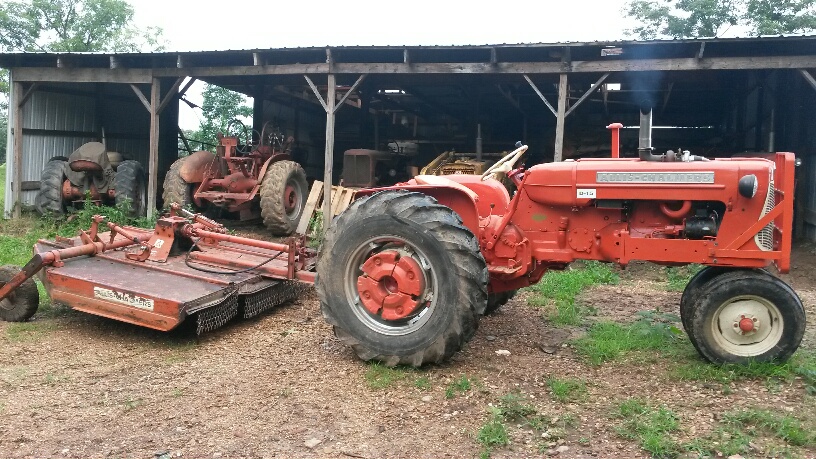

Randy from Mo. fabricated one and had it at Boonville . I will try and find a pic tonight and post it

Randy had me rebuild the turbo for the D15 over a year ago and have talked to Randy about how it's doing four or five times and it's A-OK. He works this tractor day in and day out and it's not a show toy, he mows a lot with it.
