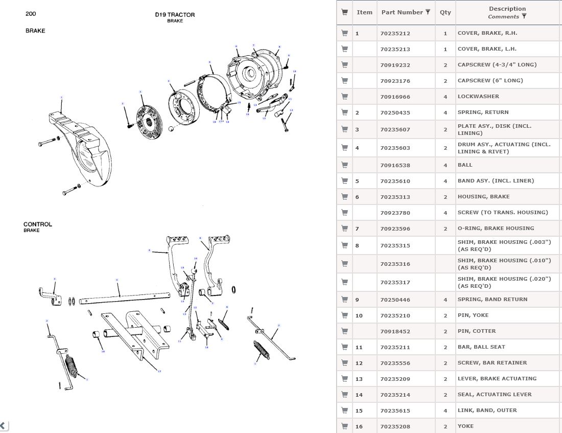

Maybe this will help.

Post Options Post Options   Thanks (0) Thanks(0)   Quote T-bone_indy Quote  Post ReplyReply Direct Link To This Post Posted: 01 May 2020 at 9:05am
Thanks for the diagram!
I pulled the cover and inspect the brake shoes and apply the brake and it looks to be functioning as it should.

I can't read the numbers in the picture but the drum assembly that goes inside the drake band has 3 balls in it. Don't remember if they are 3/4 or 7/8 diameter. When you step on the peddle you contract the band against the drum the balls roll up grooves that are tapered like a ramp to push the drum out against the brake disk.

The balls are between the drum (item 3) and plate (item 4). They are held together by 4 springs (item 2). If the linings on the plate and drum are too thin, the brake will lock. You can usually unlock them by backing up.
Points: 22098
Post Options Post Options   Thanks (0) Thanks(0)   Quote DrAllis Quote  Post ReplyReply Direct Link To This Post Posted: 01 May 2020 at 7:21pm
Four balls per side. Two drum return springs per side. D-19's were the worst for this hanging up problem, New disc lining, clean balls and pockets with some grease or anti-sieze helps. New return springs are a must. Machining off the cover so it doesn't allow the drum to expand so far is best, if you can find someone to do that. You can get as tight as .030" running distance between the disc lining and the wear surface and it will be fine. Book spec is .045" minimum.
