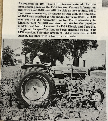

I'm not buying the story on the D18 pictured as being the real deal. There's several things that are not correct. The big one is the front axle. The D18 prototypes have the D19 heavier front axle. The one pictured has a D17 front axle.

Allis built a prototype d18 during the development that would eventually lead to the production of the d19. Building one would be a neat endeavor for an allis enthusiast who has the time and resources and would be a good conversation piece at shows. Kinda like the red guys that build Farmall HTAs.

The production D-19 was released in December of 1961. It indeed had
 the more modern looking and rugged wishbone on the front axle.  I'd like to think the D-18 proto tractor(s ?) would have been field testing in late 59? and surely thru 1960 ??   and maybe the actual D-19 proto's were only tested thru the 1961 year time frame ?    Well, I have a piece of Series 2 D-17 advertising literature. The printing date was Oct of 1960. It has cream wheel centers. Persian orange #2 is the color and a horizontal mesh screen grille, painted cream. Hood has the riveted on Allis-Chalmers emblem plates. It clearly has the old style wishbone front axle. According to AGCO parts books it appears that old axle design stayed on the D-17 until the series 3 models in 1962.  I guess what I'm trying to say is, the D-18 probably did have an early design D-17 front axle under it. Swinford's book makes reference to the D-18 with the short D-17 hood and raised up fenders didn't look rugged enough. The front axle wouldn't have looked rugged enough either, so the real D-19 got a change. I'd sure like to see the S/n on the rear end of the D-18.
Points: 22307
Post Options Post Options   Thanks (0) Thanks(0)   Quote DrAllis Quote  Post ReplyReply Direct Link To This Post Posted: 22 Apr 2025 at 10:58am
I've been shown a picture of another "D-18", which was clearly built after the one pictured above. It actually has D-19 size hoods (taller to fender height), larger fuel tank, and a D-19 looking front axle (taller cross tube and gussets on the spindles) with the nicer looking wishbone. The taller hoods not only made it look like a bigger tractor, but it allows for a larger/taller fuel tank AND A TURBOCHARGER under the hood, which is what they decided to do late in the testing program to get closer to the 70 HP mark. But, the model designation was still D-18, albeit a different D-18 than the original as shown in Swinfort's book.  So, this picture of a later proto version with the taller hood and heavier front axle may not be another proto ?? It could be the first D-17 hooded tractor re-worked for the turbo D-262 engine !! How many proto's did they build ?? Well, in the case of the One-Eighty gas....ONLY ONE !!!

Here are a few past AC forum links to the D18 discussion & their interesting notes.
A 2010 thread "the-ones-allis-chalmers-did-not-build." In it, TedBruisherN.IL mentions that maybe 4 prototypes were built? Lonn shares about D18's hood height.
There are still a couple of D18 photos shared in this 2010 thread. http://www.allischalmers.com/forum/c-h-wendel-book-d18_topic6947.html
Below, I copied this D18 tractor & front row cultivator photo, along with it's write-up from CHWendel's The Allis-Chalmers Story, page 328.
Heres a link to a 2012 Southeast North Carolina Ag Show's D18 photo http://www.dreamstime.com/royalty-free-stock-images-allis-chalmers-d-18-farm-tractor-image26634029
Heres another link to a D18 photos at the 2014 NC Festival Raleigh.  http://www.flickr.com/photos/27796688@N08/14115442197/in/photostream/

I think the one at the North Carolina Ag Show is the same one from up above. It appears the left hood has some damage to it. I thought it was just the glossy paint, but now I'm not so sure.
