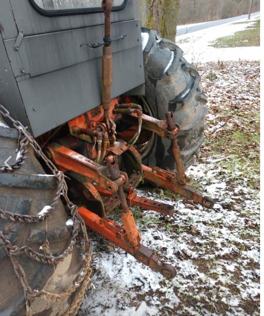

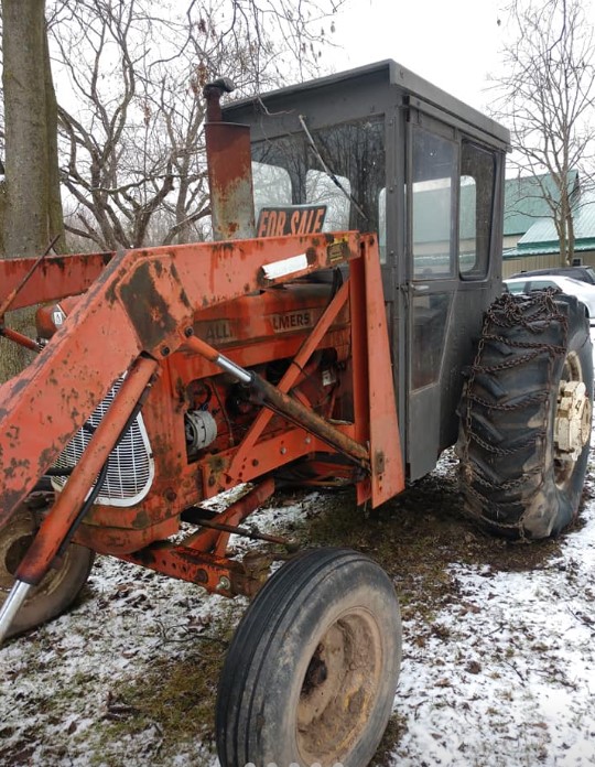

Looks like a Series IV with a D19 3pt back end? Has loader, runs. with wheel weights.
$3.5K.  Should I?

Dont think it is, but current owner said the previous owner told him it had a "D19 rear axle"  which means?

Which means, he doesn't know what he's talking about. I can't see everything, but if it has 28 inch rear wheels, it ain't no straight axle D-19 rear end. Looks like a series 4 D-17 what I can see.

Looks like our IV rear end too.

Like Doc says anyone that knows anything about Allis tractors can plainly see it's a D17 series iv with factory 3 pt. A D19 has a straight axle, all you have to do is look!!

well if you dont know what to look for, looking aint going to do much.  He clarified and said it was the actual internal axle that was from a D19.
Anyhoo I await some more pics of whats behind the homemade cab. Might look at this Saturday.

Looks decent, Loader has a patch on it; has double pie weights on the rears.  Said everything is operational.

I don't like the cab but if it runs it's worth the money around my area anyway.

Maybe he means a D17 with the factory 3 point lift off of a D19

Final drives against wheels

$1000 or less mess of a cab and no fenders.

$1000 worth of weights on it.

It doesn't matter what it's supposed to be, look at the serial number and that identifies what it actually is!
Find out if the guy has the fenders, they might be in pristine shape.  I think I would look over those from rims close, it might need new ones if they are cracked from loader use.  Why is there only one tire chain on it?  Why does it have a new bolt and nut in the front axle?  Does it fall out of any gear?  Does the big stick work as it should?  How are the rear rims around the valve stems?

D-19 3-point hitches don't bolt up to a D-17 IV- 170-175-180-185. They are a couple inches too wide and bolt pattern is different.

I don't see anything that looks like D19.        MACK
