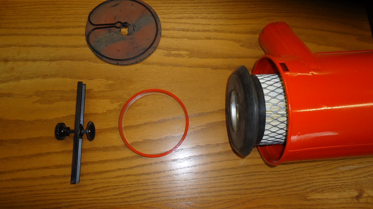

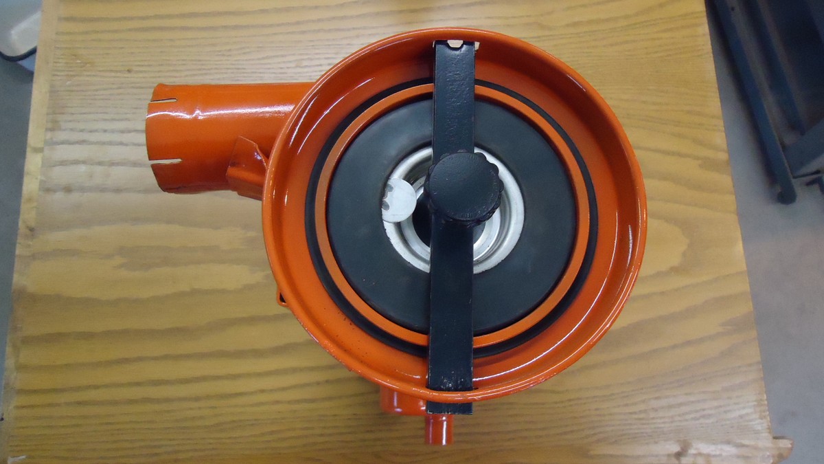

It's been many years since restoring my D17 Diesel and ran into the same problem.
Here's what I did to keep the design as close to original as possible.
Made a steel ring that fits over the rubber boot and sticks up a bit so that the cross-bar holds it tight.
The cross-bar has a tightening screw that bears down on the end of the filter.
I no longer have the tractor, and don't recall the exact dimensions.
