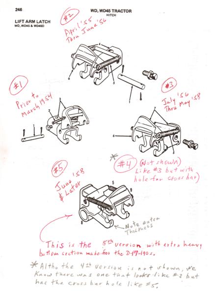

Snap-Coupler latches over the years.
HD Snap-Coupler Latch (#5) It has a lot more "meat" than any of the earlier versions.
