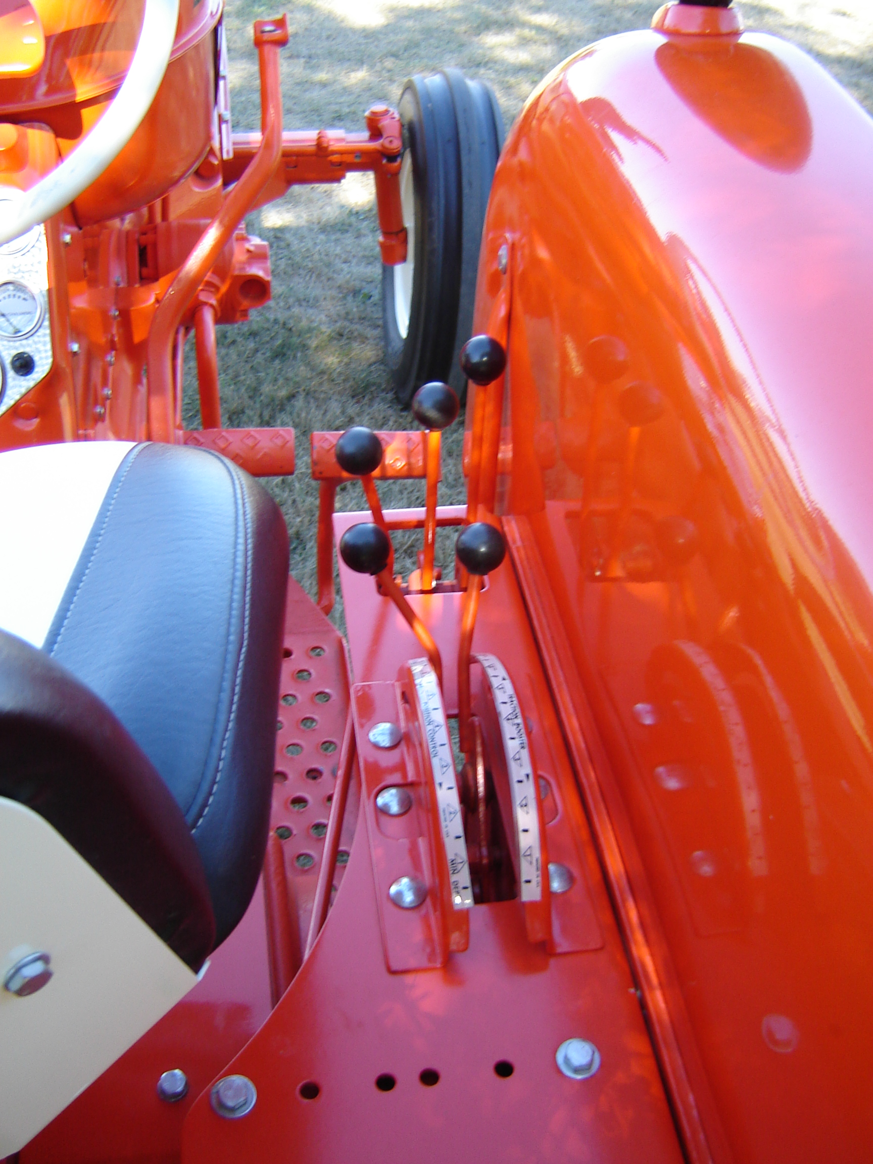

A legit series 4 has a bank of hydraulic levers to the right of the seat. It also has two external lift arm cylinders about 3 inches in diameter. No other D-17 series has these features. Yours has two levers on the left side of the steering wheel, correct ?? That makes it to not be a series 4.  S/n 28903 stamped on the left side of the clutch bell housing makes it a very early 1960 year and a series one. Engine knocking problems and repair parts are pretty much the same thru all ages of D-17's and I assume it is a gas NOT a diesel ??

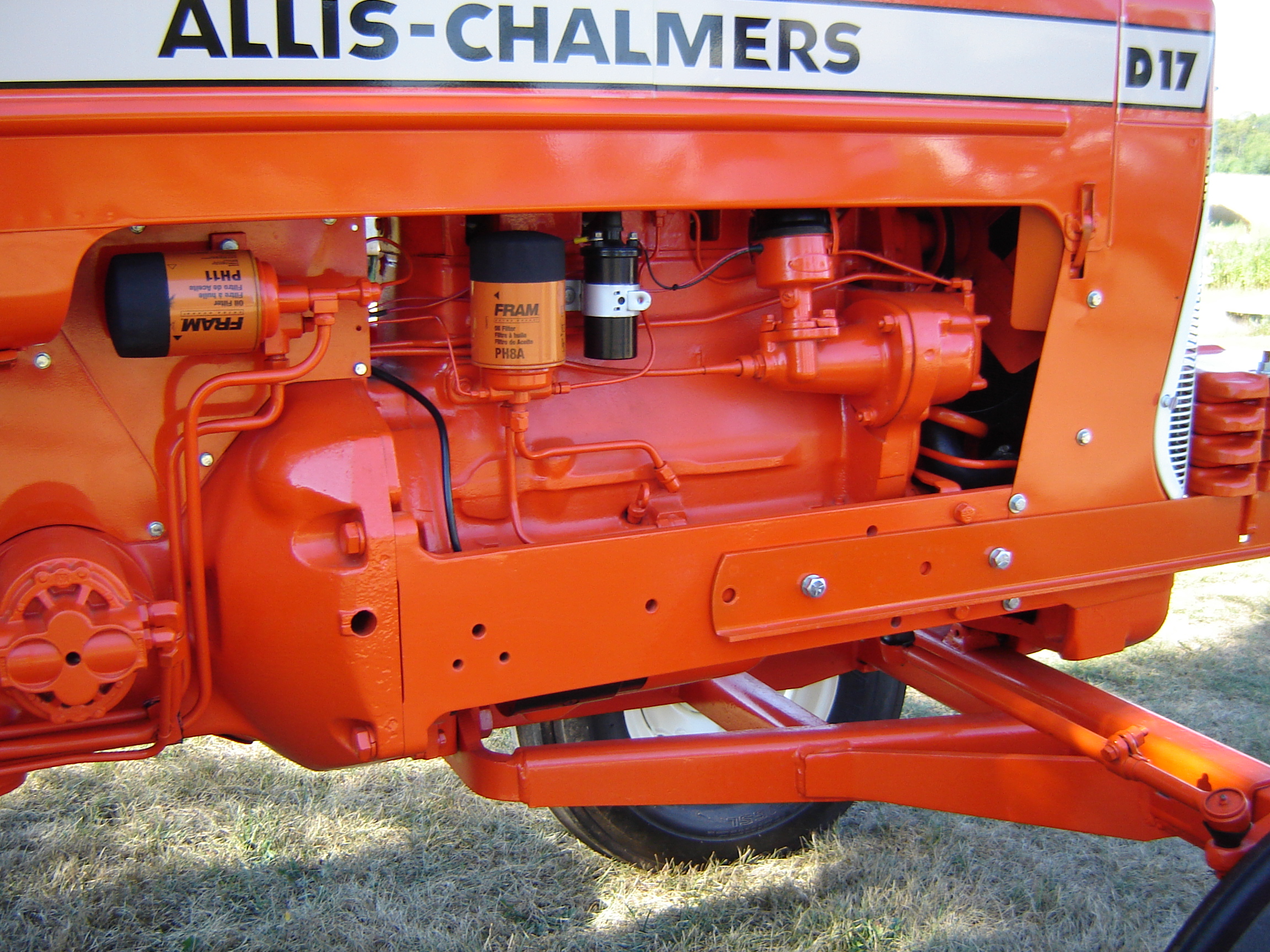

A lot of people put series 4 decals on tractors that are not series 4.  True series 4 tractors have a side mounted hydraulic pump (below the fuel tank).  Earlier series did not.  No major changes in the engines throughout the D17 production run though.

Memory tells me the full-flow oiling system began at chassis s/n 24001 which is late 1959.   Dseries4, that is a gorgeous D-17 IV  !!!!
