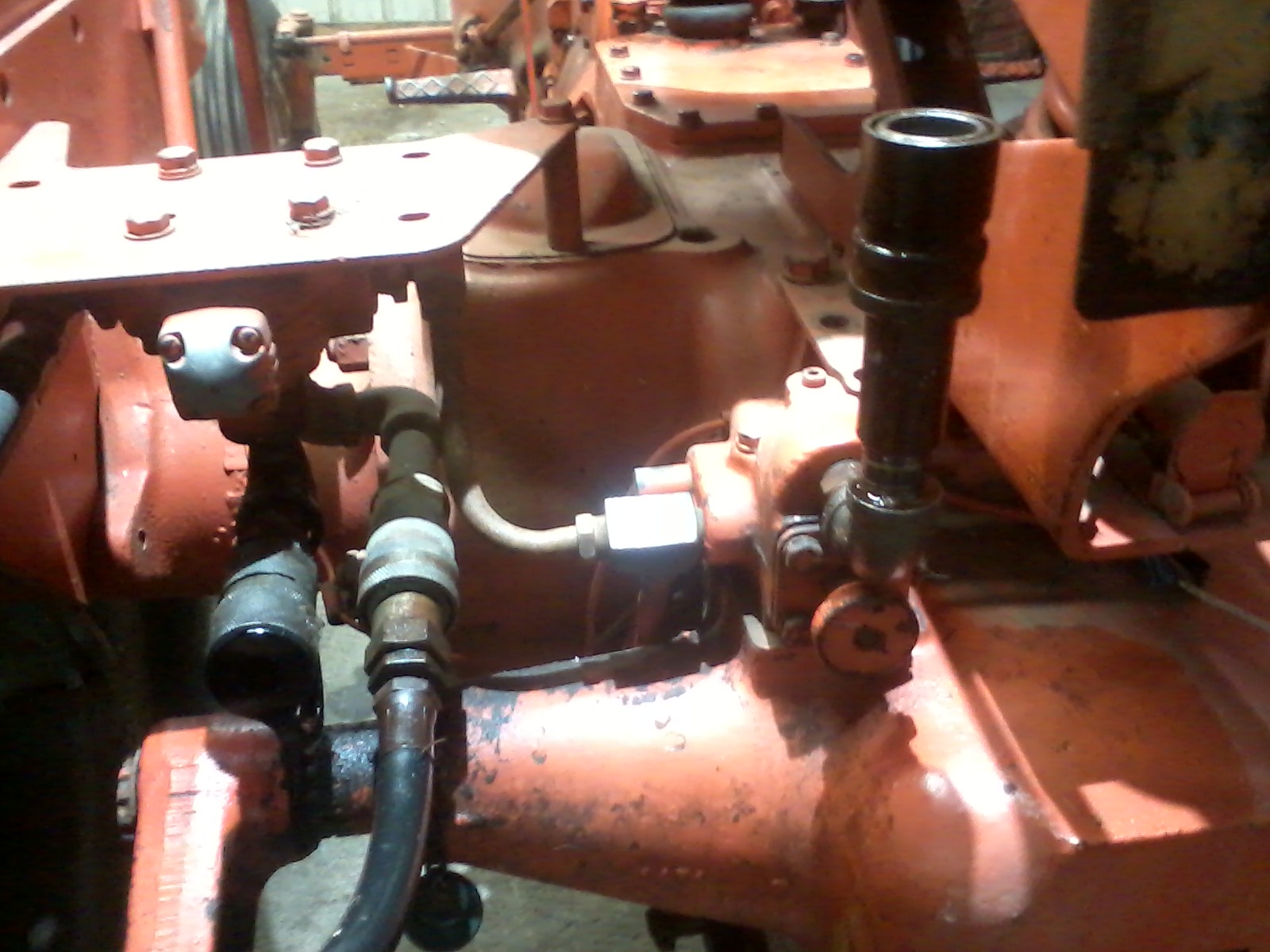

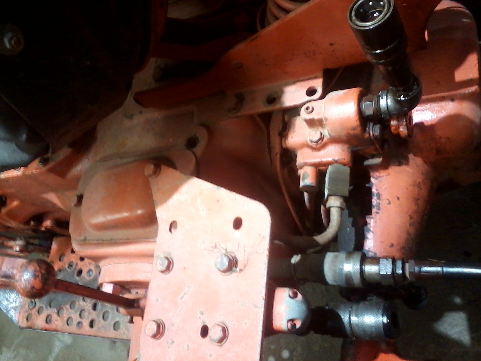

I have recently gotten a D17 I believe a series IV and the lift arms will lift a mower and a 9' rear blade but will not lift my plow. The arms do drift down very slowly. I am thinking the internal lift cylinder packing/seals and or the hose going to the cylinder. Did the hose and cylinder when I was a kid on our D15 series II with my dad. Don't remember a whole lot about it. Is it a horrible job to do if that is the problem? Any help would be greatly appreciated!

You say there is "a control valve/lever on the left rear by the remotes". Remotes to me means more than one coupler, and a D-17 of that age only has one coupler, not two. So, I think you have an operational problem, a two-way valve and/or the previous owner has it plumbed up wrong. If you aren't losing hydraulic fluid and gaining transmission oil, there isn't a problem with a hose or seals internally !!! A picture would be very helpful.

There are 2 disconnects on a valve with lever. To the right is a single disconnect. I think someone put the second one on the left, not sure.
Points: 22307
Post Options Post Options   Thanks (0) Thanks(0)   Quote DrAllis Quote  Post ReplyReply Direct Link To This Post Posted: 02 Jun 2016 at 4:54pm
Now, that we have established there actually is an "added-on two-way valve" (non-factory), how do you make your lift arms raise??????? Are you activating this lever on the added-on valve and then the arms lift up??

Problem Solved!!!! The hose was hooked to the disconnect on the right. So I unplugged it and just plugged in to the middle disconnect, just to keep it clean and it works perfect! Thanks so much to everyone for their time and effort!!
