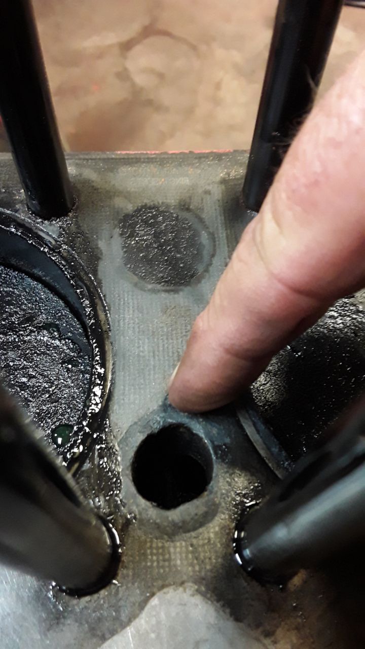

Post Options Post Options   Thanks (0) Thanks(0)   Quote randy Quote  Post ReplyReply Direct Link To This Post Posted: 03 Sep 2020 at 7:56am
Dr, there is the hole

Post Options Post Options   Thanks (0) Thanks(0)   Quote randy Quote  Post ReplyReply Direct Link To This Post Posted: 03 Sep 2020 at 5:52pm
The hole in the top of the block is what i am most concerned about. And yes, the sleeves are flush.
