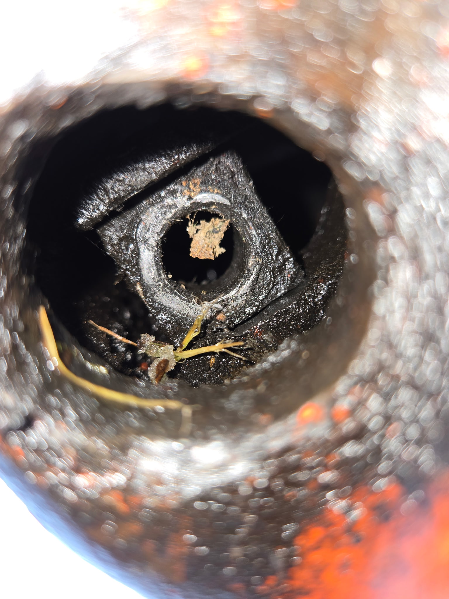

Post Options Post Options   Thanks (0) Thanks(0)   Quote WD45 Aaron Quote  Post ReplyReply Direct Link To This Post Posted: 05 Jan 2026 at 7:44pm
Ok, we're getting somewhere. It appears that the threads on the rod are fine, just full of gunk and need to be cleaned. The nut on the fork appears stripped out. I might look at work and see if we have a helicoil kit for 1/2-20. Otherwise, I can make a threaded insert on a lathe and fit it into the nut.

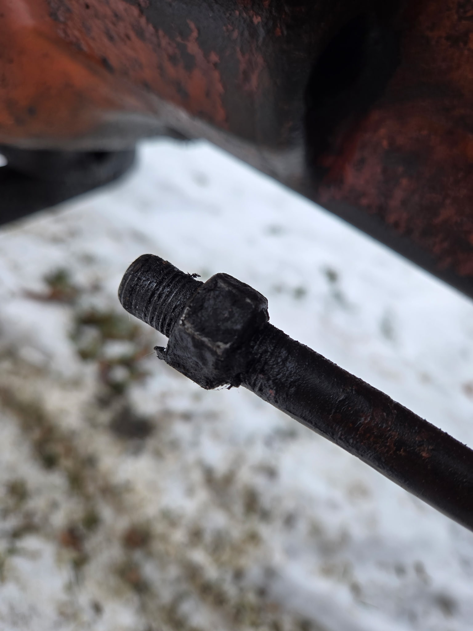

Post Options Post Options   Thanks (0) Thanks(0)   Quote DrAllis Quote  Post ReplyReply Direct Link To This Post Posted: 05 Jan 2026 at 8:38pm
There's been a problem going on there for a long time. First off, that looks like 1/2" NC threads not NF threads. Second, someone has put a stop nut on the rod to keep the rod from pushing thru the internal nut, which is worn out. Good luck with whatever you try.
Points: 54824
Post Options Post Options   Thanks (0) Thanks(0)   Quote DiyDave Quote  Post ReplyReply Direct Link To This Post Posted: 05 Jan 2026 at 8:55pm
Likely rethreaded the original fine threaded hole to coarse thread.  starts you out at a disadvantage, as you get a sloppy mess, when you do it that way...Thumbs Down

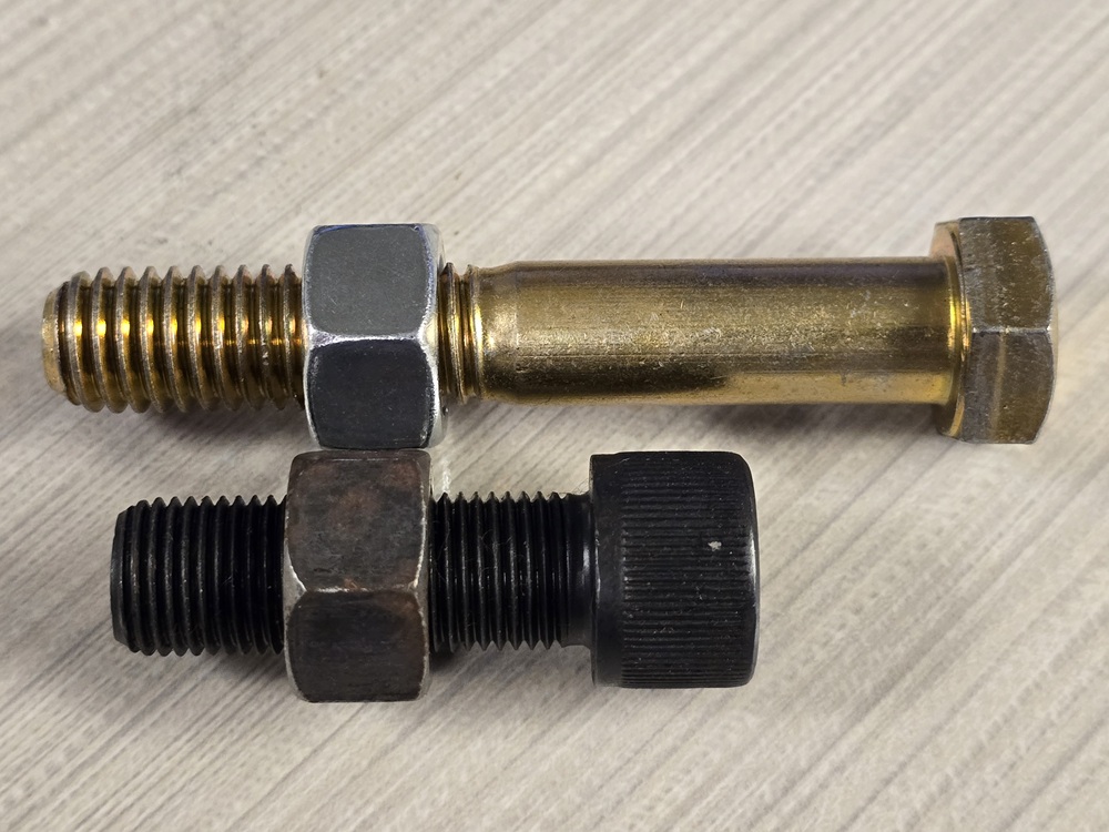

Post Options Post Options   Thanks (0) Thanks(0)   Quote Nathan (SD) Quote  Post ReplyReply Direct Link To This Post Posted: 06 Jan 2026 at 8:24am
You got 10 threads on the roughly 1/2 inch sticking past the nut. That is fine thread on the rod.

Post Options Post Options   Thanks (0) Thanks(0)   Quote WD45 Aaron Quote  Post ReplyReply Direct Link To This Post Posted: 06 Jan 2026 at 11:40am
I grabbed a coarse as well as fine thread bolt with nut from the shop. In my picture of the clutch rod I count 10 threads past the nut (not counting the chamfer lead). I threaded each nut out the same number of threads. I agree, it appears to be fine thread.
