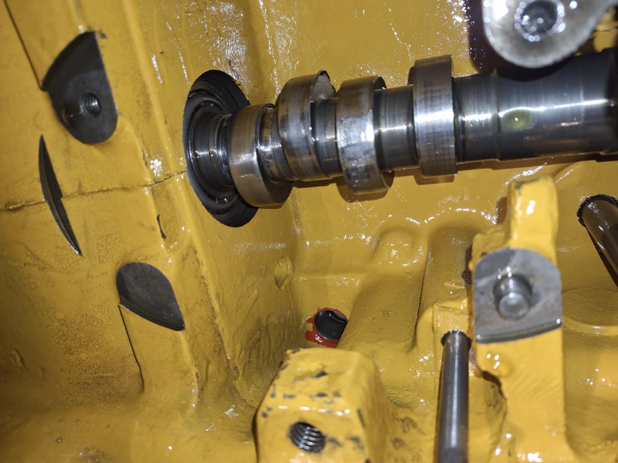

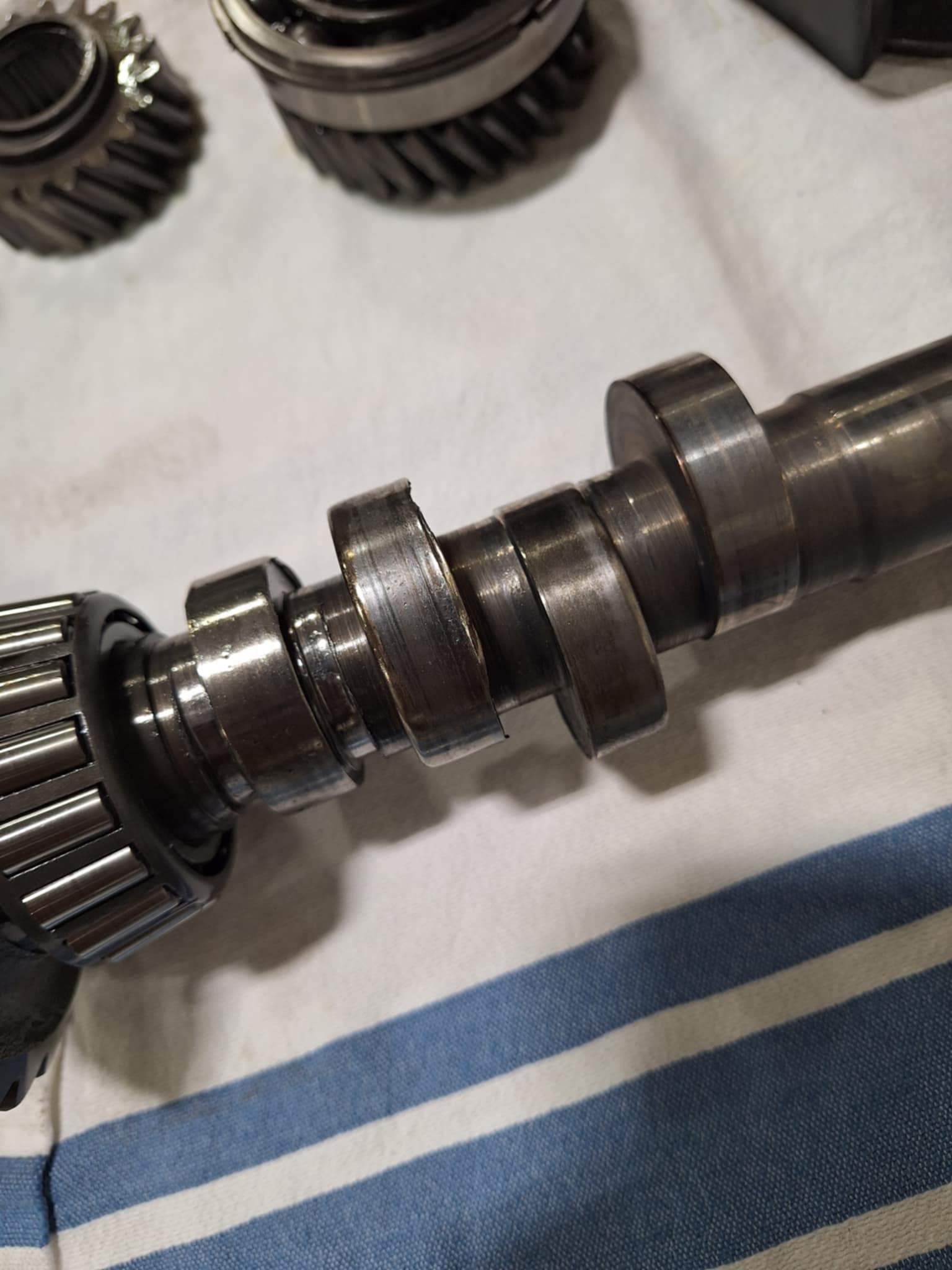

1. clean off the burr on the cam, by whatever means you can.  I have bumped the starter, with the plugs out, while an assistant held a strip of emery cloth against the cam.  Cam does not look extremely bad.
2.  while you have it down, r&r the internal cyl lift hose, in back,  if it ain't bad, it will be soon...Wink

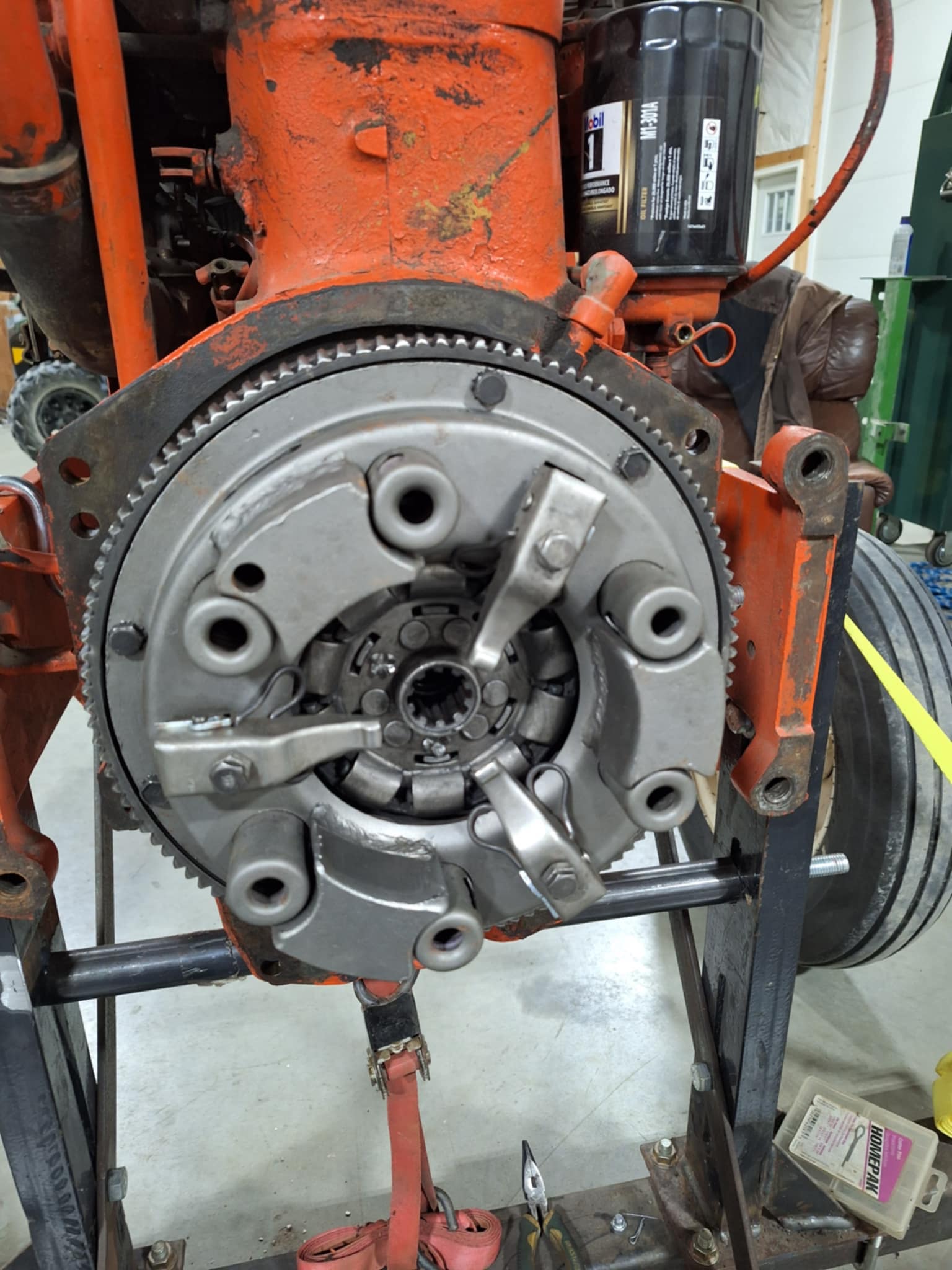

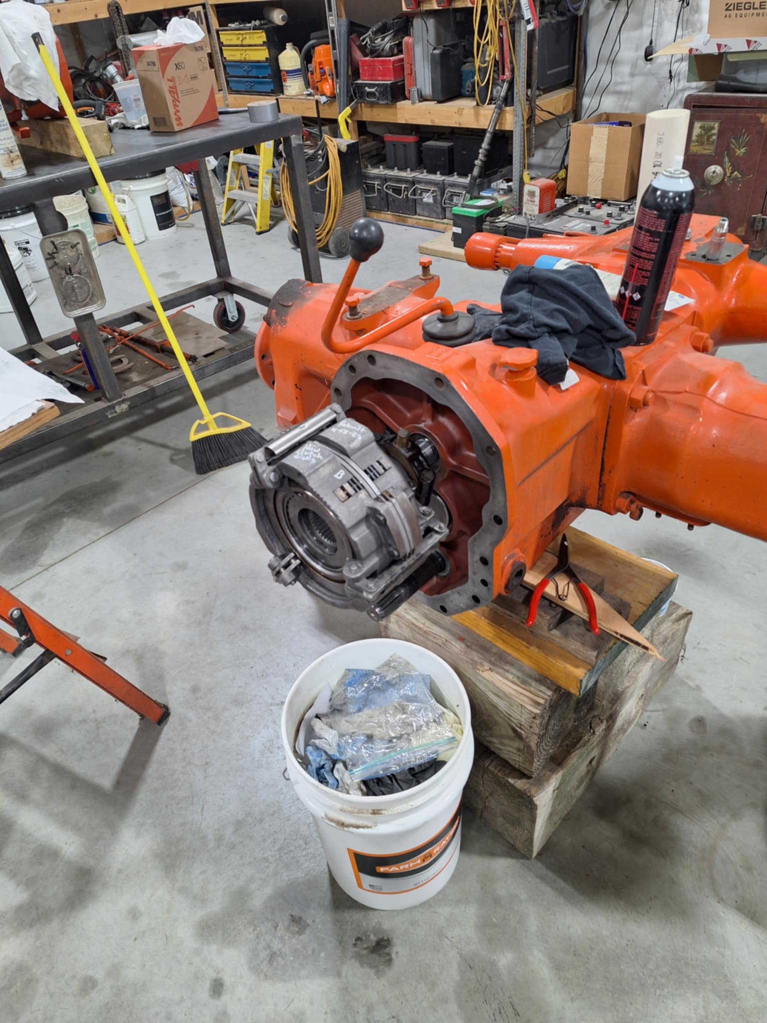

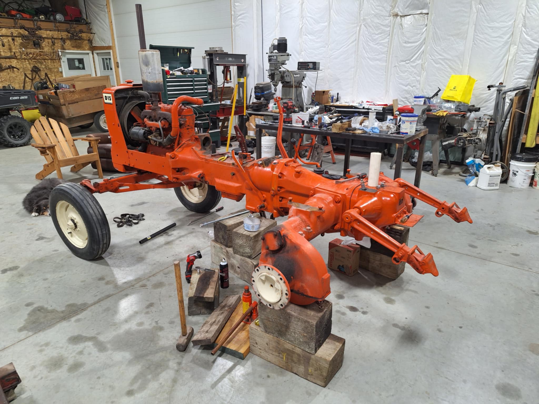

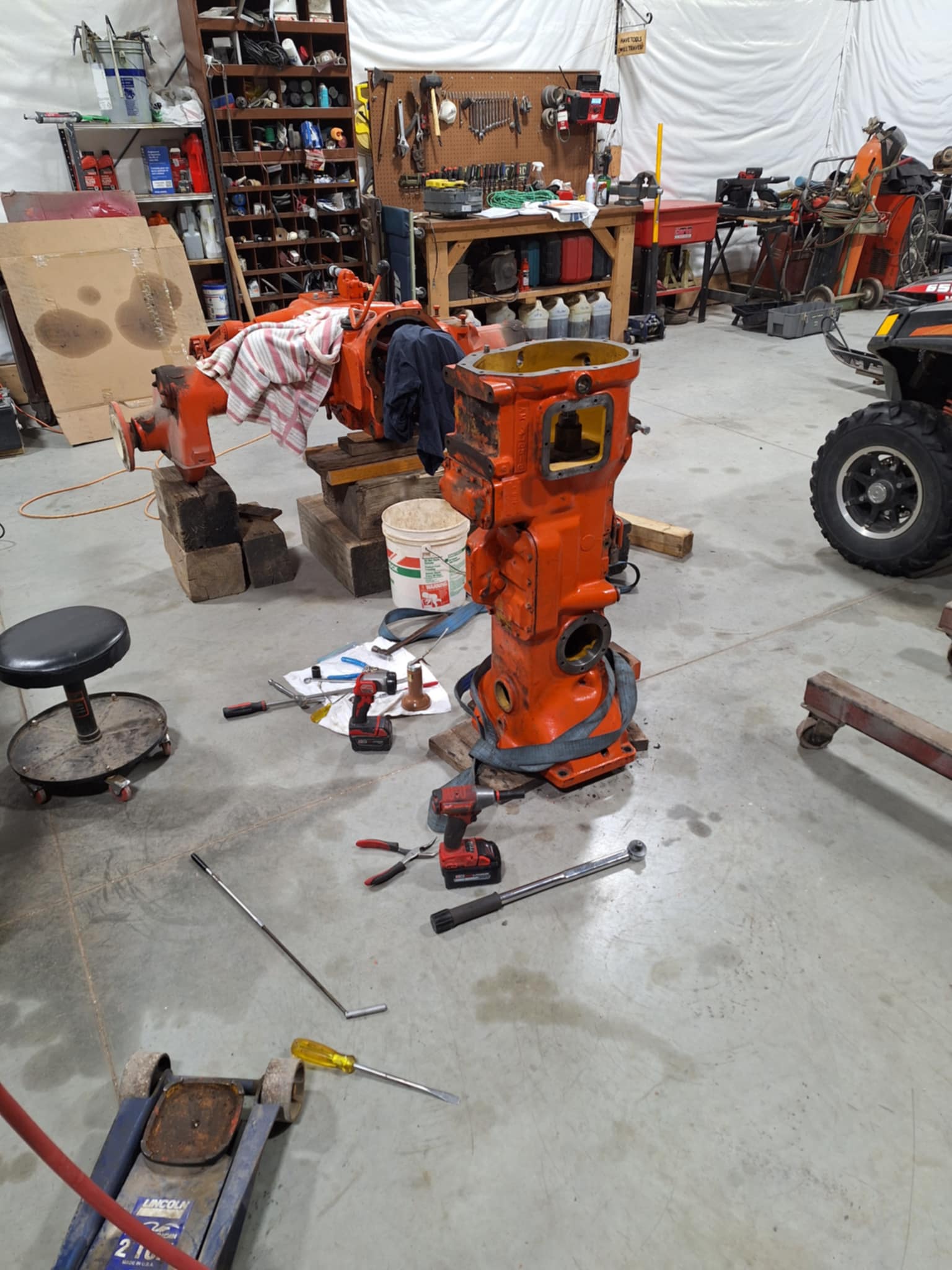

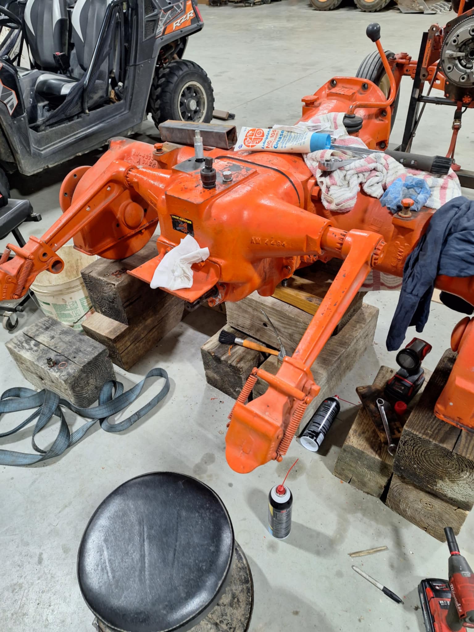

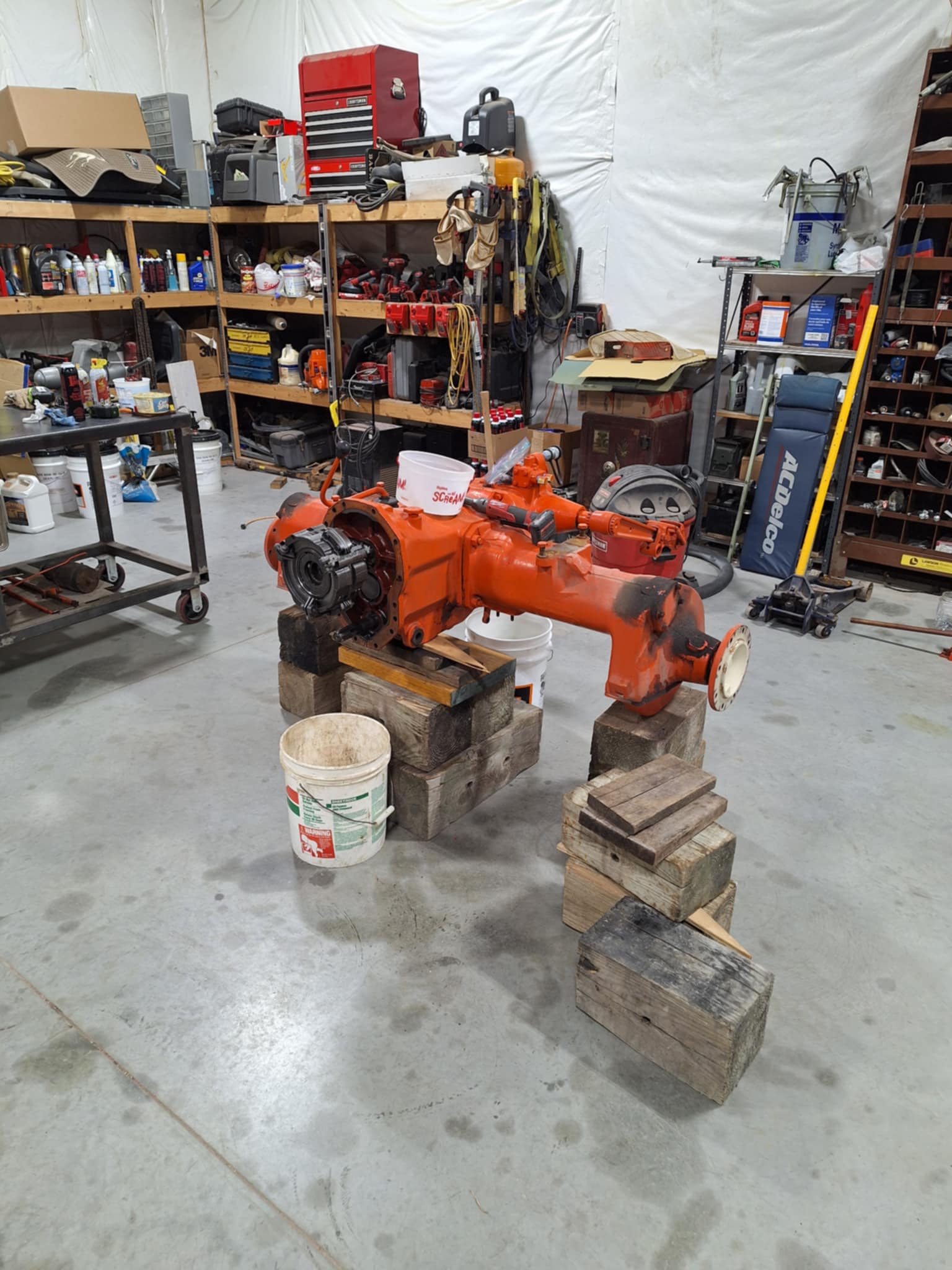

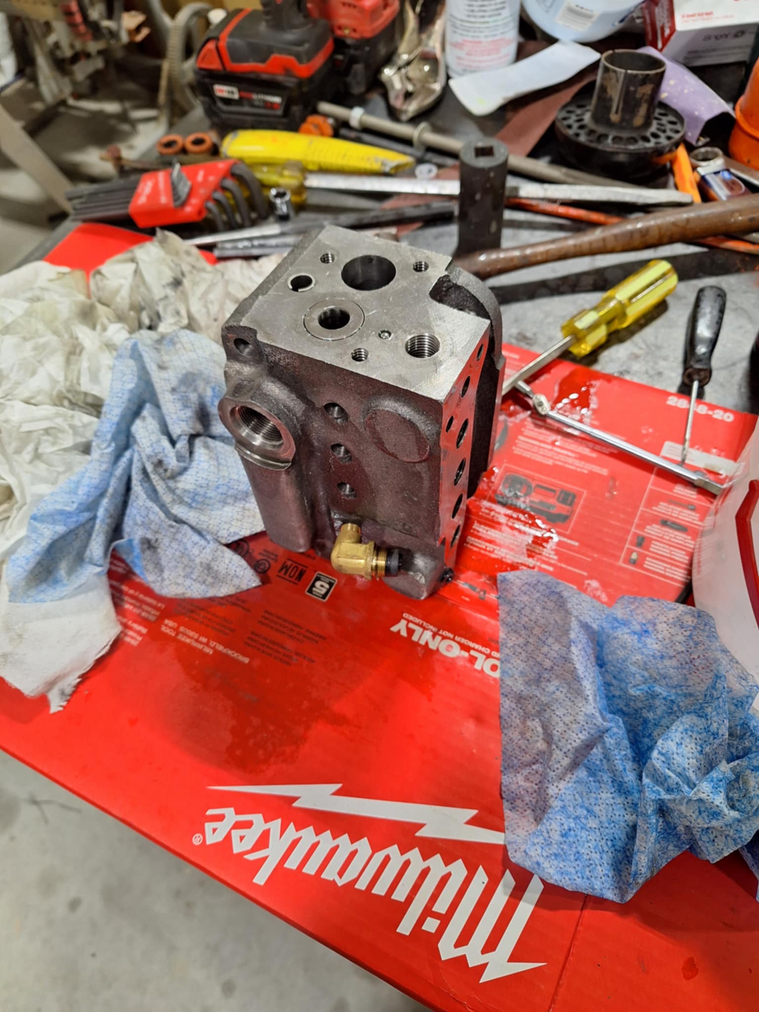

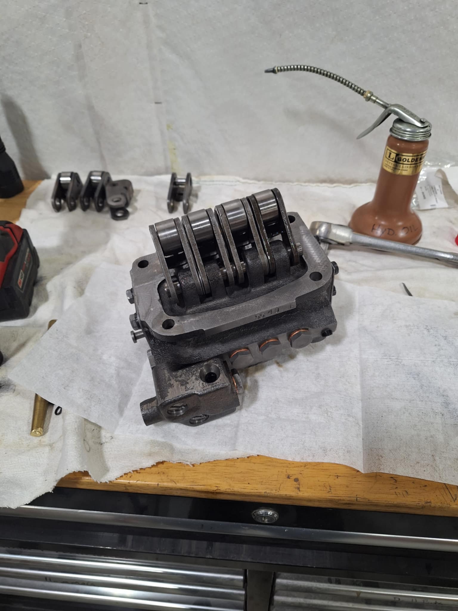

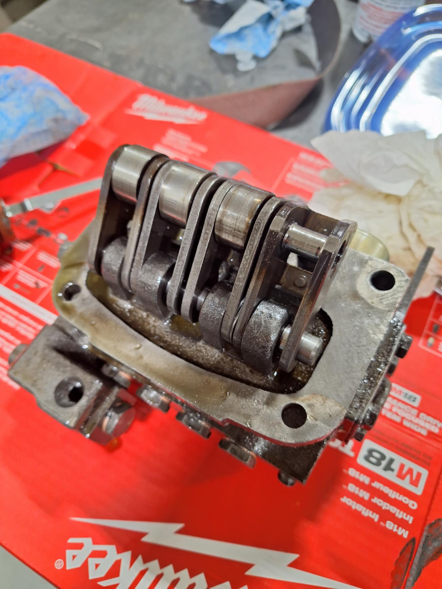

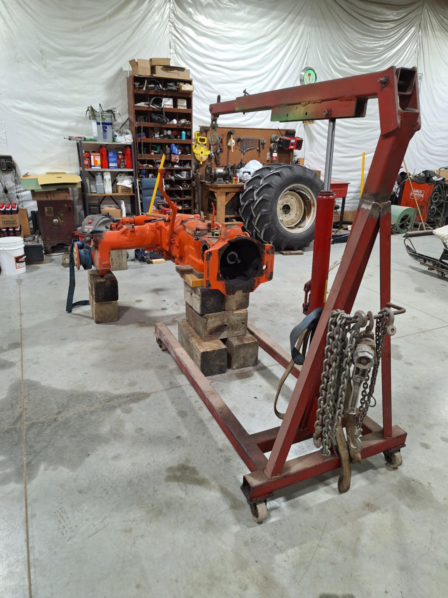

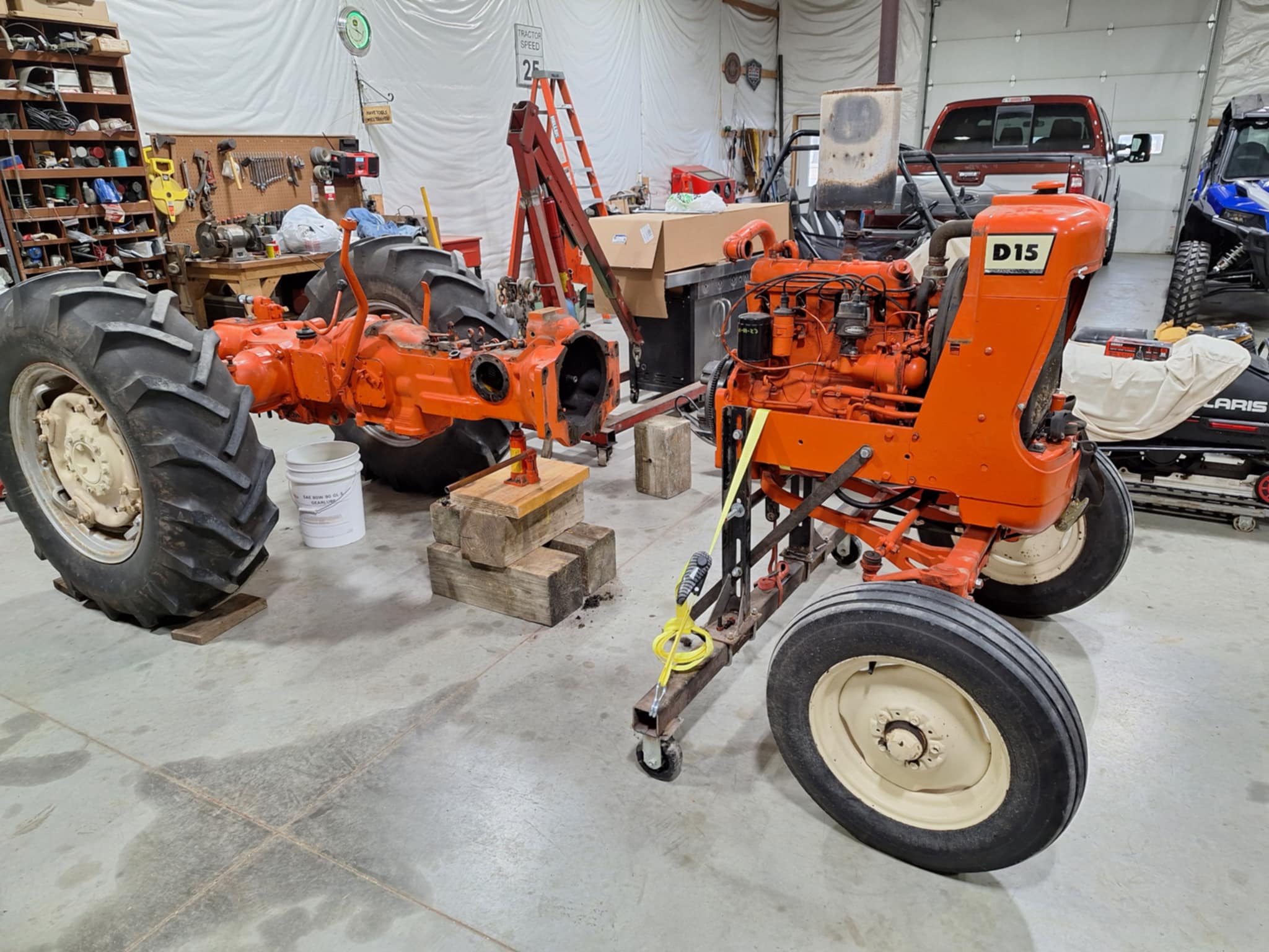

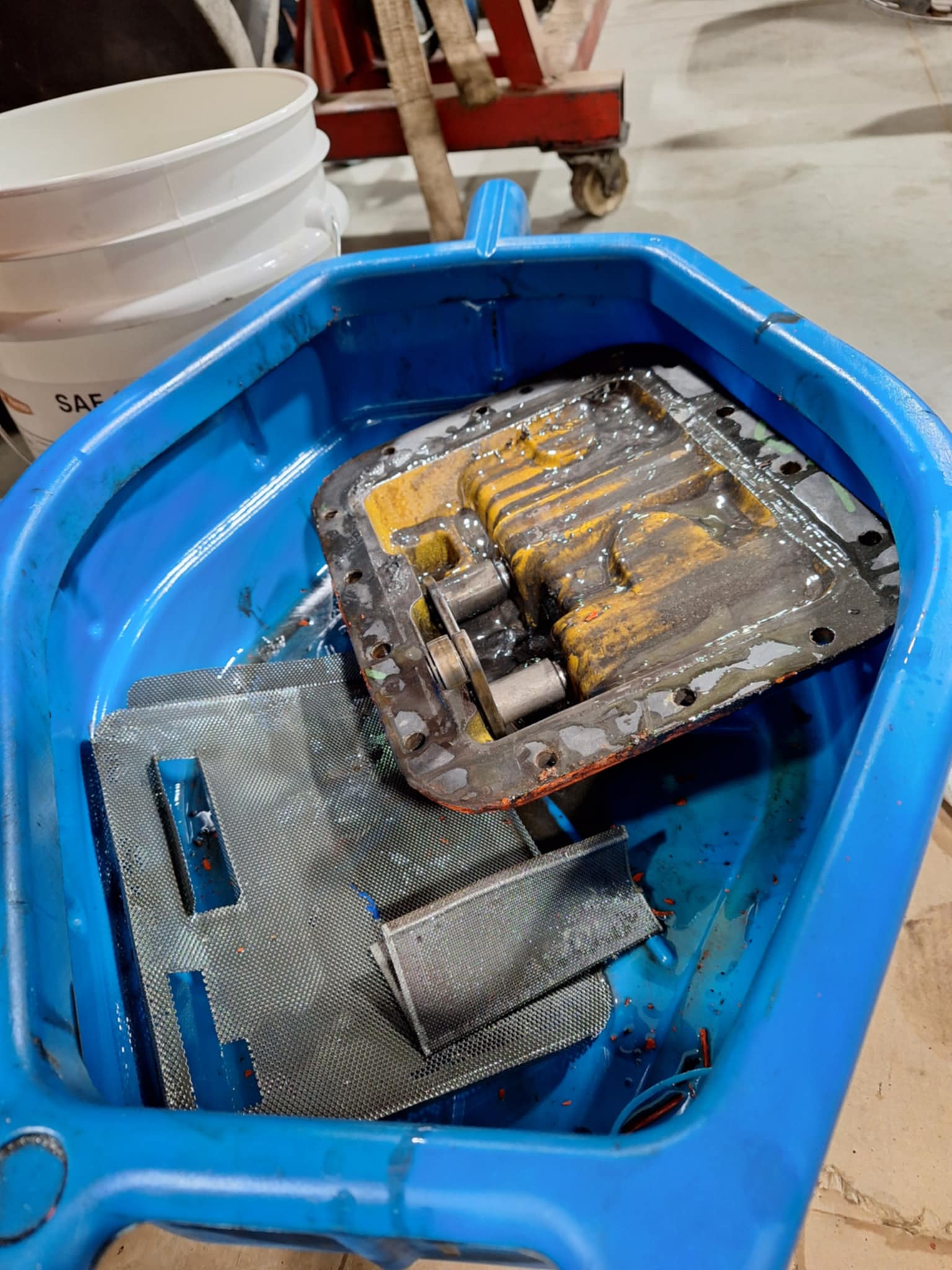

I've made some progress this weekend. I got the torque housing split from the transmission and got it up on the bench. Spent some time cleaning the hydraulic housing and bell housing out. Was finally able to get the clutch shaft pulled. The seals between the hydraulic sump and the power director were completely gone. The seals on the clutch end were not much better. The clutch shaft cams are real rough. Looks like we will be searching for a replacement. Also pulled the clutch and flywheel off the motor. Clutch disc still has quite a bit of life left in it. Throw out bearing feels good. All of the clutch fingers are worn unevenly. I'm assuming this can be corrected by adjusting them so they all contact the throwout bearing evenly? Ring gear teeth are rounded in a few places. I'm guessing the ring gear can be reversed? Figured I will probably flip it and rotate it a bit so the wear spots are not in the same place.

Points: 8678
Post Options Post Options   Thanks (0) Thanks(0)   Quote SteveM C/IL Quote  Post ReplyReply Direct Link To This Post Posted: 12 Jan 2025 at 7:00pm

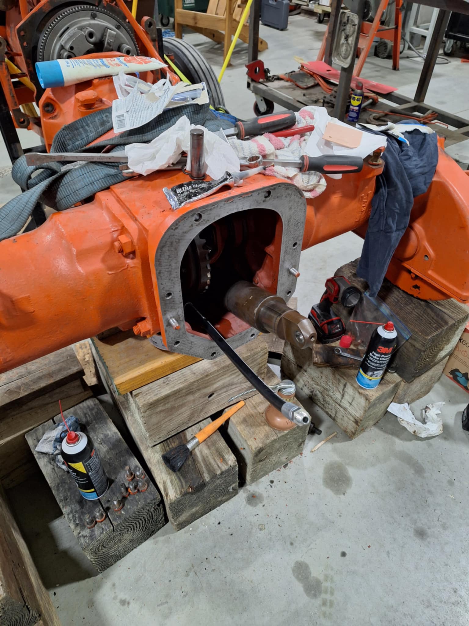

Often only one side of ring gear is chamferd for bendix engagement. Just be aware.
Points: 22140
Post Options Post Options   Thanks (0) Thanks(0)   Quote DrAllis Quote  Post ReplyReply Direct Link To This Post Posted: 12 Jan 2025 at 7:35pm
If the ring gear isn't too bad, rotate it 90 degrees !!! Do NOT turn it over. Engines only stop in two places. Rotate it 90 degrees and you'll have new meat.

Yep, looking at the picture of it I believe it's only chamfered on one side. I'll just rotate it 90 degrees. Thanks!

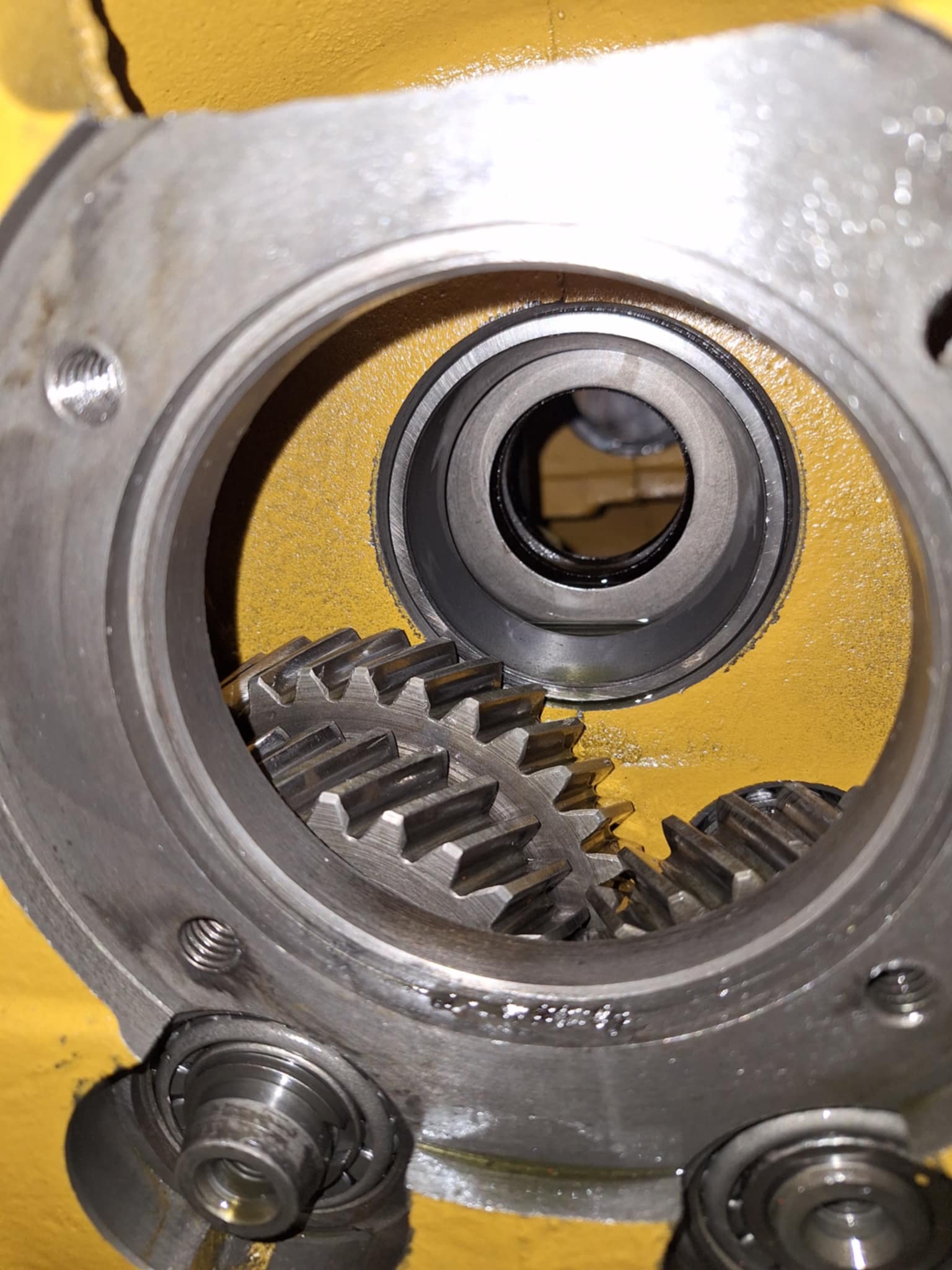

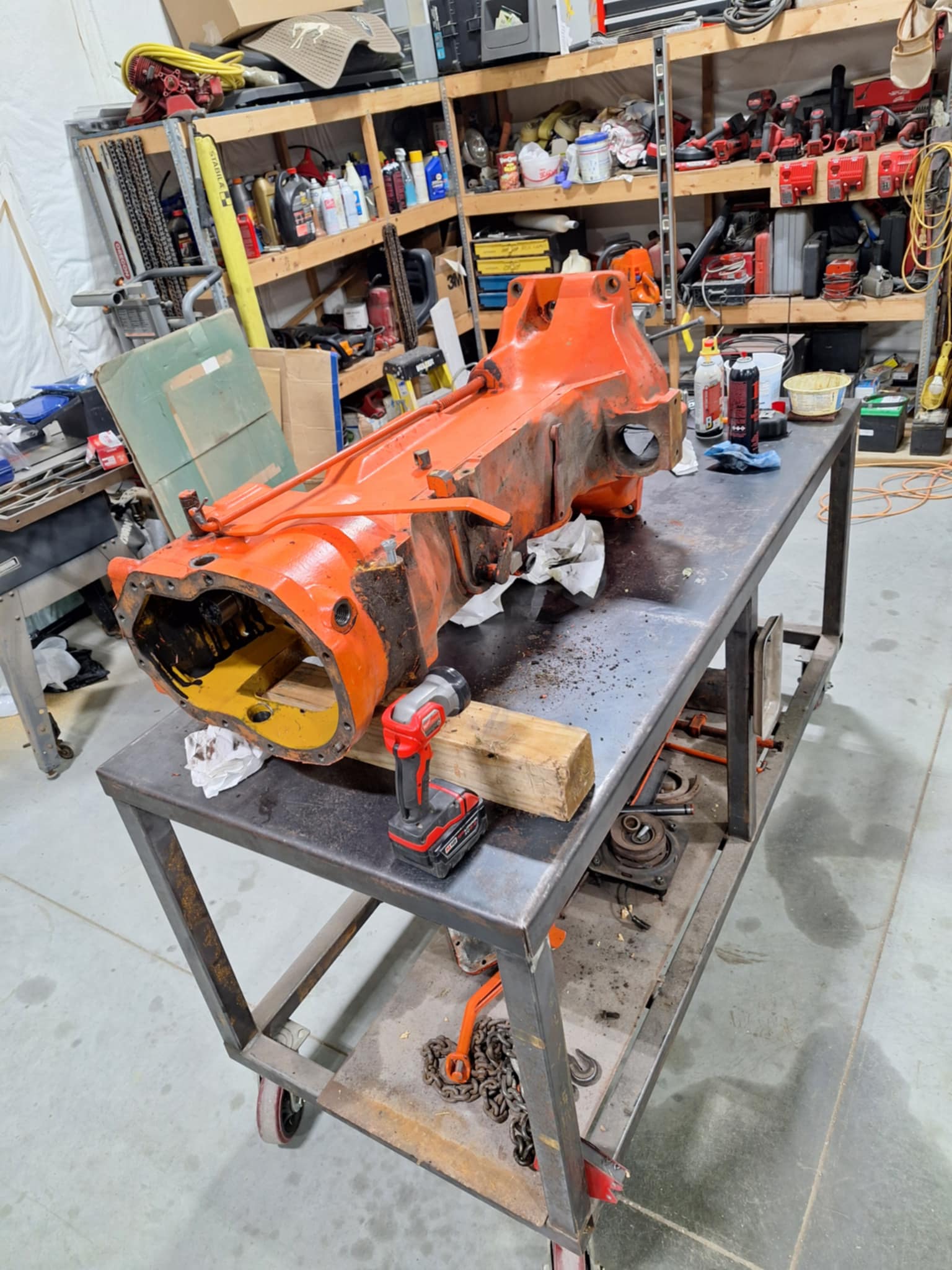

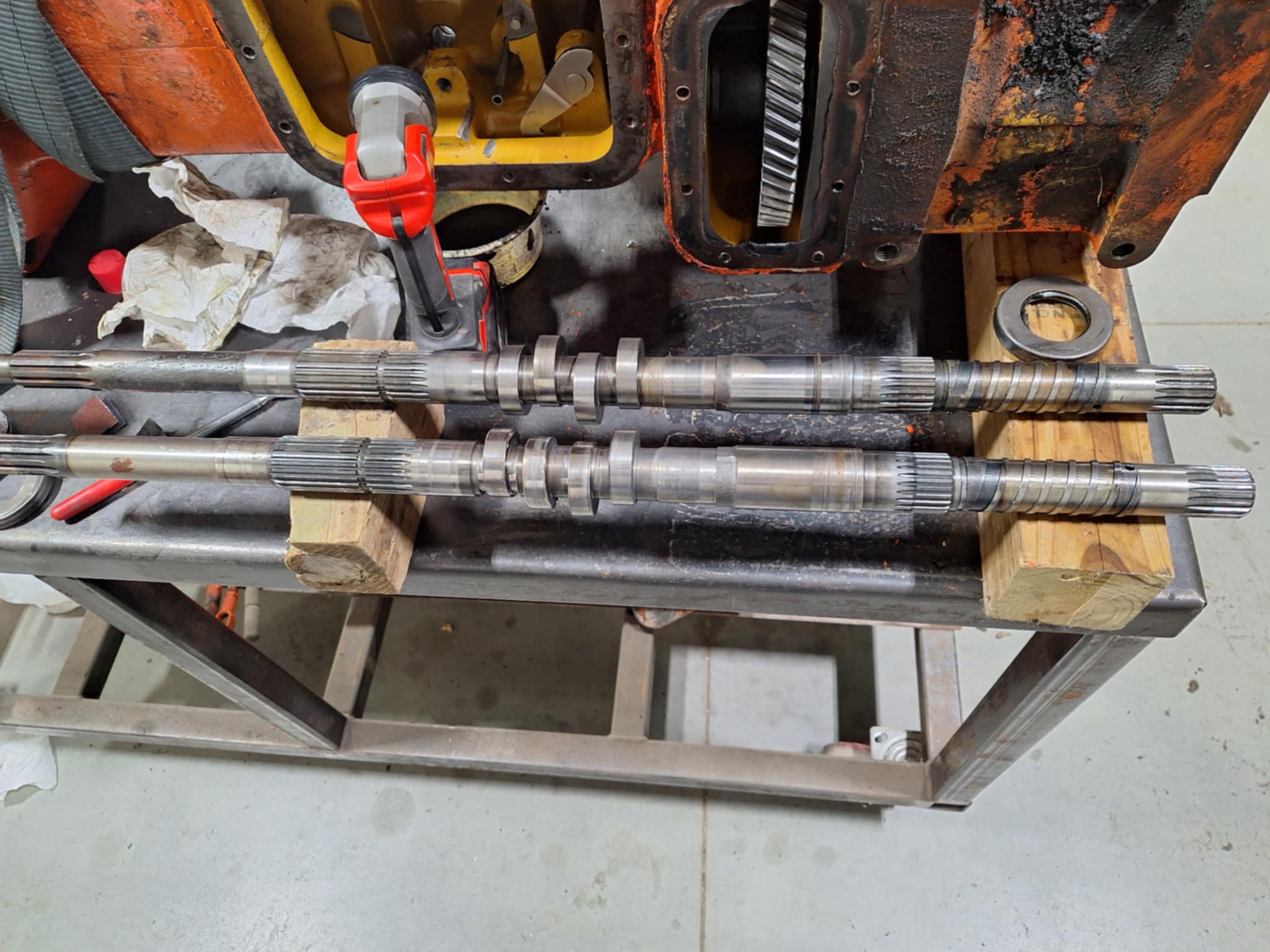

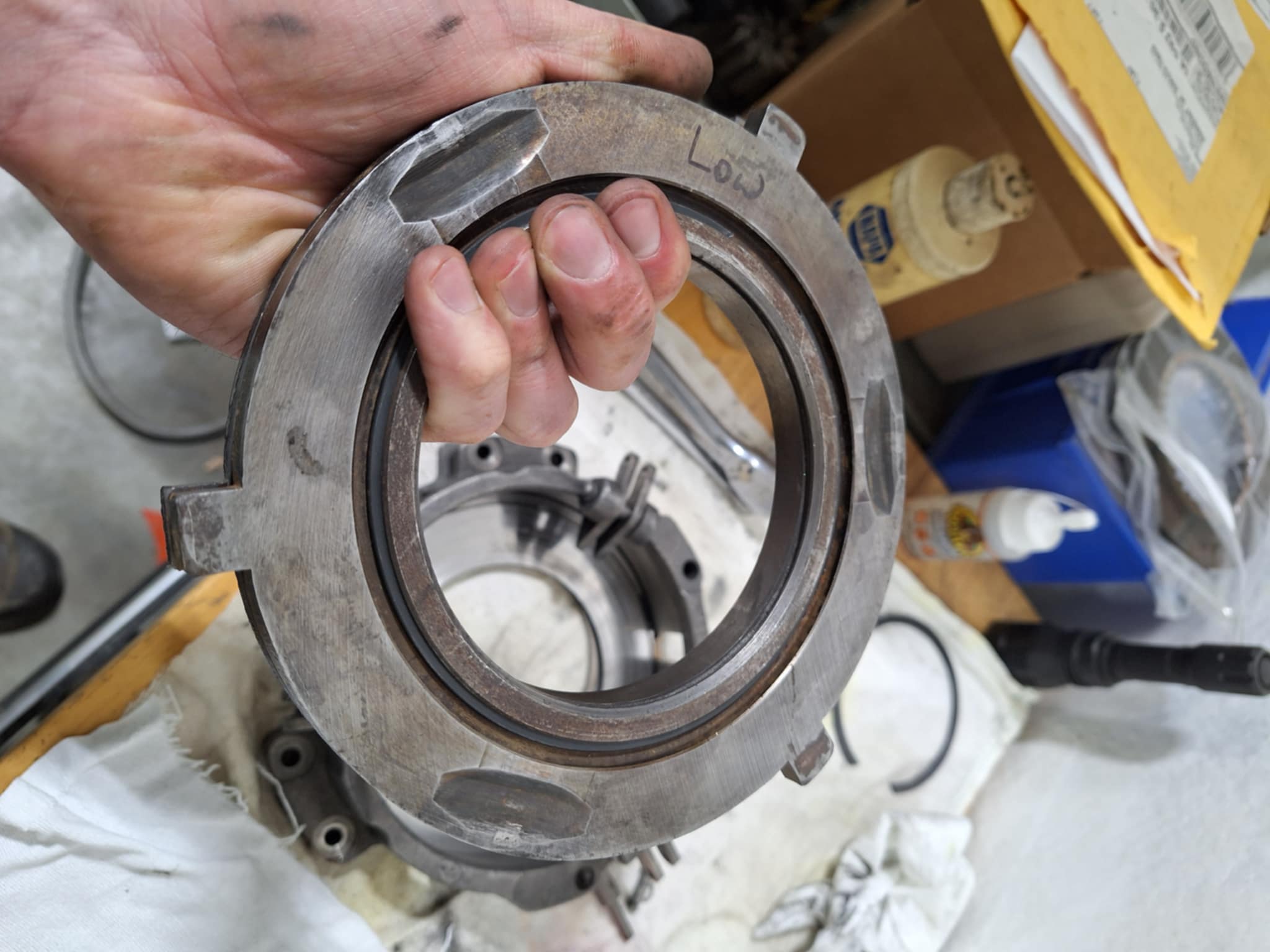

I've made a little progress. Bill Deppe was able to get me a clutch shaft and a set of roller followers. I've got the torque tube mostly back together with new seals and gaskets. Just have to get the power director sorted out and then I can get the trans, torque tube and motor mated back together.
Points: 22140
Post Options Post Options   Thanks (0) Thanks(0)   Quote DrAllis Quote  Post ReplyReply Direct Link To This Post Posted: 09 Mar 2025 at 5:23pm
Pretty cool foot clutch pressure plate. I have never seen one with extra weight welded to the pressure plate !!!

Post Options Post Options   Thanks (0) Thanks(0)   Quote Alex09(WI) Quote  Post ReplyReply Direct Link To This Post Posted: 12 Mar 2025 at 11:49pm
Wow, that pressure plate is interesting. I've seen so many of them in my neck of the woods with the weights welded on, I thought it may have been factory on the D15 II tractors.
Looks like the project is coming along very well!

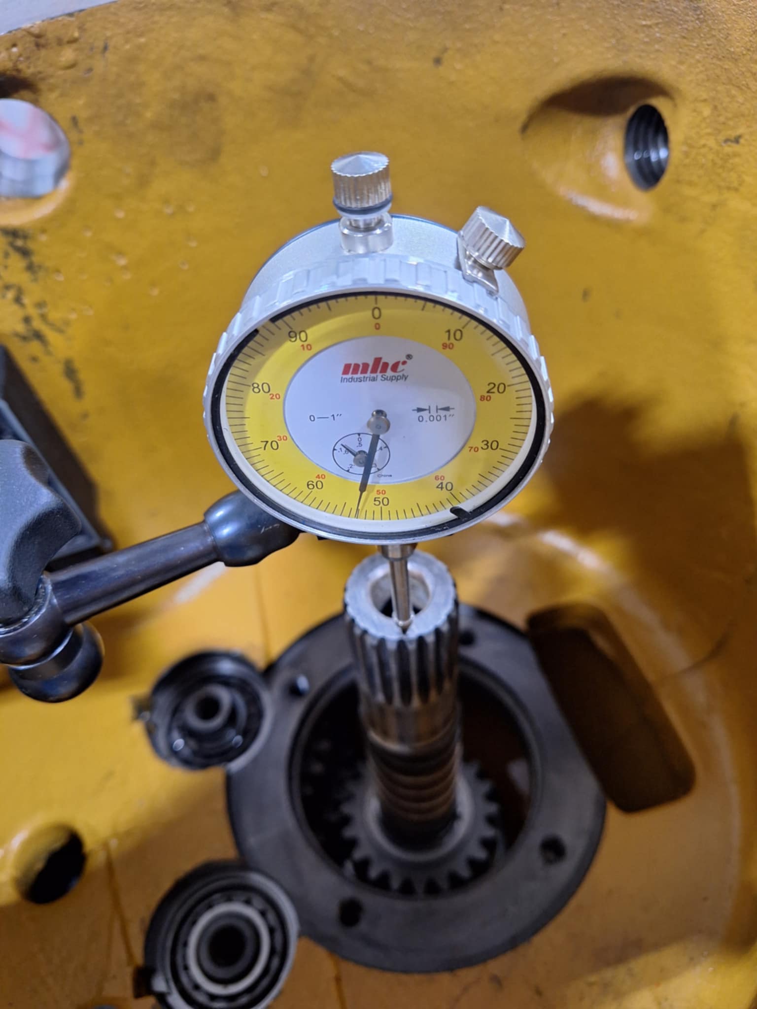

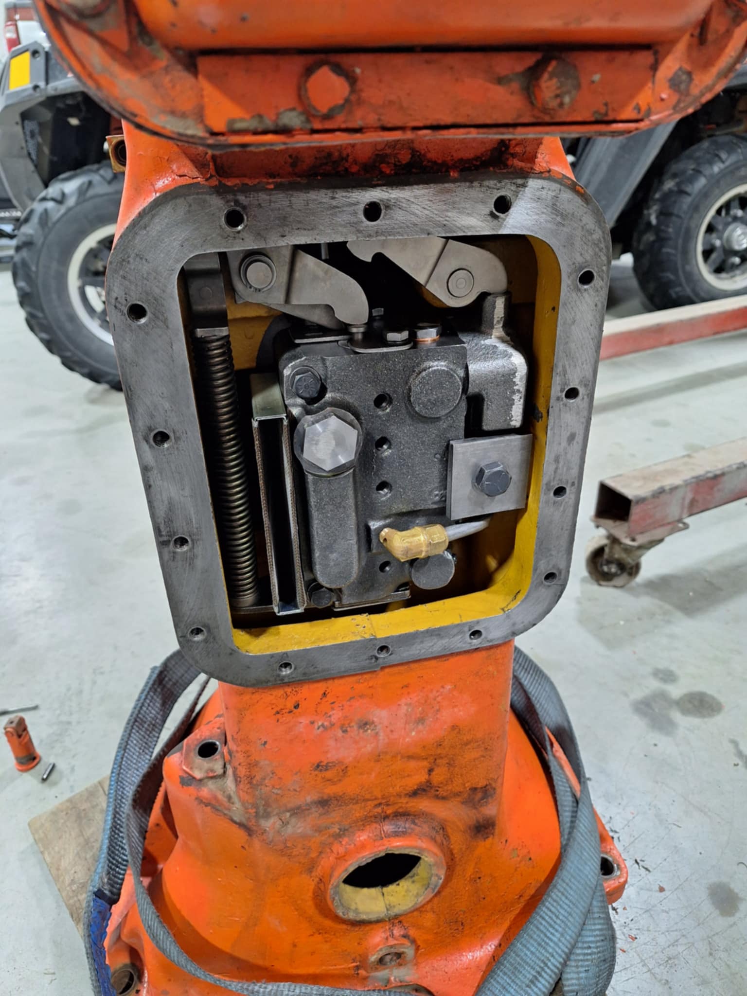

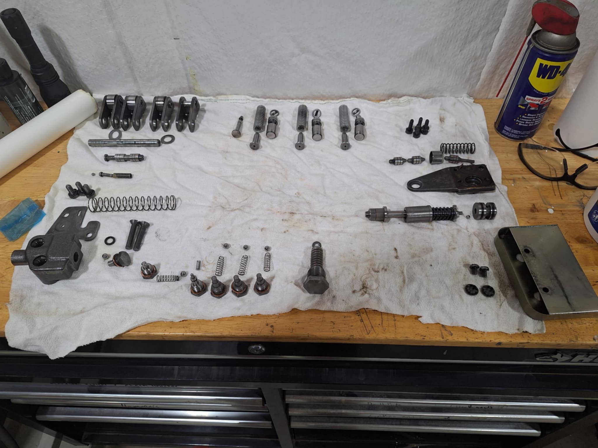

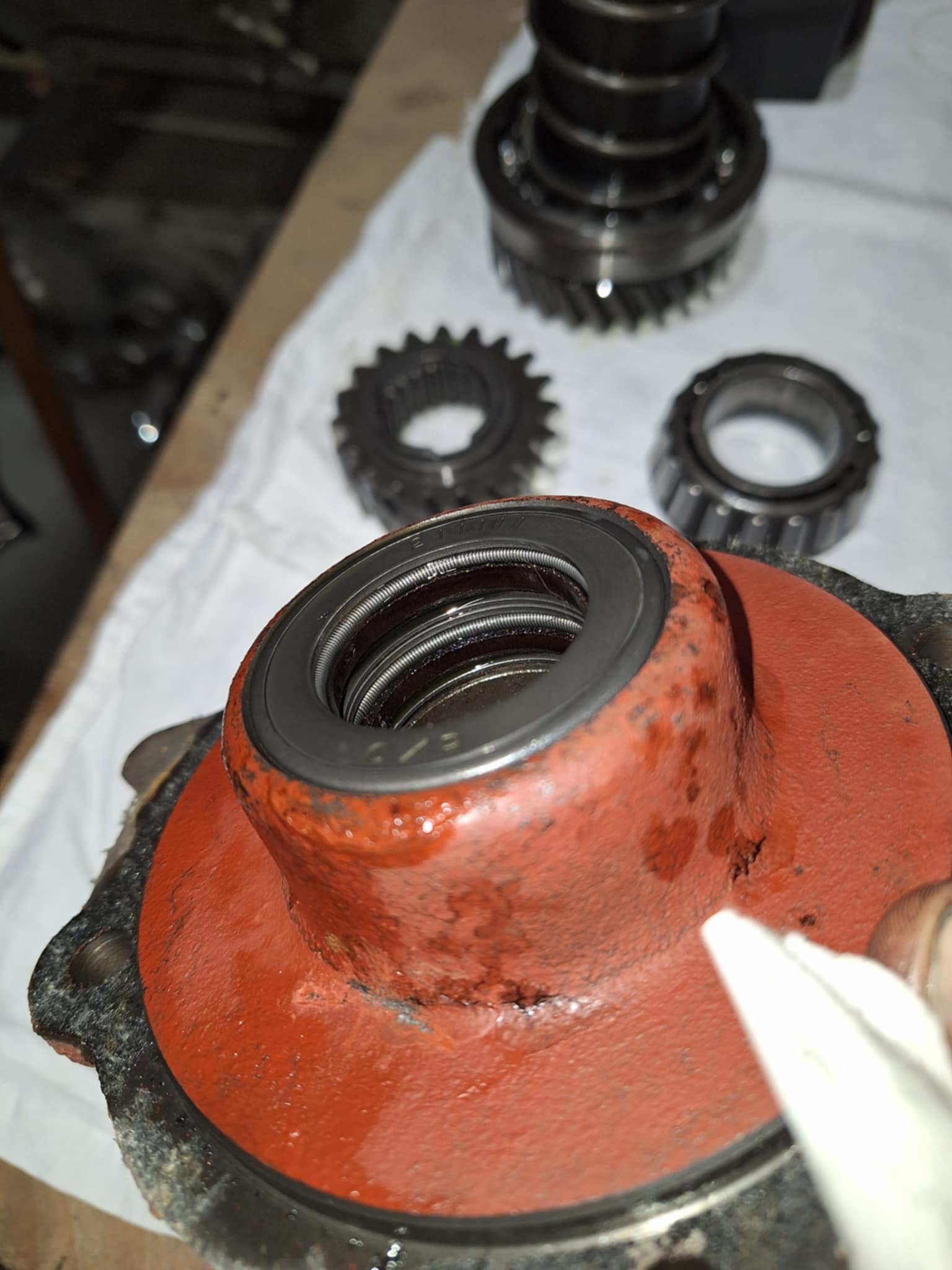

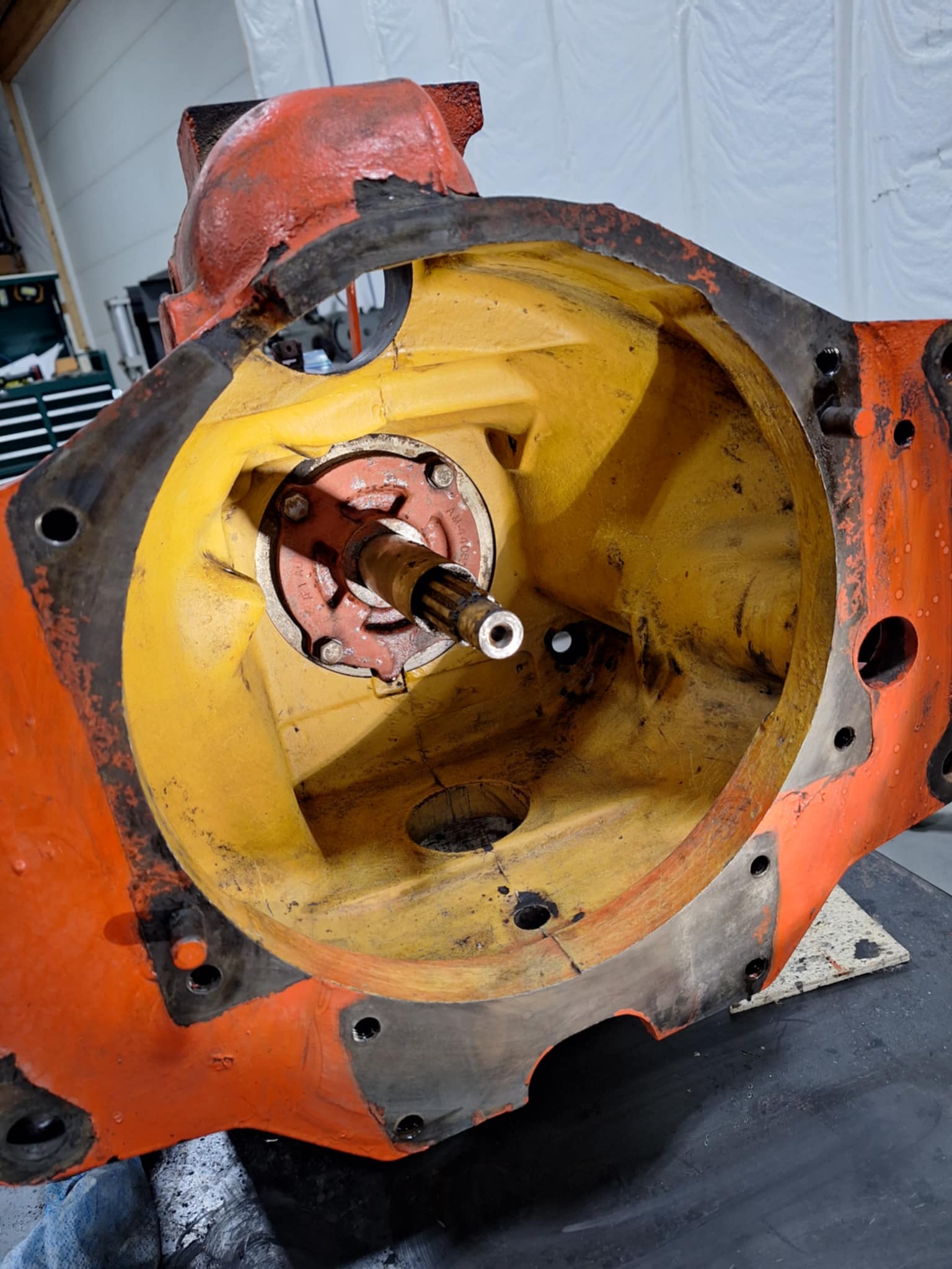

Well, Bill Deppe was able to get me the power director parts I needed. Made a lot of progress over the last couple of weekends. Got the power director back together with the new detent plates and clutch disks. Was able to get it shimmed to spec. Got rear lift back together with new cylinder seals, rocker shaft seals and a new internal hose. Tractor went back together without too many hickups. Every compartment in the rear-end has fresh utf. I was able to get it running this weekend and take it for a test drive. Everything works well! Just a few little odds and ends to wrap up before the side panels can go back on.
