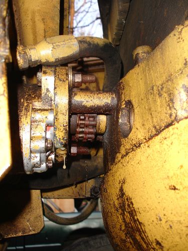

My front mounted D-15 hydraulic pump is leaking. Are there any replaceable gaskets or seals to fix this, or do I need to look for a new pump. Either way where can I get the parts I need? Thanks.

Take it off, and check with a local rebuilder.  I use Advanced fluid systems, Lancaster PA.
Also, if the tag is legible, on the pump, Check with surpluscenter.com and see if they have a will fit replacement...
