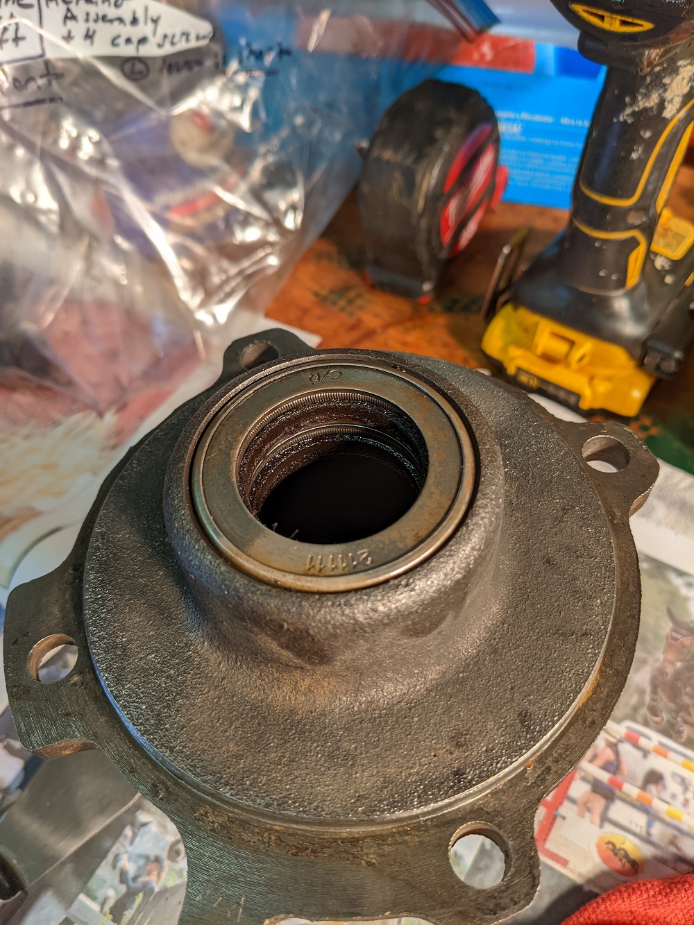

Post Options Post Options   Thanks (0) Thanks(0)   Quote WeisAC2 Quote  Post ReplyReply Direct Link To This Post Posted: 22 Dec 2021 at 10:45am
This would be the reason for all the oil in my bellhousing...  I replaced these seals and put in another gasket at the base of clutch retainer assembly.
