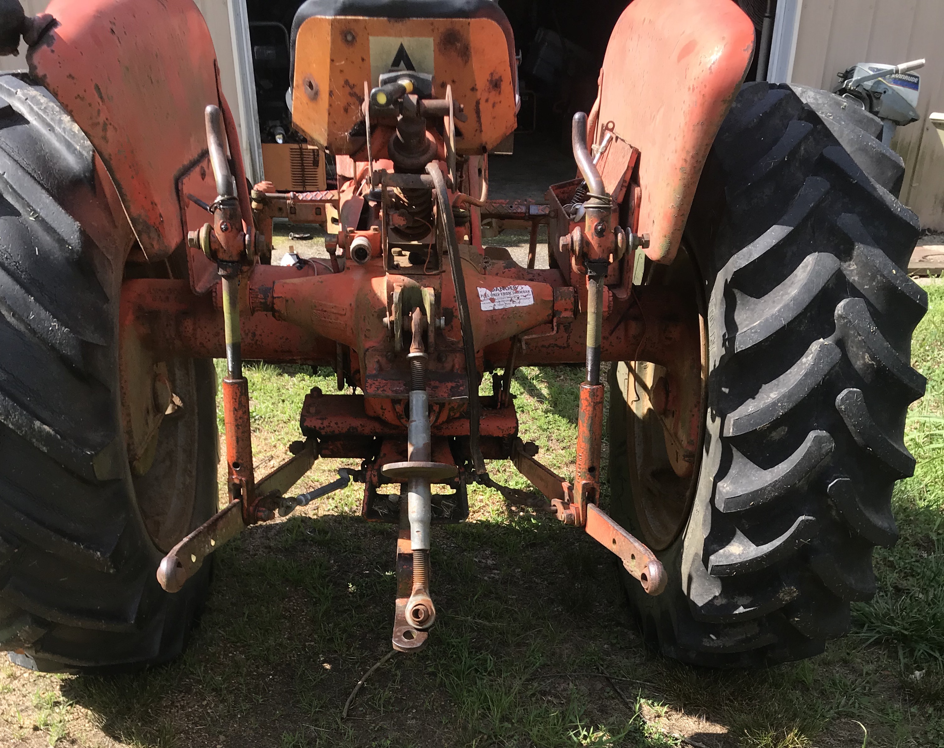

Here you go, factory 3 point hitch arms unscrewed to the lowest position.  I am willing to bet that your threads are jammed full of crap in a higher position.
Here is the amount of threads I have showing on the arms...

Thanks to DSeries4 for excellent post and pics . Shows me exactly what I need to know . Y'all are great .

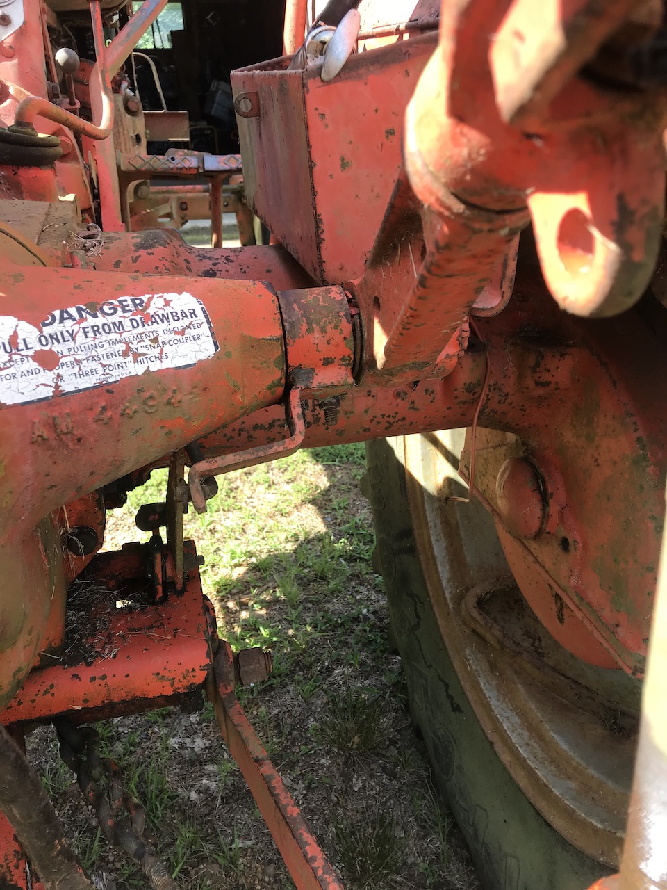

Ok back at it this morning . Got one of the draft adjusters free the other one is coming around . Here is a pic of the lowest my lift arms will go even with me standing (300lb) on them . As you can see its nowhere near as low as it should be . I pulled the dash lever lift control down past its detent and I can hear the valve unloading but the lift arms only go down this far and thats it . Took a pic of some more linkage thats hooked to the quadrant arm and I assume it has something to do with the traction booster ?  This  has me puzzled for sure .uploads/19309/IMG_0099.jpguploads/19309/IMG_0098.jpguploads/19309/IMG_0100.jpguploads/19309/IMG_0106.jpg

If nothing else resolves the issue, there's a remote possibility that someone has repositioned the lift arms on the splined shafts in an effort to raise an implement higher, thus limiting travel in the lower position.
Also, be aware that there is a roll pin inside the threaded link . It's only accessible when the link is threaded in.  You don't want to force the link out of thread engagement when unscrewing it; doing so will really jam things up.

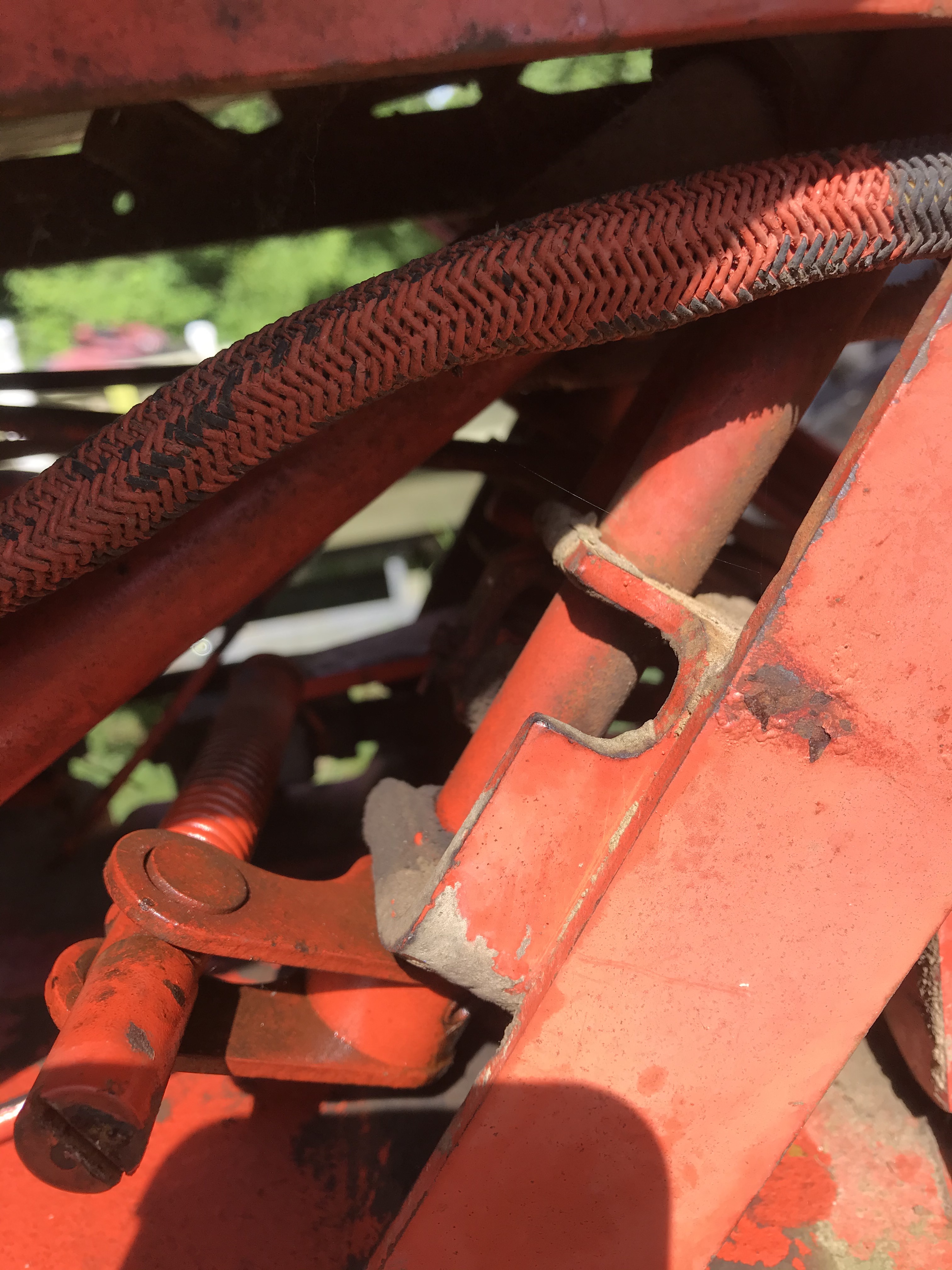

Post Options Post Options   Thanks (0) Thanks(0)   Quote ric44 Quote  Post ReplyReply Direct Link To This Post Posted: 25 Jun 2020 at 10:51am
After looking at the linkage in the third pic it seems to me that someone may have repositioned the piece that clamps on the rockshaft and that the linkage rods are in a position that prevents any further downward movement of the quadrant (upper) arms . Gonna try loosening the 2 bolts to see if it will let the arms drop lower .

Post Options Post Options   Thanks (0) Thanks(0)   Quote DrAllis Quote  Post ReplyReply Direct Link To This Post Posted: 25 Jun 2020 at 10:54am
The "lift" arms should go a little below horizontal when fully down. If they can't go below horizontal, something is wrong. You were told yesterday that about 20 inches of total UP/DOWN travel should be expected. This would be at the draft arm pull ball. Use this good information !!    The large screwdriver slot adjustment, tighten it up (clockwise) several turns. The lift/lower lever (long lever) has to be pulled all the way down as far as possible and maybe even below the quadrant and left there while standing on the arms.

Post Options Post Options   Thanks (0) Thanks(0)   Quote brettssac Quote  Post ReplyReply Direct Link To This Post Posted: 25 Jun 2020 at 11:00am
And remember a factory 3pt 15 has position control combined with the traction booster. My 15 looses adjustment ever so often and does this

Post Options Post Options   Thanks (0) Thanks(0)   Quote ric44 Quote  Post ReplyReply Direct Link To This Post Posted: 25 Jun 2020 at 11:05am
Ah yes brettssac I can see that . I think I'm homing in on the problem now . I think that clamp on my rockshaft is in the wrong position and keeping the arms from dropping any lower .

Post Options Post Options   Thanks (0) Thanks(0)   Quote Gatz in NE Quote  Post ReplyReply Direct Link To This Post Posted: 25 Jun 2020 at 11:06am
looks like that bracket is bent ....

Post Options Post Options   Thanks (0) Thanks(0)   Quote ric44 Quote  Post ReplyReply Direct Link To This Post Posted: 25 Jun 2020 at 11:09am
Gatz  it was bent up against the axle housing this morning and I took a crowbar and bent it back down to more or less where it should go . I have no pic or diagram to go by however .

Post Options Post Options   Thanks (0) Thanks(0)   Quote brettssac Quote  Post ReplyReply Direct Link To This Post Posted: 25 Jun 2020 at 12:11pm
Yes the clamp on the rockshaft is what always moves on mine it’s just clamped with those two bolts and yours looks like it is clocked wrong like it has slipped I’ll look at mine when I get home
