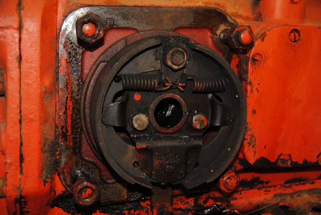

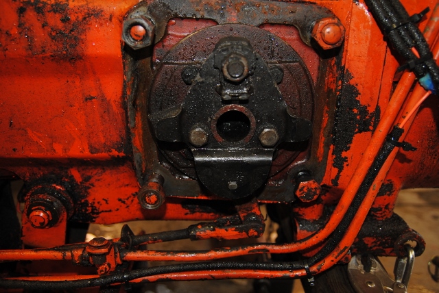

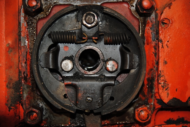

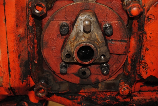

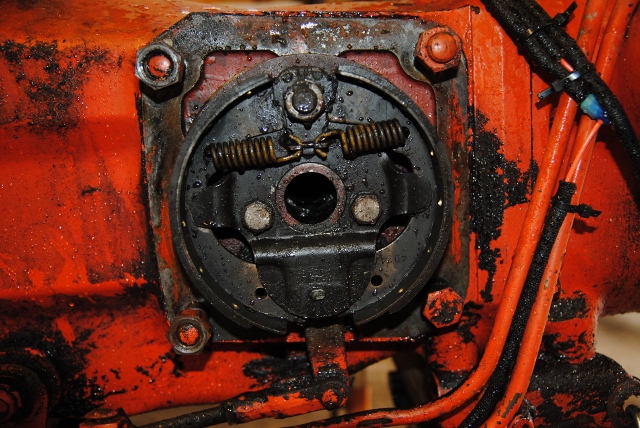

  I'm starting on a new chapter with this D15 and finally doing the brakes.  Looking for advice/opinions on all the things I need to correct and replace.  I'm planning on having Rick replace the shoes and possibly having the drums replaced or turned.
  Interestingly, the left brake has never worked.  I assumed that the pads were completely worn or something was broken.  Surprisingly once getting in there everything appears to be in good shape.  Maybe the pedal wasn't adjusted correctly.  Any thoughts?
  Also, is there a big difference between the WD/WD 45 brake vs. a D15 brake.  I was dreading having to pull the infamous pivot pin but one just pulled out with my fingers.  The left one appears to be in pretty good shape.  Am I missing something with this???

WD45 brakes are completely different from a D15, you have no worries here - no pivot pin to deal with.  As you see, the D15 brakes are very simple and straight forward.  Can't explain why the left one was not working.  Make sure you have the lever set up right before you slide the axle back in.  Also replace your axle seals prior to reassembly.

Last year about this time I did the brakes on my d15. There's not a whole lot to d15 brakes. Relign your "pads" as I call them, possibly replace your drums or turn them, and most importantly replace your seals! I couldn't get the thick seal like came in these tractor so I replaced them with two of the modern thinner ones and it works great! There was a few pieces where the linkage actually moves the actuator that were wore from years of use and while we had it apart we built theses pieces up with weld and ground them back like new. It's a fairly fun project that I enjoyed! Good Luck!

I helped with this brake job . The shoes really don't look that bad and the drums don't have much of a ridge on them . We also didn't see anything that looked broken or excessively worn . Maybe when it's all cleaned we'll find something . Beginning to think they've never been adjusted . Also wonder if we'd gain anything by replacing the drums ? THANKS for any advice or thoughts .

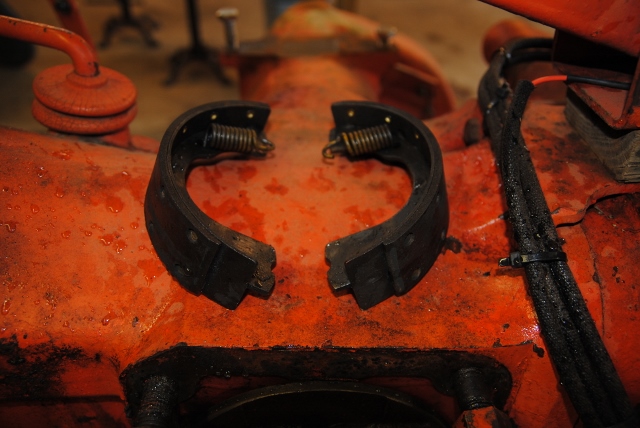

Is it just my bad eyes or do the 1st pictuures look oily to anyone else? I know when the seal goes, oil weeps onto the shoes and drum and stuff. That will account for 'no brake' symptom. I have 3 to do..one day....maybe this year ......
Have to ask , is the rear end oil level OK or HIGH ? If high it's a sign the ram seal for the rockshaft is leaking. I drained 8 gallons out where 3 should have been...
Jay

The brakes in the top picture look oily to me as well. Rick

I've done lots of work on D17 tractors.  Have never touched a D15, 14, 12 or 10.  Just surprised to see that the brakes on a smaller D Series are pretty much the same as on my G.  I've redone the brakes on my G.  They stop the tractor but don't hold like the bigger tractors do.  Of course on the G, the brakes are right on the axle.  Probably hold a little better when the brake has the mechanical of the final drive between it and the wheel!

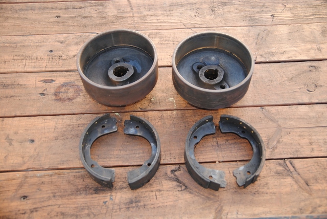

Thanks for all the advice guys.  I'm planning on replacing the seals, drums, shoes  as recommended.
 The left side shoes  were a little oily.  If you look closely the right lower stud is actually a bolt.  This lead to some leaking issues on that final drive in general.  Gonna add that to my list of things to fix.

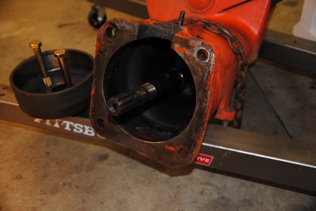

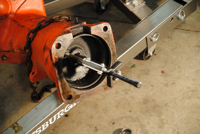

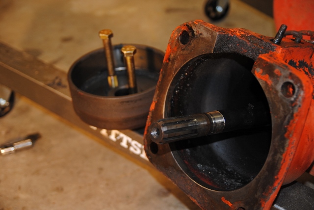

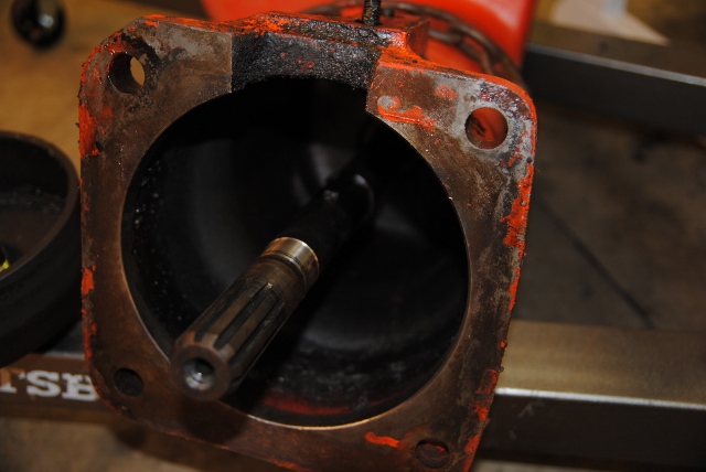

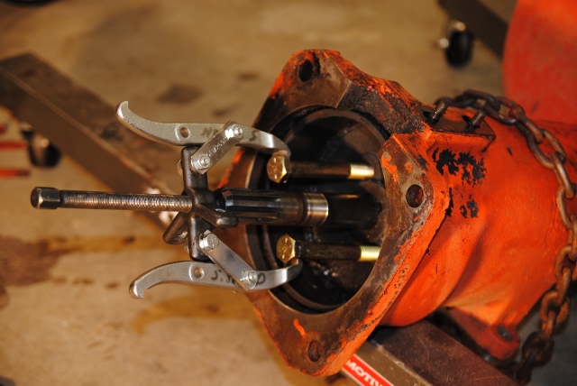

Probably boring to most of you guys but I wanted to show how I got the drums out.  If any of you are like me you like to see pictures to give you ideas on your project.  Left side came easy but right side was difficult and required repeating heating and penetrating oil.  Coming your way Rick!

Thanks for posting all the pictures!!! I have the same job coming up on both of my D14's...now I know much better what to expect. Seeing your pictures in color gives me more motivation to do the job than looking in a repair manual with black & white pics...LOL

Good job !! Guess my puller finally made the big time .

I just replaced the shoes on my D10 with the new ones from Rick in MO. He will send you a great product and please like everyone else said "replace your seals".
It's doubtful that you will have to replace the drums. If they are smooth, they are good.
You must clean out all the oil/sludge everywhere including on the outside of the drums. You can use a thin putty knife and strips of a torn up bath towel to get it very clean without pulling the drums..

The brake shoes are still usable. Just burn the oil off of them with a propane torch and they will look like new. Bob

Uh oh . Somebody forgot to put the platform u-bolt in before they put the new drum in . We had to remove the drum and now have one side assembled correctly , I hope . You can see said u-bolt in the pics above . By the time we get the old D15 back together we'll have all this stuff figured out .
