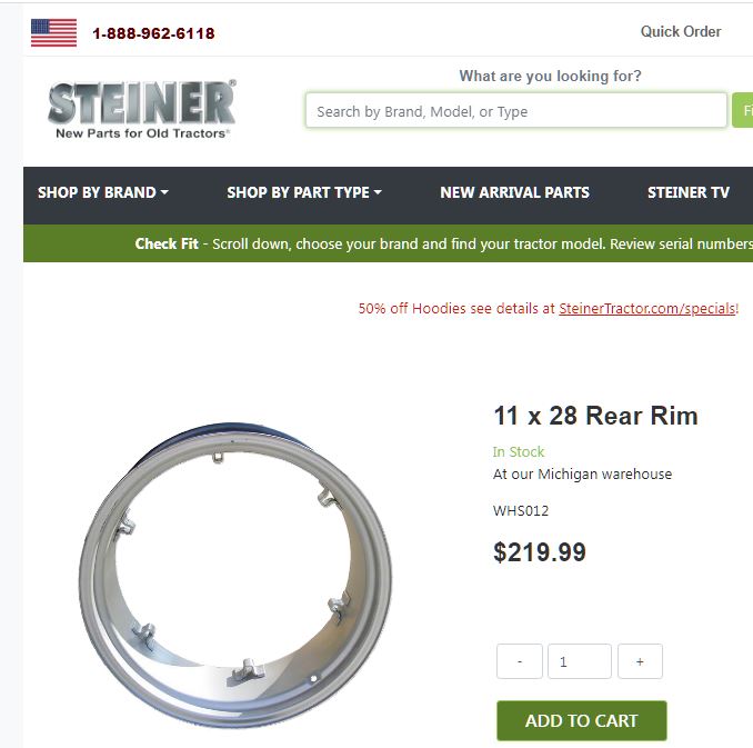

as Myron said, most combines are 26 inch and WIDE...
What you want is a 28 inch rim about 12 inches wide with an 8 bolt pattern ???
your probably talking about something like this, with an adaptor plate to 8 bolt axle
