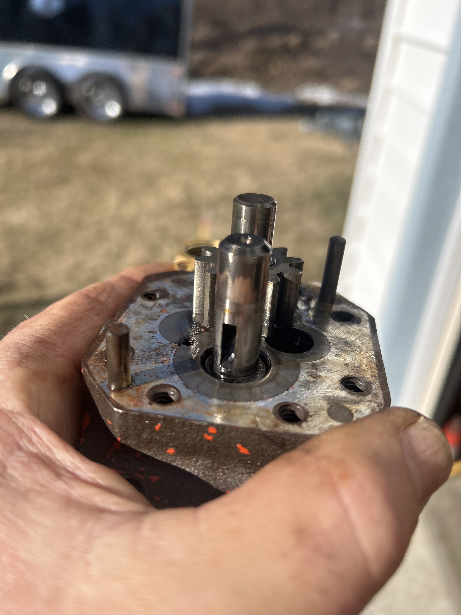

     Posted: 29 Jan 2025 at 9:51pm |
   Well, the drama continues. Removed the radiator and side rail to gain access to the pump. Had to remove the entire sump line to gain access to the port. Pumped a few shots of oil in the sump port. I left the fuel turn off so the engine would not start beyond the fuel that was already in the carb. Using a flashlight to look in the port and then turned the key to rotate the pump hoping to suck in oil as Dr Allis suggested. After a very short run of the fuel in the carb the engine stopped, I shot more oil in and turned the key. I then noticed the gears inside the port were not turnin9g. I verified a second time. Removed the pump and getting a better view, the gears were not turning. When I initially pulled the pump from the parts tractor I rotated the main drive gear to make sure the pump was free. It turned easily so I was relieved the pump was free but I failed to peer into the suction port to verify the gears were turning. I proceeded to tear down the pump and much to my surprise it was very clean inside but the key to the drive gear was missing!! I disassembled this in an area that would have captured any parts from inside so I know the key didn’t fall out. I’m beginning to think maybe there was a previous issue and the key was removed or someone forgot to put it back in. The cap screws appeared to have been removed previously before I tore it down. Called SLI and ordered a key along with some new gauges I’ve been meaning to order. Kicking myself in the butt for not verifying the gears turning. Hope to have the key late next week. Gears look great as well as the housings and bearings. I don’t see any other issues at this point.
  Edited by AC720Man - 29 Jan 2025 at 9:55pm  |

     Posted: 29 Jan 2025 at 10:15pm |
   AC720Man
   Joined: 10 Oct 2016 Location: Shenandoah, Va Points: 5250  |
      Post Options
        Thanks(0)
      Quote   Reply
     Posted: 01 Feb 2025 at 11:40am |
   Thankfully my local Carquest had a small key that fit the shaft. Reinstalled the pump and the power steering works great!! Still unsure why the key was missing? I took this apart on a white towel and never found remnants of a key. This has been a fun project and man it’s nice to have power steering. Thanks everyone for your input to make this a successful project.
