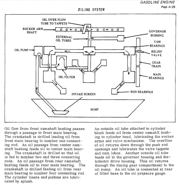

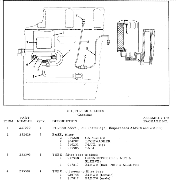

I couldn't find any info on the D14 but I found a manual for the H3 which I believe is the same engine.
Hope this helps

Post Options Post Options   Thanks (0) Thanks(0)   Quote steve(ill) Quote  Post ReplyReply Direct Link To This Post Posted: 38 minutes ago at 8:58am
yea... that all makes sence.. just didnt understand why the ball is in the not-used hole...there is no oil at that point..... unless its just a reminder that the block has been modified to full flow
