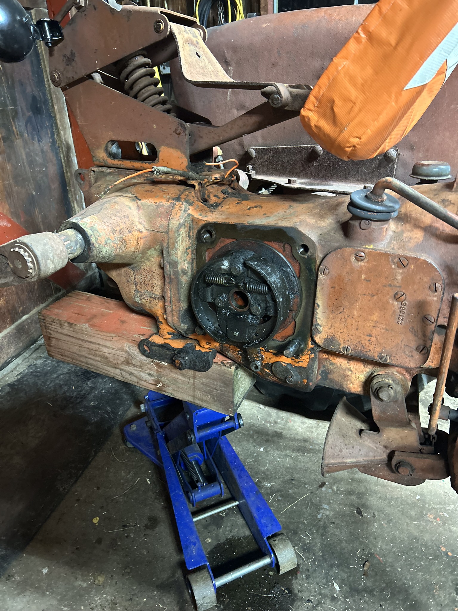

Decided to go ahead and replace my brakes and repair an oil leak that has ruined the shoes. Puddles all over the shop floor drives me crazy also. The IT manual doesn’t have a step to replace the seal that I can find. I have removed the right hand side final drive. Shoes will need to be removed to get to the bearing carrier. It appears that I need to remove the bearing carrier to access the seal?

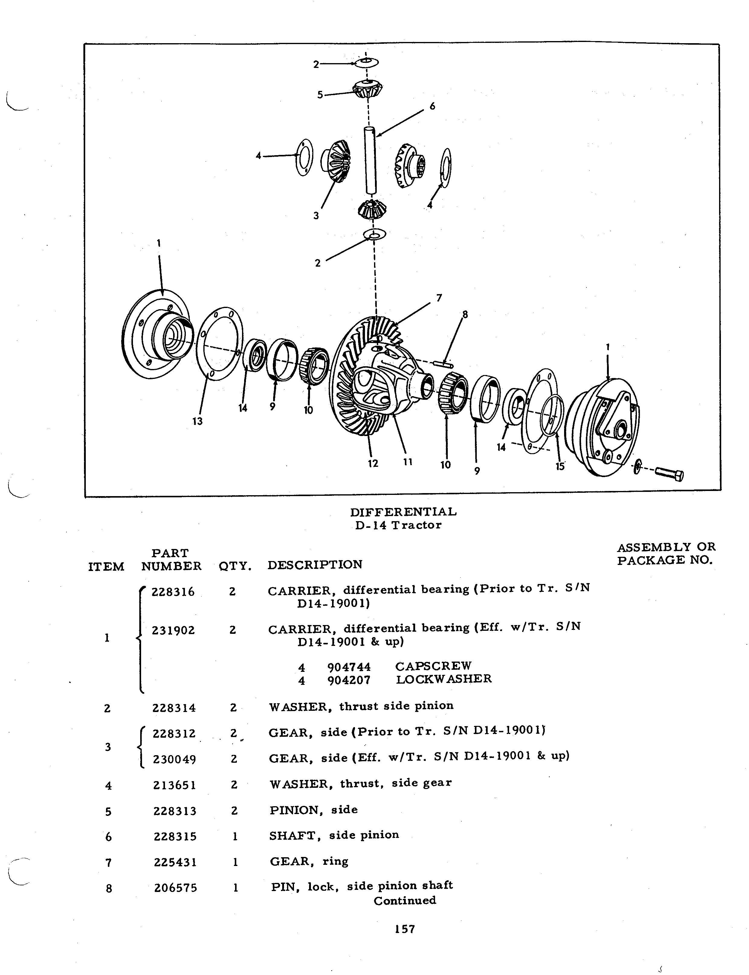

yes, going by my fuzzy memory... the seal sits in the 'inside' of the carrier.
 I have extra seals here ,somewhere. Used TWO per side as new ones are 1/2 the width of the old ones
I can scan and send the 'differential' drawing if you want.
Jay
Points: 24775
Post Options Post Options   Thanks (0) Thanks(0)   Quote jaybmiller Quote  Post ReplyReply Direct Link To This Post Posted: 06 Feb 2025 at 3:54pm
14 is the seal and the carrier is HEAVY !!!!!

Brenda at SLI has shipped the seals. So what keeps the differential from falling out of place when I remove the bearing carrier?

Yes I have that same parts breakdown, just no instructions on how to replace the seal? Looking at it appears the bearing carrier has to be removed in order to get to the seal. Just don’t want anything that fall out of place and then have to tear down further.

Don't worry, nothing will fall out of place by removing the carrier. Once that is off you will see how to punch the old seal out and how to install the new one. Pay very careful attention to the shims and to make sure to have proper bearing preload as you put everything back. It's quite common that after 60 some years there is a bit too much clearance between the bearing and the race.

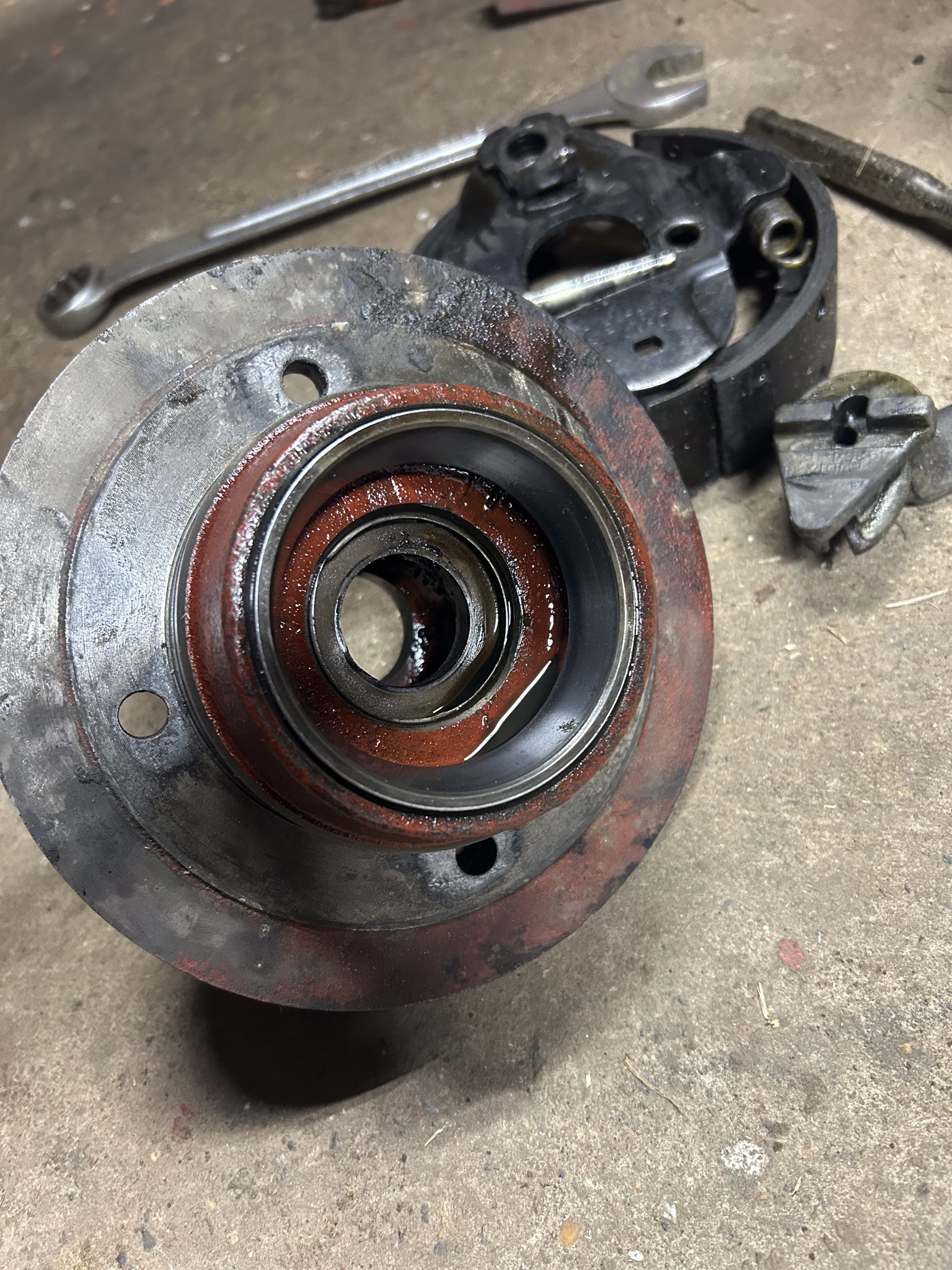

Appreciate the advice. Got it apart, seal was ripped. If I’m looking at it correctly the face of the seal faces towards the differential.

The side of the seal with the numbers on it should be towards the rear wheel. By observing the lip(s) of the seal that would effectively keep the oil out of the differential is easy to see and on the flip side you can see which side will most easily allow the axle to slip through without the seal being harmed.
Points: 5249
Post Options Post Options   Thanks (0) Thanks(0)   Quote AC720Man Quote  Post ReplyReply Direct Link To This Post Posted: 07 Feb 2025 at 9:18pm
Thanks, it’s deteriorated so bad it looks opposite like you’re describing. The side facing the wheel is gone, like you’re looking at the back of the seal. I understand how seals work and I agree with your orientation. Keeping the oil in the rear end is its job. Seeing what I’m looking at is why I asked the question. Thanks

Only pull 1 axle at a time.  That will keep the rear end gears in place.  Remove the carrier and knock out the old seal.  Tap the new one in with a socket and hammer - find a socket close to the same size (or slightly smaller) as the outside diameter of the seal.  Have done several.

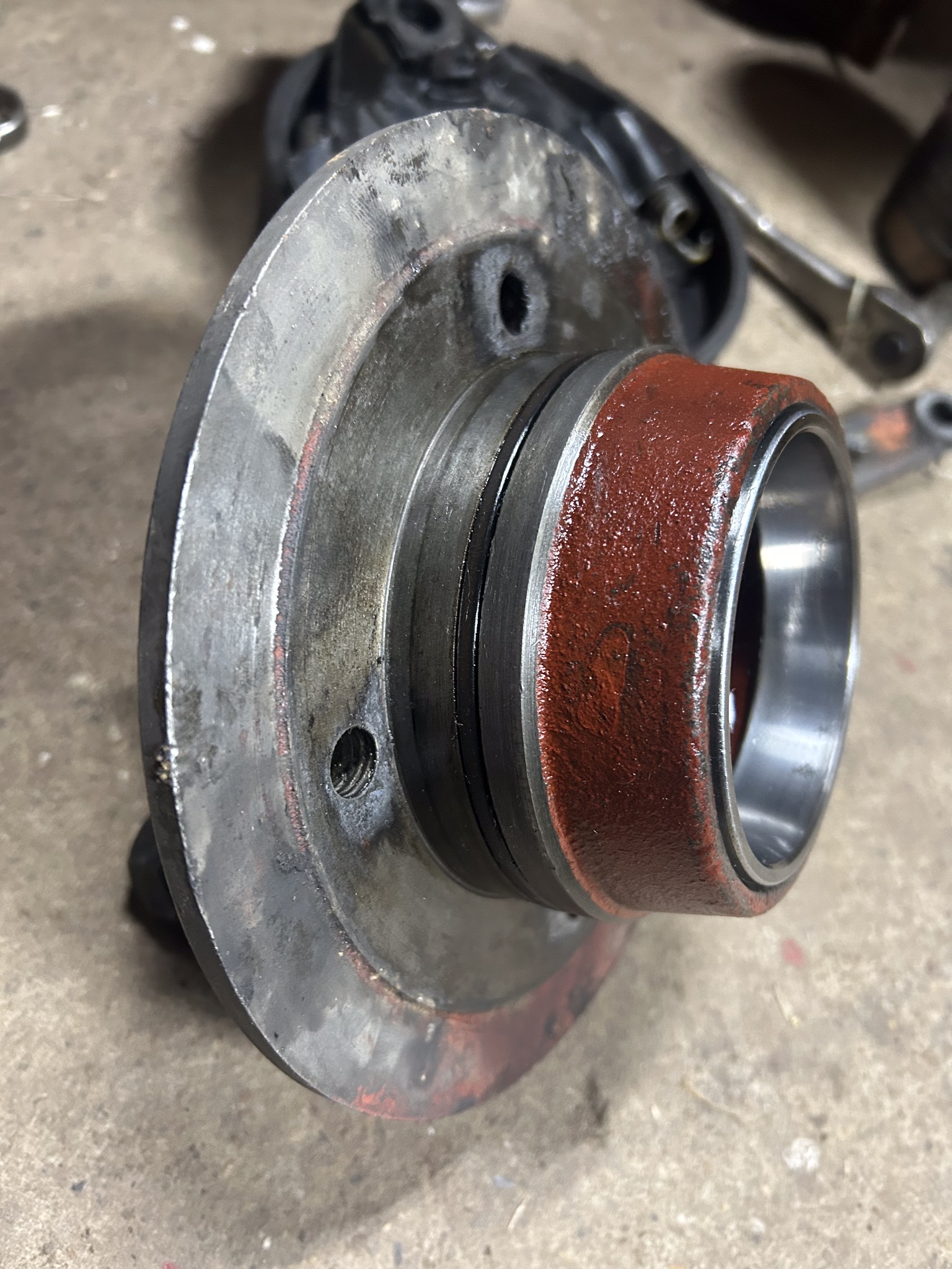

Finished this job up today. Really nice to have good brakes now. Appears to be the original Bendix brake pads and they were only half worn but were oil soaked. May have been able to to clean them up with brake clean and reused them but didn’t want to take the chance. Now with power steering I added and good brakes this is gonna make a real nice hay rake tractor. Anxious to put her to work to see how she does. If all goes well over the summer she will get a paint job and new decals. Also installed new AGCO gauges to match my NOS tachometer I got a few weeks ago. Sent it to Star Speedometer to have him go through it to replace the old factory grease to make it last 50 years. I’m glad I called him for advice if I should put it use right away or should I have him look at it first. Haim said the grease was pretty stiff and probably would have damaged it. Money well spent in my opinion and peace of mind knowing I don’t have to worry about it now. Thanks to each of you for your advice on the carrier seal. By the way to new seal was the same thickness as the old one. Perfect fit.

Congratulations on finishing up your brake job! Don't throw away your old brake shoes, they will clean up very nicely and would probably last another 50 years with moderate use. If I only lived closer I'd buy them although for the moment I don't need any. I notice the bearing race has some marks of general wear.
Points: 5249
Post Options Post Options   Thanks (0) Thanks(0)   Quote AC720Man Quote  Post ReplyReply Direct Link To This Post Posted: 16 Feb 2025 at 8:38am
Eric I should have wiped the bearing race before I took the picture, the bearing race and bearings were in good condition. Most likely what you’re seeing is some dirt/brake clean debris.
