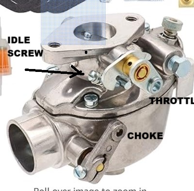

BAck out the IDLE SCREW and make sure the THROTTLE ARM is down against the STOP to get to IDLE..... not your carb, but something like this.... if you have a mixture screw like the one at the top right of this picture, screw it in to the BOTTOM and back out 1.5 turns...
i have a China Carb on one of my B tractors.. Starts and runs fine... but i had to remove the main jet and make it .002 inch bigger to keep it from hunting at 2/3 throttle.  needed about 10% more gas..
