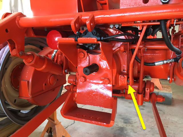

Guys, I found a leak coming from where the PTO handle enters the PTO Housing

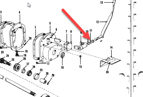

I think I have replace this o-ring

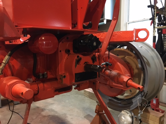

So I have the tractor all tore back down and I took out all the screws (even had to grind the head off one of the funky bolts on the bottom) but I don't think it's ready to come off yet. Do I have to dig out that oil seal and remove a snap-ring or something before the PTO Cover will come off?

Post Options Post Options   Thanks (0) Thanks(0)   Quote DiyDave Quote  Post ReplyReply Direct Link To This Post Posted: 12 Feb 2017 at 6:06pm
I believe you have to pull the pump, too.  I'll check the shop manual, tomorrow, if I remember...
