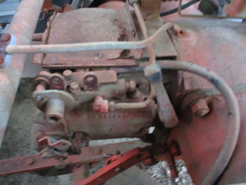

What do I have here Fellas ??????

Have parts of a B or a C .One without a pump and one with a pump for hyl.

Would these fit/work on D10. they came with one I have for sale in classifieds.

CA pumps cross over to the early styl D10/12 pumps, but not series 3

the one with the straight lever is for a B or C. the Bent lever without the Hyd Pump is for a  CA. I paid $35 for the last one I bought. Do They Have the 1 3/8" Pto Shaft of the 1 1/8" shaft ?  I would love to  get a C one with the larger shaft but Shipping is usually a show stoper.

the crooked lever one  could also be from a early D-10 W/ OUT live power.

This picture shows the shift lever for the PTO used on the early D10's and D12's.  The short shift lever is the difference.
