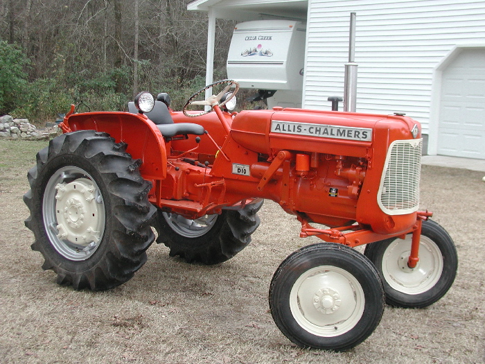

uploads/4354/D-10_completed.jpg
Haven't learned how to display photos here yet but this link shows my D-10 that I worked on about 3 winters ago.

Thanks for the picture.  I am some months away from being ready to paint.  Have it broken apart to get to the transmission.  The axle seals came this week, so I can start putting it back together sometime soon.
