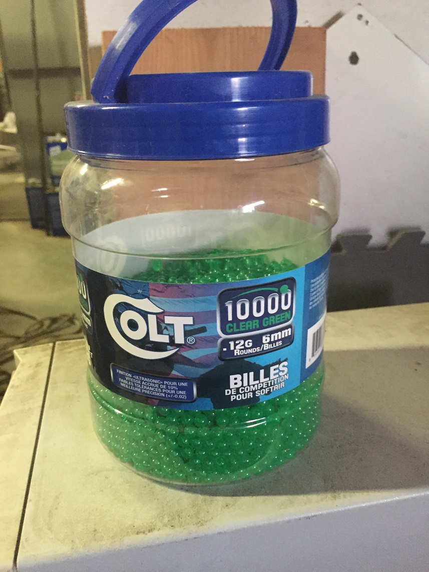

As for balancing, I use ceramic balancing beads. No need for weights or a balancing machine or bubble balancer. At first I was leary about them actually working. But one time had a new set of steer tires mounted on a semi and they didn't put beads in. It was like pushing a log chain. Went back next week and they put beads in, and could let go of the wheel and went straight down the road. I now use them in all my vehicles, truck, pickup even wife's Yukon with pressure sensors. I get them at local truck parts store,(Wheelco). Just tell them tire size. They have a chart that tells what size pouch is needed. Just throw the pouch in when you mount the tire.

I ran the beads in trucks that seen a lot of highway service miles. Not really a good setup for vocational work I've found that are low speed or subject to flats. The valve stems are of a special type for the beads and you must use very dry air or they can clump inside the tire and become an unbalanced scenario. Hard to reuse them also and tire needs a lot of cleaning before it can be patched so a bit labor intensive plus the cost of the beads again.

Also X2 on the balance beads, them damned things get in the valve core, also turn the air blue!

How do you determine how many to use?

How do you determine how many to use?[/QUOTE]
I measured the first one but have figured out that for trailer tires I just put a handful in, on my 17” truck tires I added about another half a handful. Drove that truck and camper halfway across the country and back with no issues.
