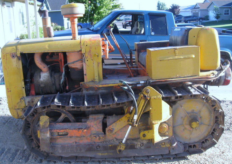

Tim, does the for sale crawler look like this one ?
The crawler pictured belongs to forum member Terry G from Idaho. It's a 1942 HD3, one of 28 made that year only. Basically it was a Detroit 2/71 motor in an Allis model M powertrain.

Yes, looks somewhat like that one, but tin work appears to be an older looking model on the unit I have seen; will have to get out there this week and take a pic ........
