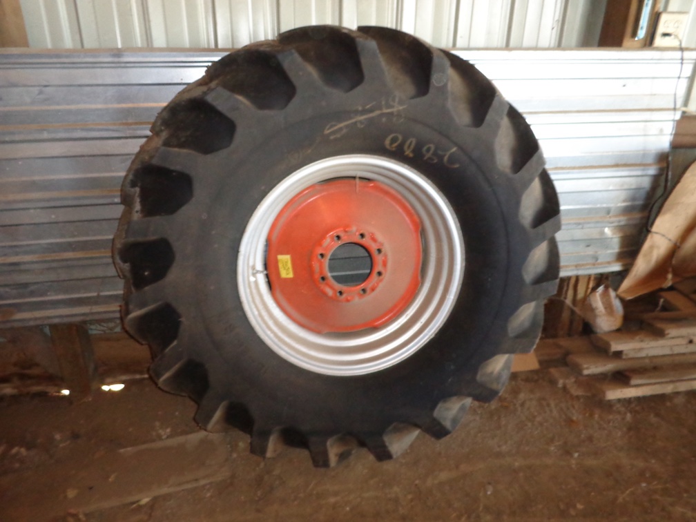

I bought a pair for my d17 as spares/backups. Never put them on (a friend returned a favor and surprised me w new rims/tires!)
Mine are for sale…..16.9 x 26 Goodyears in great shape/ no weathering. Located in Kansas City area.

Larry, I bought these at auction a few years back. They are 15X26, (18.4X26), think they are off an IH of some sort. Had them on three different WD's/45's, they fit fine though kind of wide and no provision for adding weight. They're old but in great shape and actually taller than my 16.9X28's.
If I were to build a dedicated tractor ride machine I'd probably use these.
