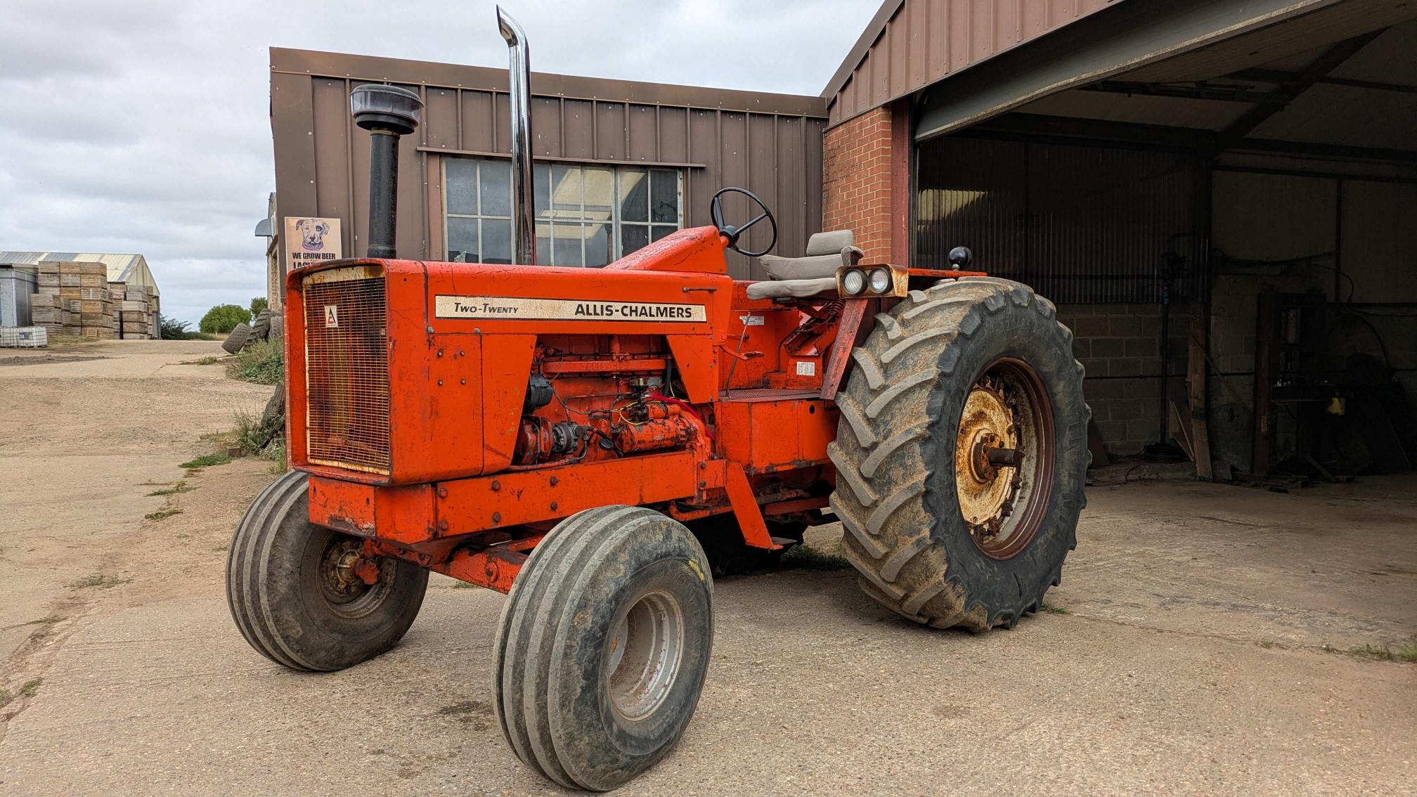

Hi there,
I am new here and looking for a bit of advice.
Became a 220 owner last summer in England, UK after bidding on it at auction. I have been told by the previous owner it is the only one in the country. This has meant parts are having to come from the US.
I have reconditioned the starter motor and have a ring gear on its way over from the States as they weren't always meshing and a bit chewed in places. I think it is best I do the clutch while split.
Is there anyone here that would be able to send a rebuilt clutch over? I think I saw Rick mentioned in a thread and warnings of the chinese reproductions. There is a clutch kit on Reliable Aftermarket Parts but it costs over $900 delivered.
Any help greatly appreciated. Thanks
Fred

  Only 220 in England??  Do you know the origin story??

Awesome, did it originally or aftermarket have a cab ?  Worth the investment to do it right.
