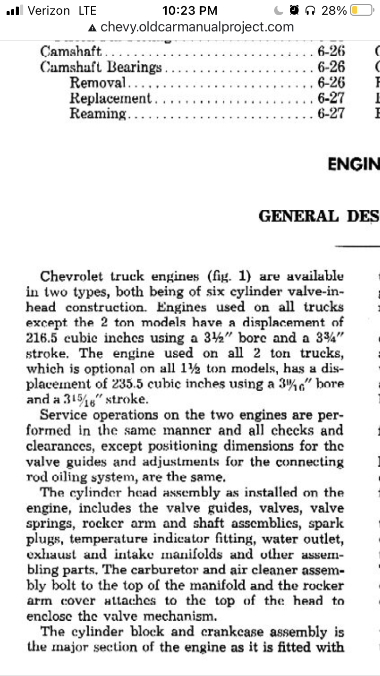

and your sure it's a 235?   it had to have been put in there; those came with the babbit bearing 216's.  we always had to cut out the radiator support about 2in to get the radiator to clear the fan when we changed them over.

Yessir it is a 235. And yes, you are right, it was put there. In 1951 at the General Motors Kansas City plant. Rod dipper 235s were used in big trucks several years before they were common in passenger cars and smaller pickups.
