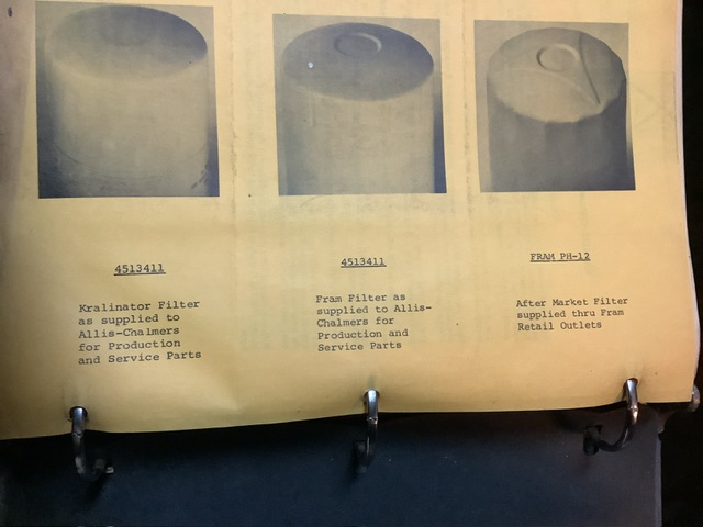

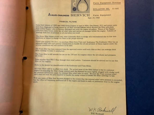

Post Options Post Options   Thanks (0) Thanks(0)   Quote Mikez Quote  Post ReplyReply Direct Link To This Post Posted: 22 hours 29 minutes ago at 7:43pm
Came across this service bulletin. Thought I’d share. Hope can read it.

Post Options Post Options   Thanks (0) Thanks(0)   Quote plummerscarin Quote  Post ReplyReply Direct Link To This Post Posted: 21 hours 55 minutes ago at 8:17pm
Interesting. So I'm to understand it's not necessarily Fram is bad but poor maintenance policy the Fram will fail first
Honestly the only thing that deters me from using Fram is no one carries them anywhere here
